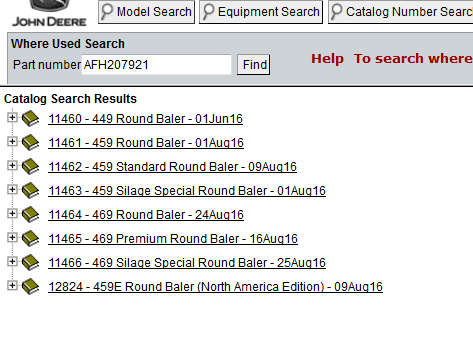

After yrs of selling/demonstrating/operating rd balers since the early 80'sn I can assure you it could just be circumstances or operator. I would like to know what roller & knife technician replaced. The only roller that really affects hay running up frt belts excluding the augers is starter roller plus the only roller I know of with an associated knife(scraper) is the starter roll which BTW is the same for all 459 models plus some 469's. Part # for starter roll is AFH207921. I emailed you my phone number so please call me & I'll try to assist you before you spend a lot of $$$$$$$$$$$
Jim,
I'm not sure, since I haven't taken it in. I've only talked to them on the phone. But, from what I can gather, it's the "auger style" roller (#5 in the picture) and the associated "knife." (8&14)
