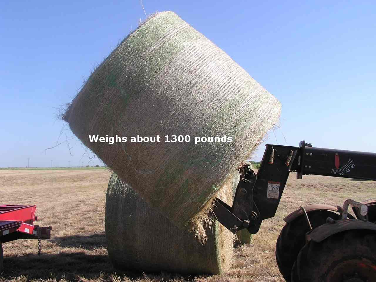

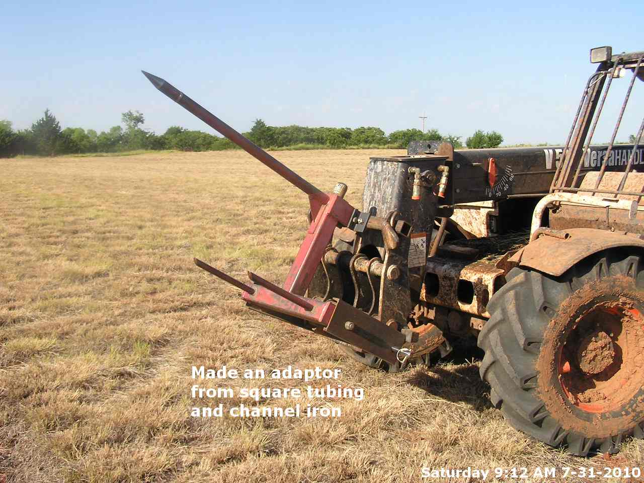

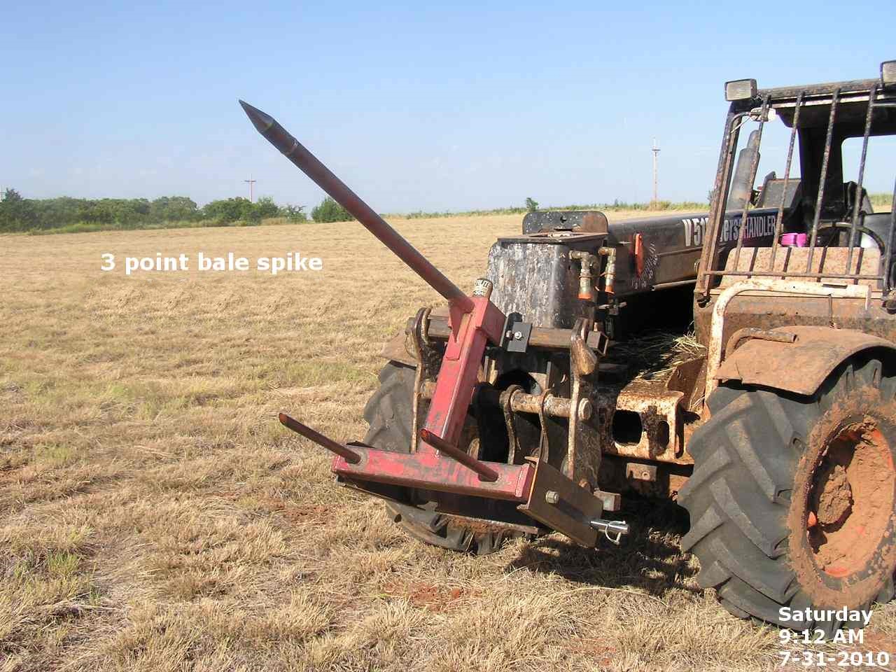

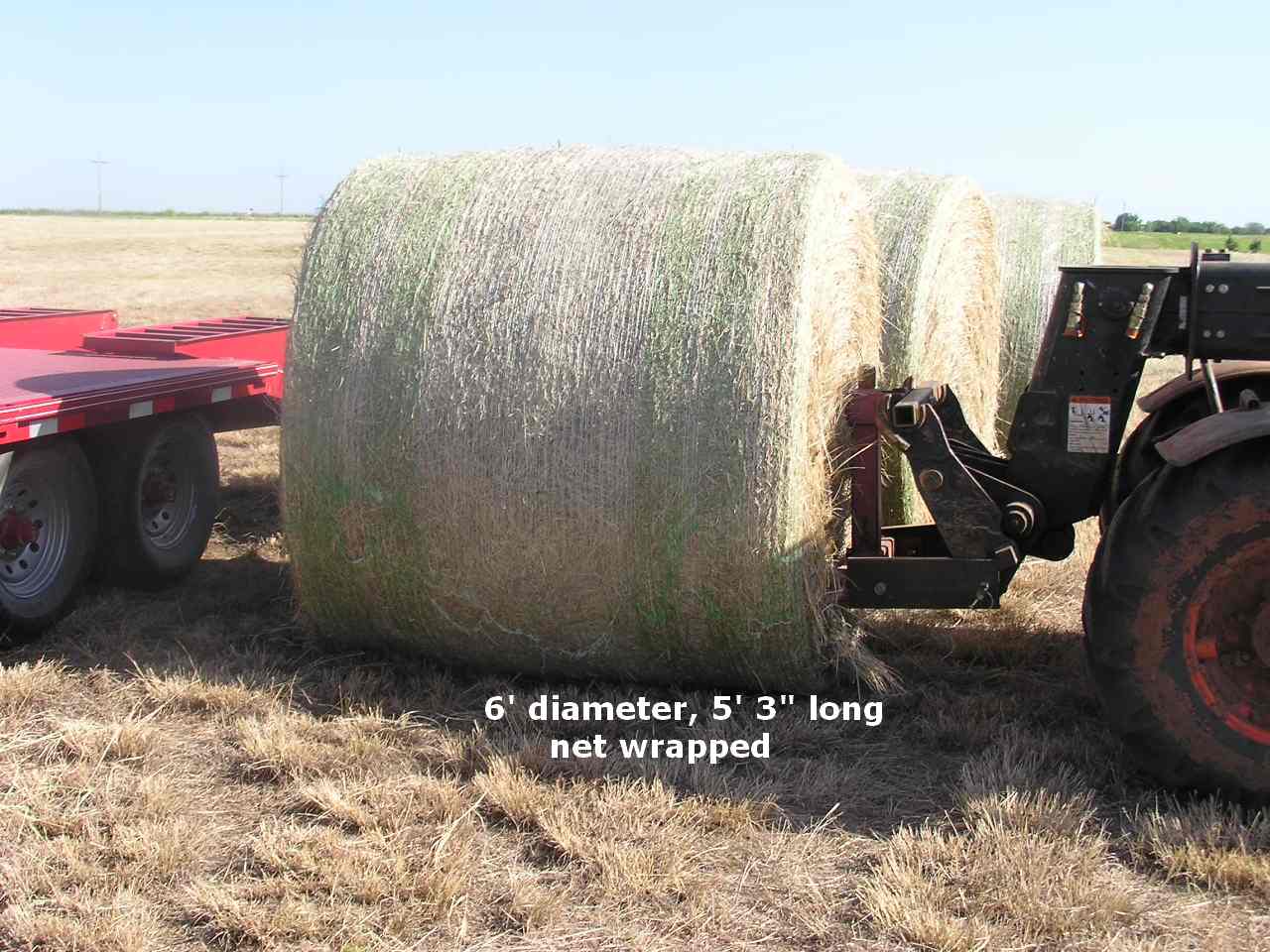

I prefer this style for the 5x6 rounds that we use. 20 years ago I bought it used for $75. :D
attachment.php
Also used it back when I had the V518. :thumbsup:

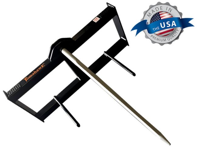

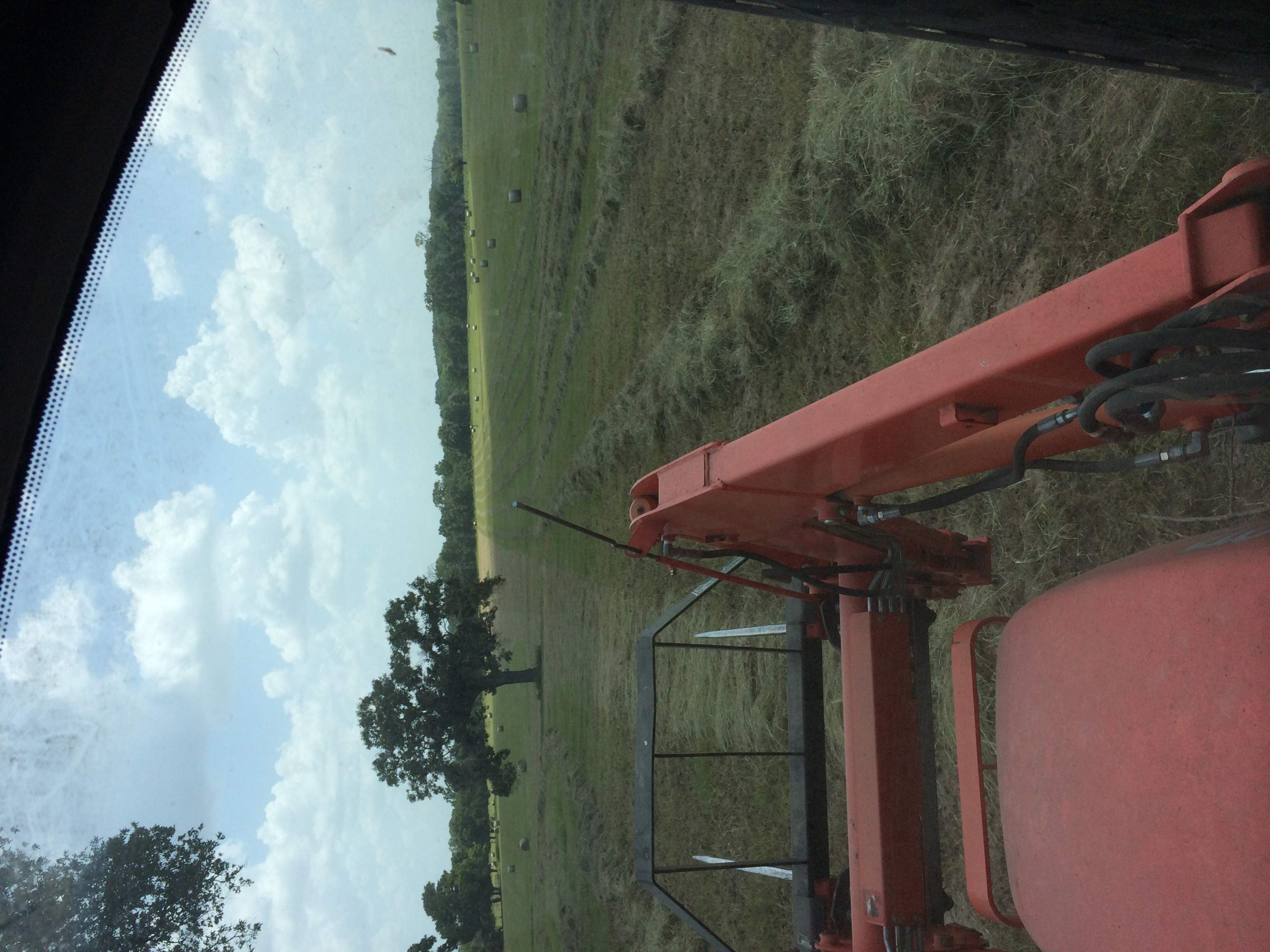

I have used my pallet forks before(when had one or two to load,didnt wont to change to spear) just set them as wide apart as they go and stick just the one side into the middle towards top some of the bale. I rarely use my pallet forks now that I have a double hay spear it gets used for both duties,even unload ton of feed on pallets with it.

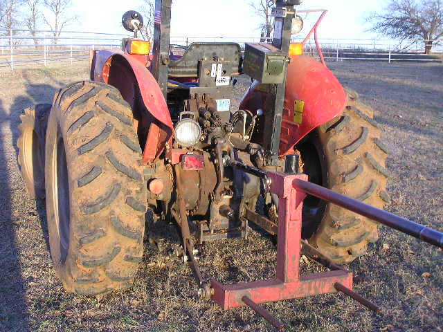

I have two single spears like in pic above and the double long spears get used for a lot more than just hay handling.
image.jpg Armstrong AG,sorry it's sideways sending from my Iphone
