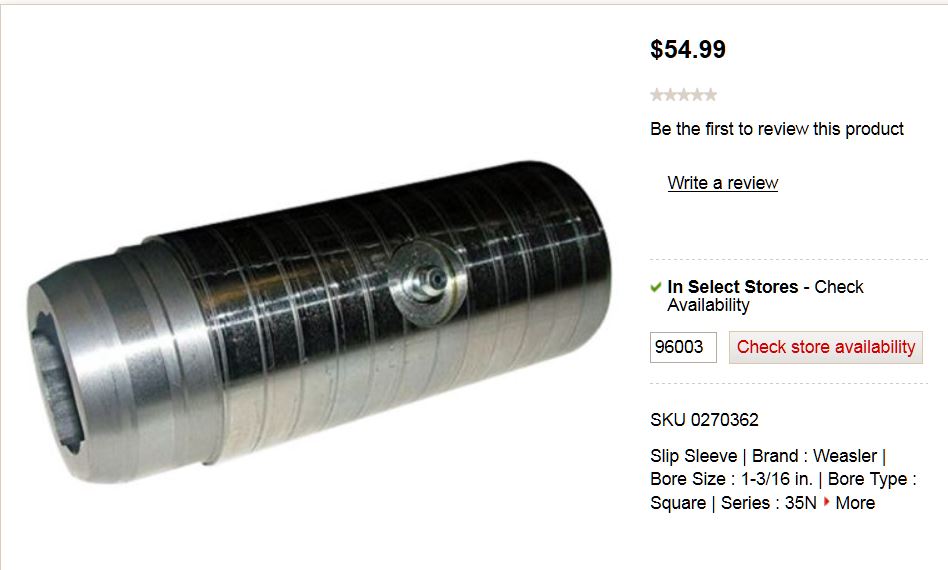

There's no problem to rebuilding a pto shaft. I cut & splice them from time to time. In fact I just repaired the female telescoping one for my JD 347 sq baler. The female sq part split(see photo for replacement part) from crossing a high driveway so I purchased the female part which is about 6"s long then found a piece of rd tubing the correct size,lengthened the overall length by 6 additional inches,slide male & female together so u-joints would be in phase then welded it together.
