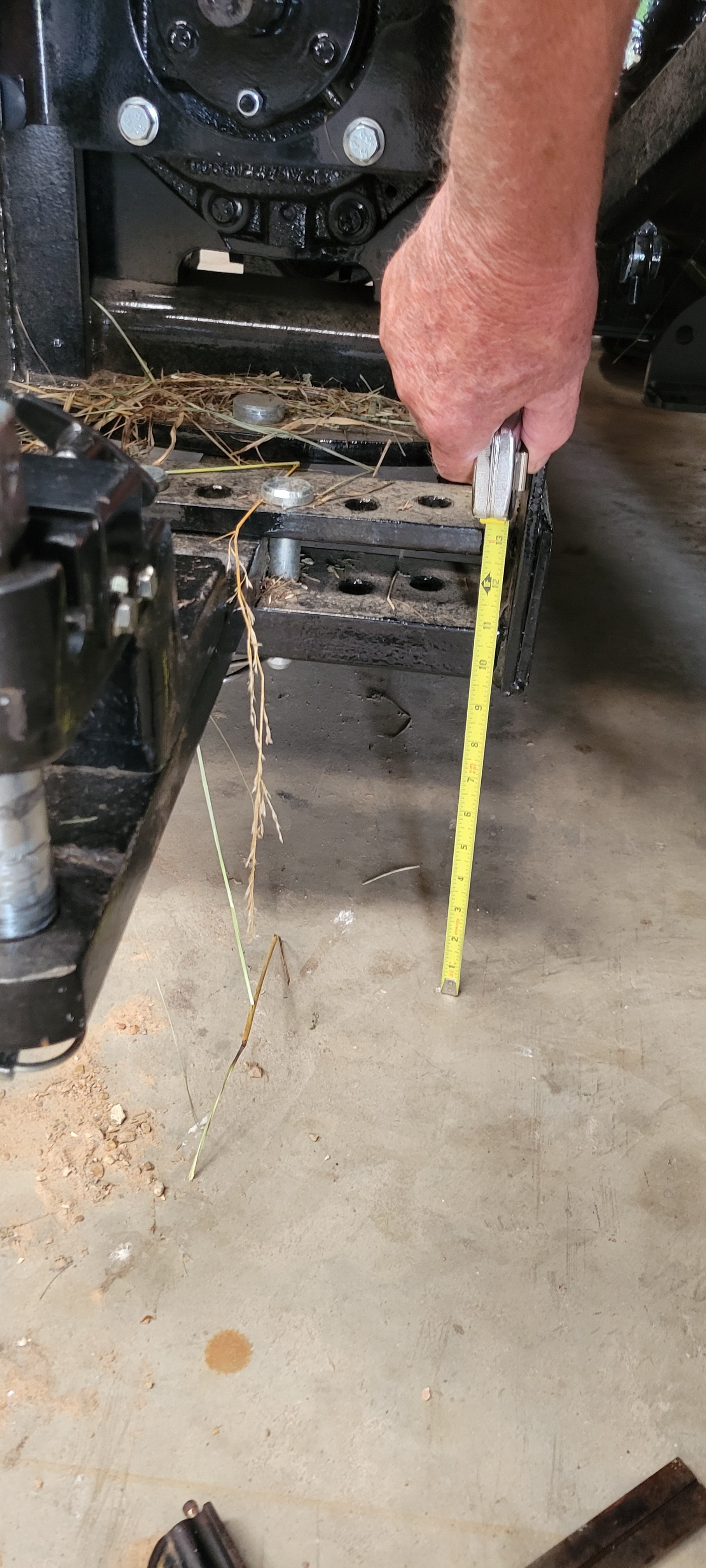

I just received my new Mahindra 5155 the other day and started using it to round bale on Friday. I noticed when hooking up the round baler to the drawbar that there is only 10" of clearance under the drawbar bracket. This lack of clearance became an issue while baling because the windrow was bunching up under the rear of the tractor causing feeding problems. I am a little disappointed in the fact that there is so little ground clearance. The specs on the tractor shows the clearance of 16" but other than the drawbar there a many other projections under the tractor that are less than 16" also. The tractor literature is a little misleading.
My question for all you seasoned hay farmers, what do you do when round baling to avoid the bunching up of hay due to low ground clearance. Do I need some sort of belly pan to press the hay down so it clears the drawbar.

One thing that might help you is when you rake your hay, don't use the full width of your rake and make smaller windrows, you will have to make more trips up and down the field but the windrows will be smaller/shorter.

That is really low.
For now, when you rake rows together, don’t “bunch” them together. Instead, make “twin twinkie” rows, so there’s a depression in between the rows, and keep your hitch running in the depression.
Long term, I’m not sure what the solution would be, but less than 16” is difficult to work with.

I have seen belly pans used for this application. A piece of corrugated sheet steel works reasonably well and is slippery.
That a great idea, I'll have to fabricate something like that

Consider removing it and using a lateral drawbar attached between the lower links. This will/may require a longer PTO shaft as well. Only other options are to single windrow, make a wider windrow when cutting and don't rake it. Maybe us a loader bucket to flatten the windrow as it comes in.

Bolt rubber to drawbar. Cut an inner tube or such. You might have other issues as well. With my tractor and large windrows the rear wheel can actually catch the windrow and start balling it up. Doesn't happen much but it does.

I always have that issue when bailing fluffy windriws that my Kuhn Masterdrive rotary rake makes which it inherently produces.
What I do is, I took a rubber 1/2 length truck muflap (not a white plastic one), but black rubber, and cut a rectangular hole near the top so it slips over the drawbar.
That way the mudflap 'flattens down the windrow' enough so the round bailer gets a nice even feed of hay. Been doing that for years now. The mudflap will slide back to where the hitch is hooked to the bailer and no more. When I'm not using the bailer, I stow the mudflap under the front cover where the net roll resides. Never had that issue with the old side delivery roper rake but I do with the rotary because of the always fluffy windrow it makes.

Tire size don't enter the equation for me at all. Because the mudflap 'grooms' the windrow before it gets in the bailer pickup. Never had that issue with the square bailer but always did with the round bailer. A 5 buck rubber mudflap cured that issue for me 100%. Tried the white plastic ones but the black rubber does a far superior job. Goner are the days of the hitch pin catching and wwadding up the hay. Feeds smooth with no fuss whatsoever. Never got the pickup wadded up either.

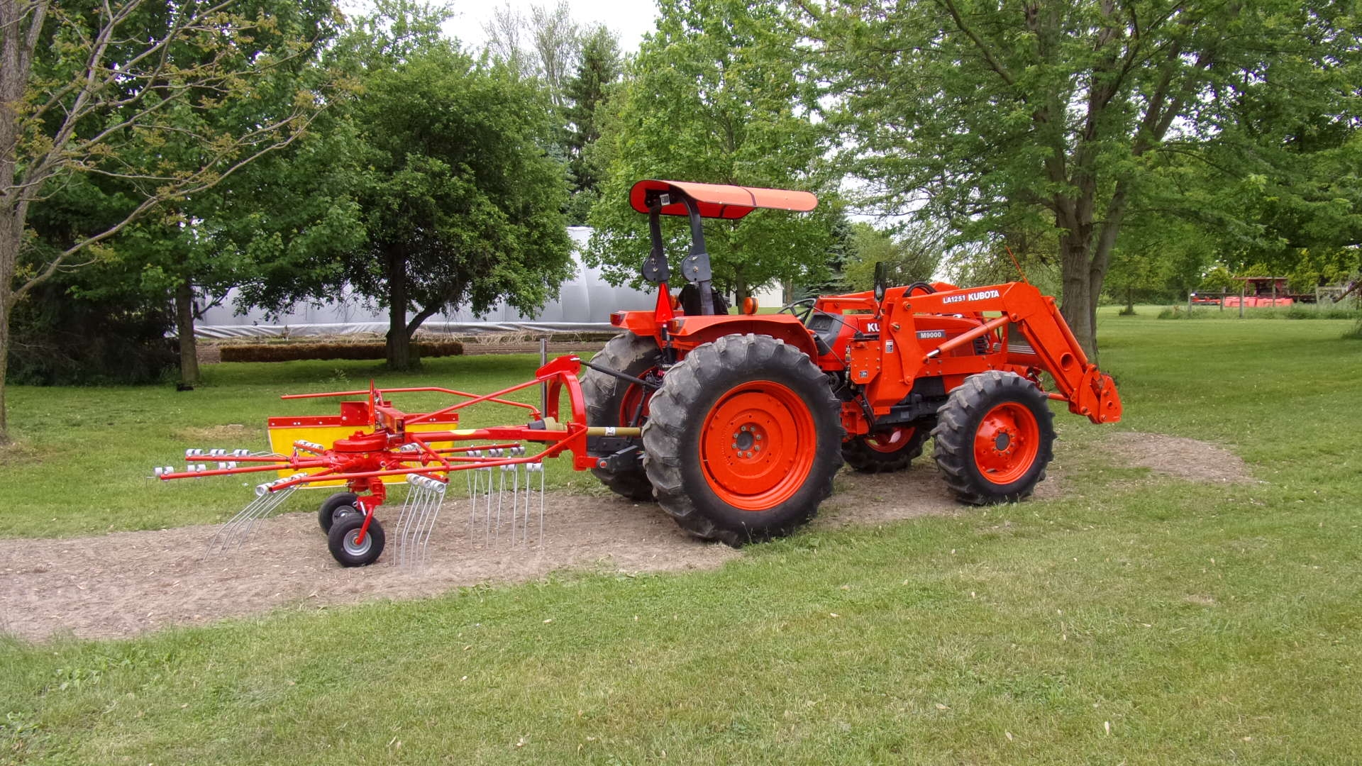

I will say from personal experience (5 years now) that a rotary rake beats a side delivery, hands down
Basically maintenance free as well, just keep the hypoid gearbox filled with gear oil and do tate I have not broken a time, even though I have spares.
The thing I like best however is, on my odd shaped fields, at the end of a windrow I can pick it up (mounts to the 3PH and swing around and start raking again with no 'curved' tail to chase with the bailer. For me, that is a huge plus as I don't like chasing windrow tails with the round bailer.
Best 6 grand I ever spent. I see JD also sells the Kuhn rake rebranded as a 'Pioneer', painted JD green, of course.... for you that bleed green of course.

They come in twin rotor as well as single but I bought the single and I'm quite happy with it. 5 years and no maintenance other that checking the gearbox oil and greasing the trailing wheels. No issues about parking it either because all the tine arms come off and tou can park it in a 4 foot wide space.
Almost bought a trailing wheel rake but I didn't. Buddy has one and I wasn't impressed with how much dry hay it left behind. The Kuhn leaves nothing behind and it's gentle on alfalfa as well.
I've even raked combined wheat straw with it and I can rake at any speed I can stay in the seat with. Never tried it on corn stalks but then I don't like bailing corn stalks anyway as they are dirty and hard on a round bailer. You bale corn stalks at at the end of the day, you, your tractor and everything else is a filthy mess.

Anyway, I recommend the black rubber mudflap on the drawbar. That will eliminate any issues you have with hay wadding up under the tractor or catching on the hitch pin.

I'll give the mud flap a try, sounds a lot easier than trying to fabricate a belly pan. I just finished baling 100 round bales and the hitch pin is catching the hay and balling it up. Your idea should solve that issue.

It does and it's a 5 buck fix. You can actually have your hitch pin quite proud of the drawbar, in fact I recommend it as the prodruding hitch pin causes the mudflap to stay down farther and 'groom' the windrow better. Once I did the mudflap deal, I quit looking back to see the forage balling up as it don't anymore.
