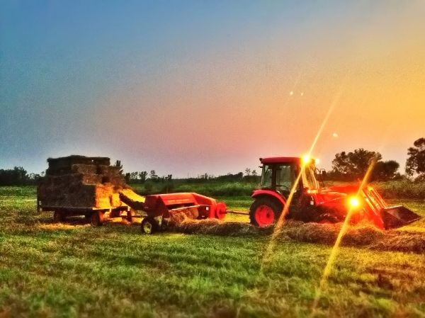

Well another 57 bales in the barn (second cutting) only problem I had this time was with the sickle mower balling up at the inside shoe. So I need to check my set up once again :)
   / Haying with compact tractor #74
That's some weird stacking! How in the heck do you keep much of a load on a wagon stacking them like that?? lol
SR
   / Haying with compact tractor #75
I can get around 100 bales on the wagon stacking it like that. They stay on pretty well.

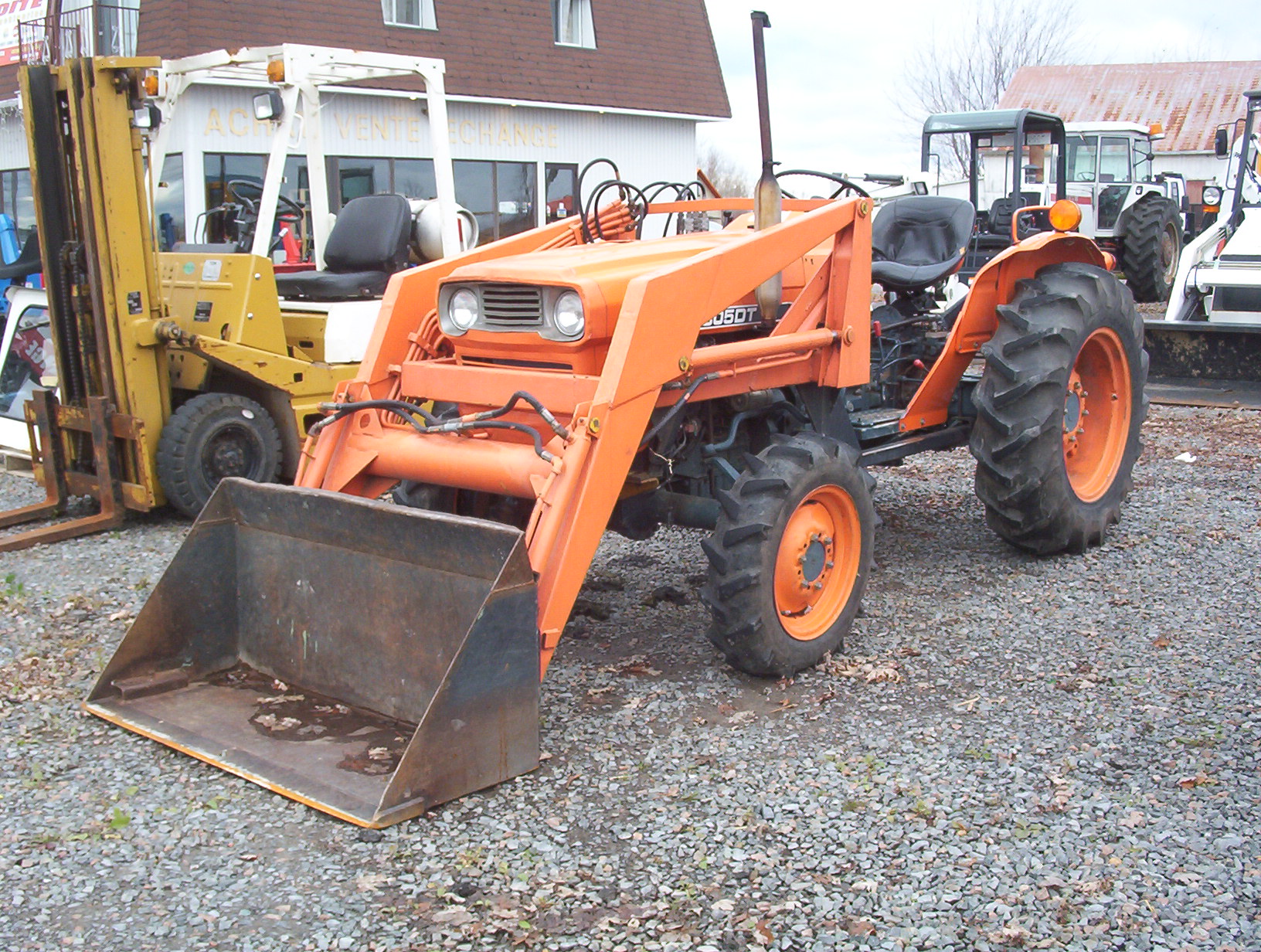

I put up a lot of hay using a Kubota L305DT. Worked the dog snot out of that tractor
google image
   / Haying with compact tractor #77
wish the M6800 had the high/low PTO selector. That old 305DT you could put the PTO in high range and run the engine down lower RPM and still maintain 540 pto speed. The M6800 engine has to run pretty fast to get 540 PTO speed which sucks when you're running a brush hog on light grass or a small tiller where you don't need much HP
   / Haying with compact tractor #78
Exactly. I have a 30yo B6100D with a 3-speed PTO and you can throttle down for light work, but my new L4600 only has 1 speed so you have to rev the crap out of the engine to get blade speed.
