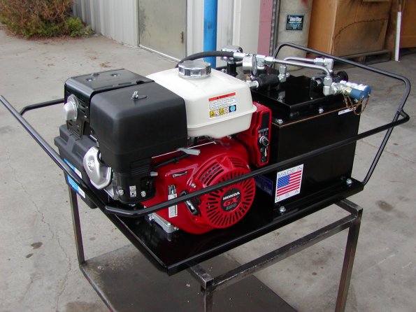

Having not seen it, I'm shooting in the dark here, but I would guess it's a small horizontal shaft engine (Briggs or Honda) with a hydraulic pump mounted to it, and lines leading to a reservoir. Somewhere there has to be a remote mounted for the hydraulic lines.
civesnedfield can you post some pics?
Thanks!
Thanks!
The power unit is similar to the one shown.
attachment.php
