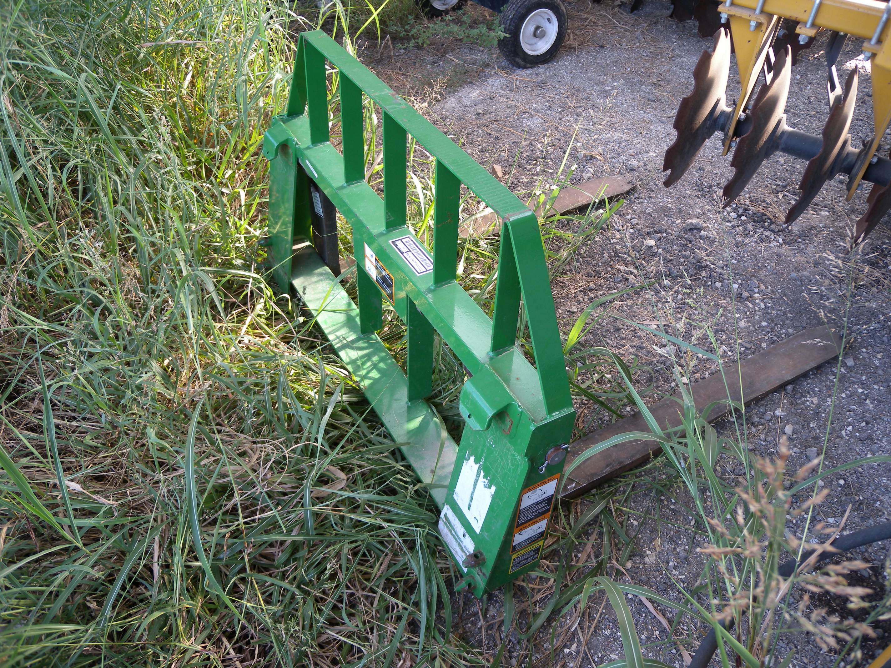

I purchased a used Hay Tech grapple. It is setup for a JD 6xx loader. I want to have it work on either my John Deere 400x or 542 loaders.
I know I wil need to cut tall that stuff off and figure out a mount for my stuff.
I do not want to convert my stuff to skid steer - too many implements.
I have a set of Frontier forks that work on both loaders. I want the same setup on this grapple.
I wonder if somebody sells a weld on plate of some kind that i could just weld to the grapple frame and be in business.
Ideas?
Thanks,
D.

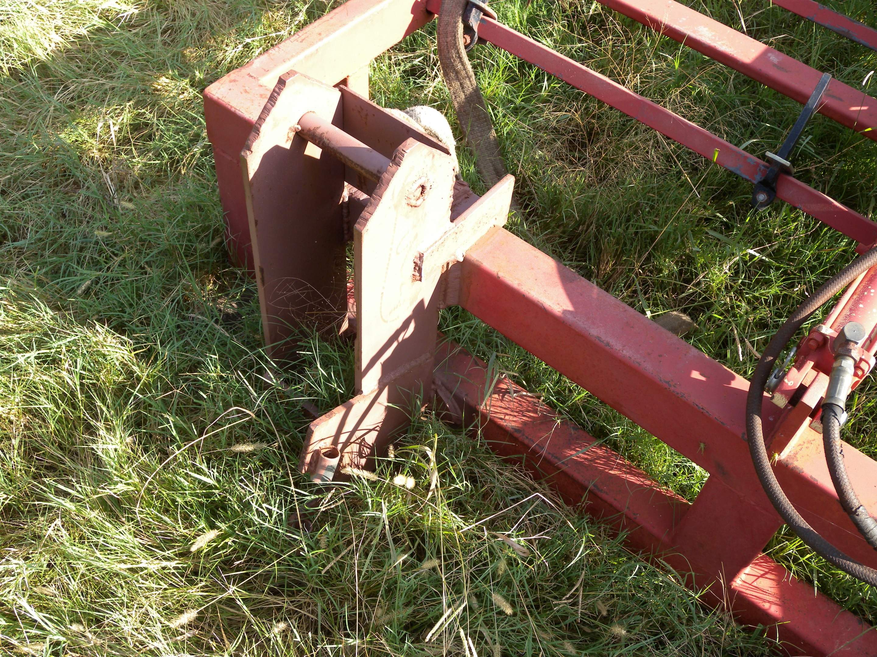

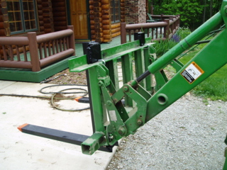

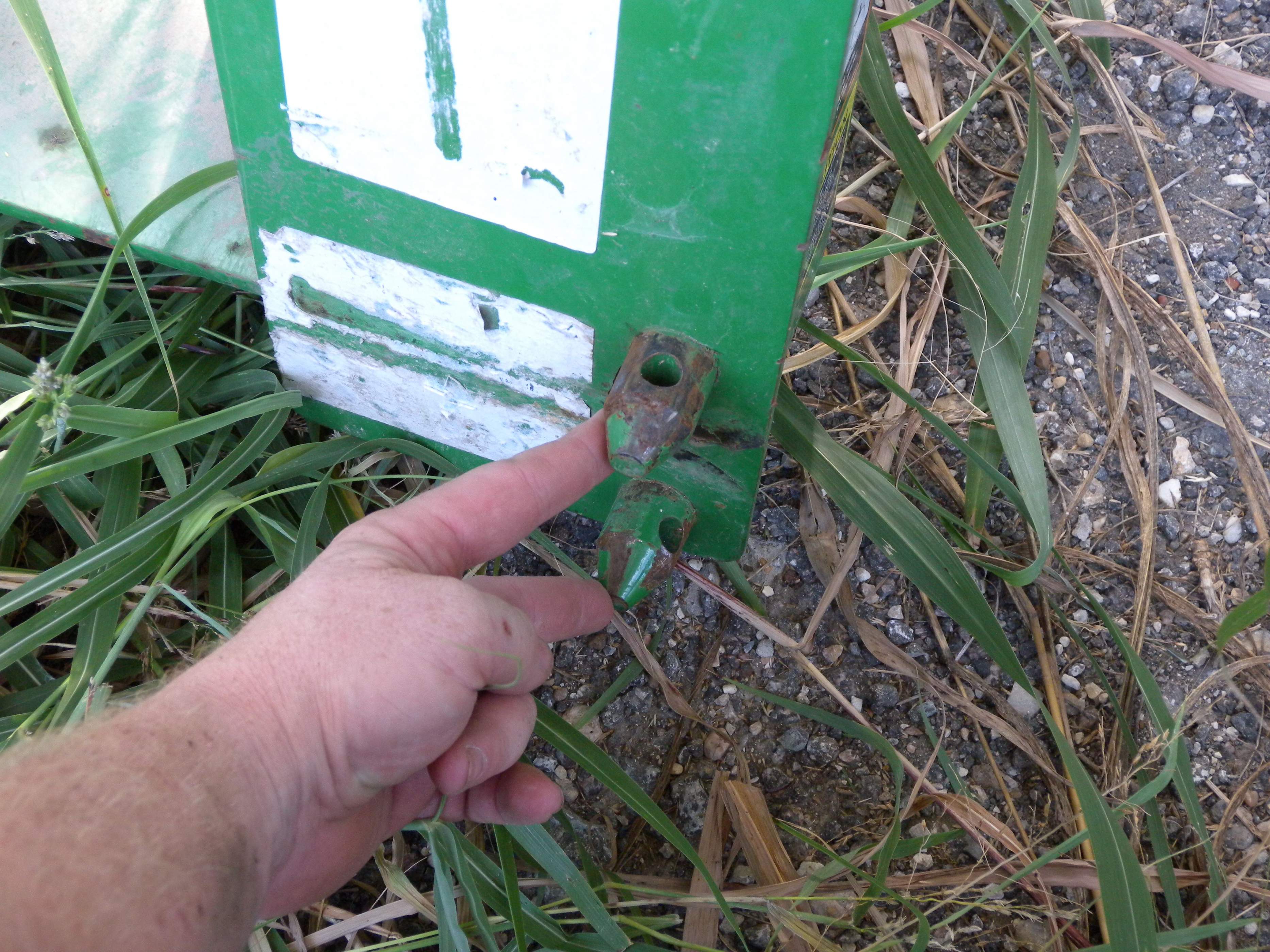

Darin,
You can buy the hooks and pins from JD for little money if you want to make your own. Or you can even make your own with some CAT3 pins and some angle iron.
   / Haytech Grapple - need to adapt to my JD 40)X and JD 542
Darin,
That is cool - that would be the easiest. any idea about part numbers or where to look on jdparts.com?

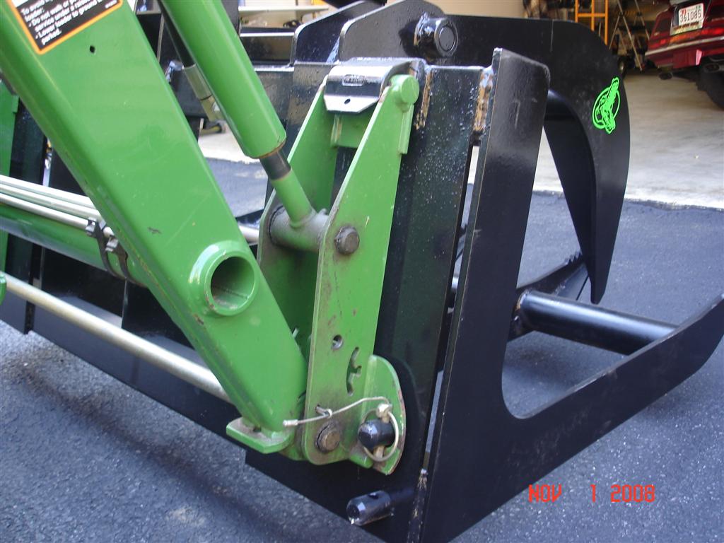

Welcome. One more picture, it's of my Markham grapple. They weld the hooks and pins to a 3/8" plate.
Exactly what I need to do to this hay grapple.
