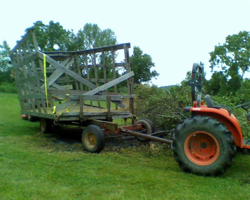

So, a few months back I found a haywagon frame that my FIL bought. The rack on it was "well worn" to say the least, but the running gear looked decent (made by Electric Wheel, nothing wose than surface rust on it).
We bought it and used it when cutting one of our fields (we had more hay than one wagon would fit) and when we finished with that, I pulled the rack off

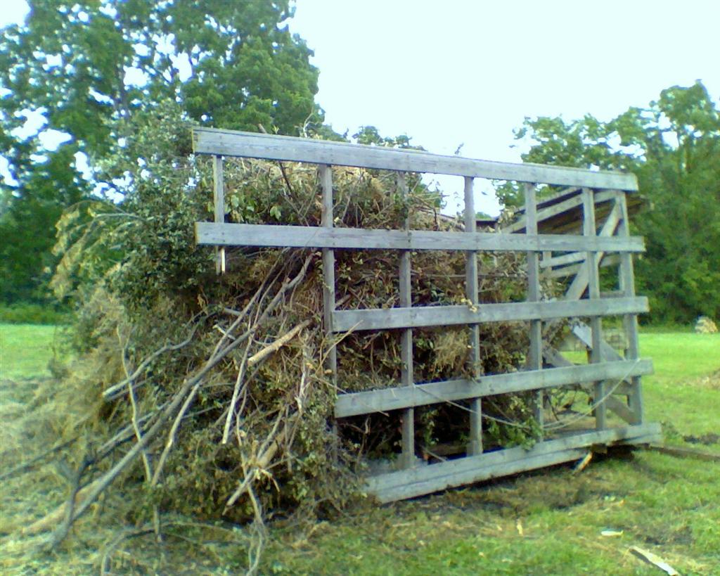

Stuffed it with the brush that we had gathered

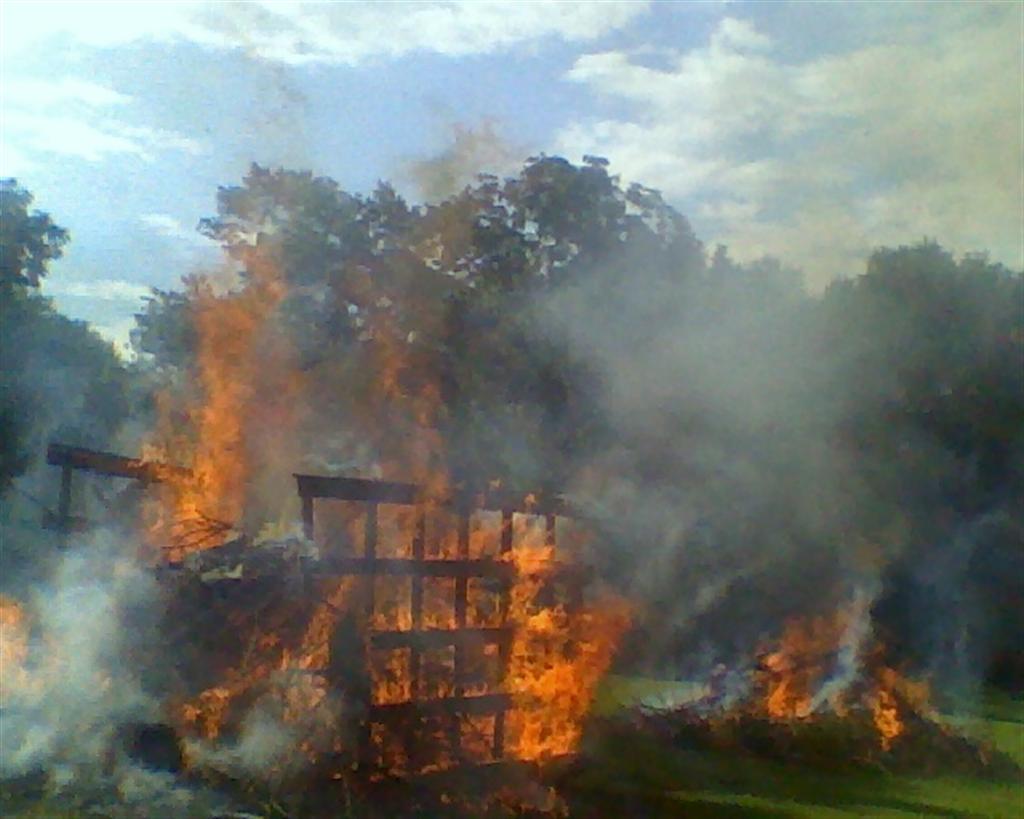

And lit it on fire

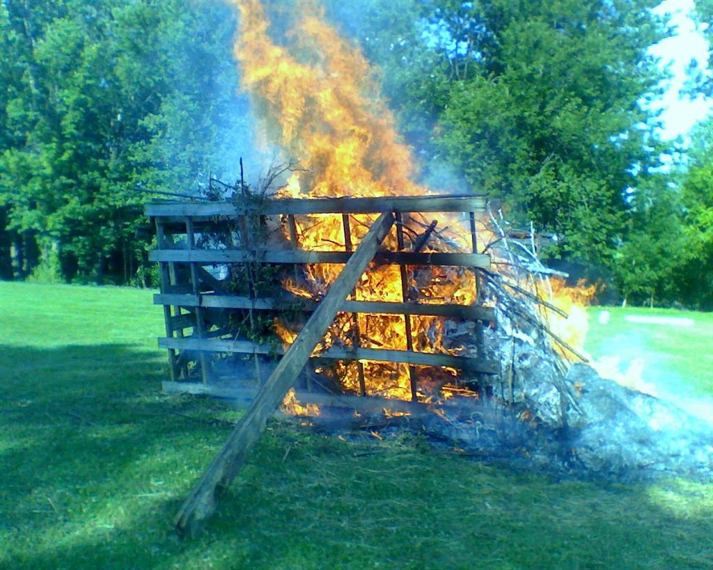

It burned quite well, as did then smaller brushpile that we burned at the same time

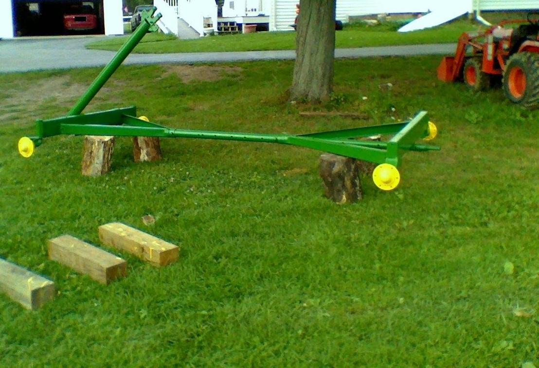

That was back in mid July, between now and then I have been getting the brackets that hold the frame to the running gear replaced (3/4 of them were made of 1/8" steel and had been welded several times, the new ones were made from 1/4" steel and had better not split.

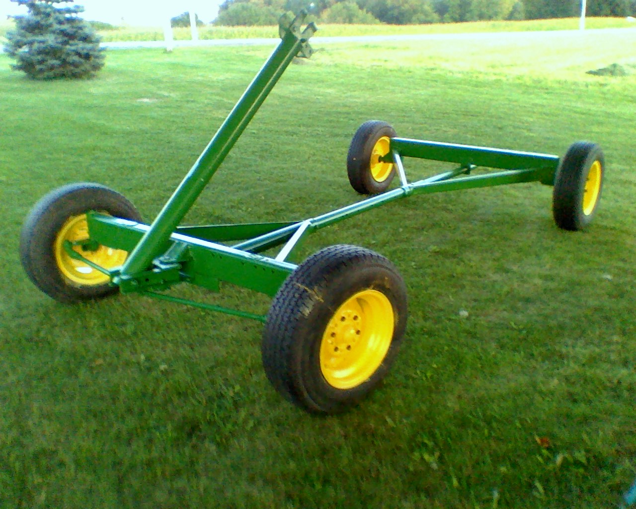

Last week my brother started painting the running gear and got most of it done (he did not do the front beam which needed to be welded first as it had some holes rusted into it where the frame had been sitting on the running gear).
This morning we had a friend over with his Miller 180 (we need to get a welder), he welded in a 1x2 piece on the one side of the front beam (rusted through) and his son practiced his stringers on the other side of the beam (not rusted through, but pitted). After they left, I repacked the bearings on the wheels (side note, has anyone seen great that looked and felt like caramel? That is what the grease that was in there looked/felt like) and cleaned up the rims with a wire wheel in my angle grinder.
I then painted the wheels and hubs JD Yellow and the front beam JD green. So far, it looks good to me. Here is a picture of how the running gear looks so far:

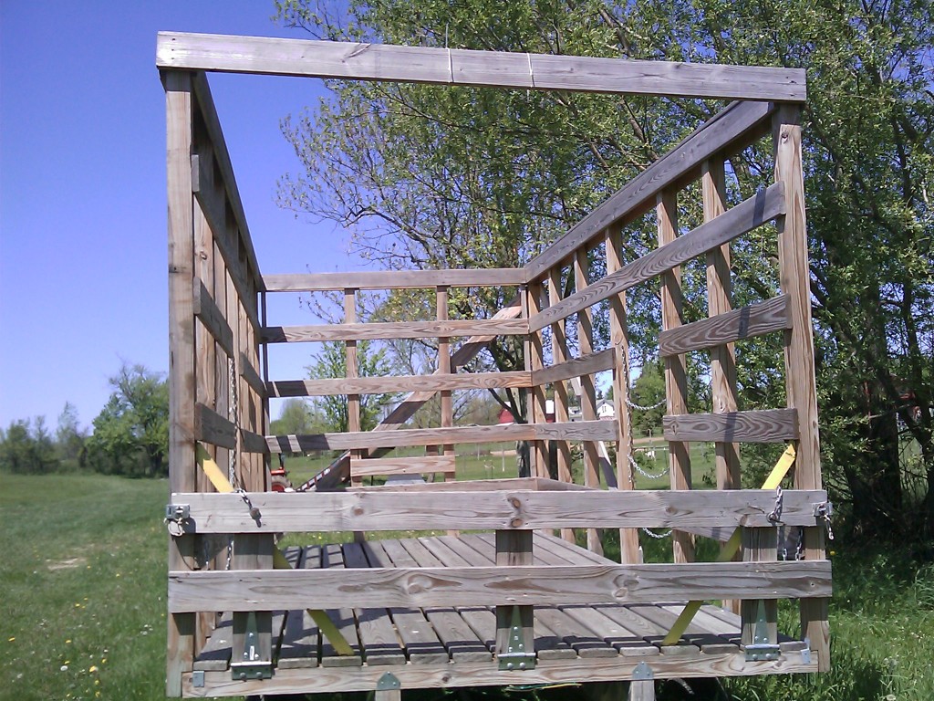

First off, sorry about the picture size, my brother took the pictures on his fancy schmancy phone and they are too small to show much detail.
I started on the rack yesterday. We had a friend who is a carpenter come over. He and I started building at about 8:30am.
First I found that he had ordered 4x6s for the runners, I didnt think they would be strong enough, so we called the lumberyard and they didnt have 4x8s, but they had 9.5x1.5 laminated beams. We ordered four 16 foot ones and they delivered two 16 foot ones and two 18 foot ones for the price of four 16 footers (they ran out of 16 footers)
Then he screwed the pairs of laminated beams together while I went back to the lumberyard to get a few other things we had missed (like flashing)
When I got back we installed the flashing over the runners (so that when the hay falls down it will not rot the beams) and bolted them to the frame
And installed the "strong tie" brackets
Once they were installed we installed the 4x4 joists
And I started on the deck boards while he started notching the 4x4 uprights
I finished screwing down the deck boards
And we started installing the uprights (details on how we fastened them to follow once they are fully fastened, they are currently a work in progress)
Then we started installing the side boards
However we ran out of screws before we finished, being as it was 3pm, we called it a day and I will work more on it later in the week.
More pictures and details to follow
To be completed:
Connecting uprights to the joists in a more secure fashion
Finishing boxing the top of the walls
Front gate
Chains on the side doors
Steps for the side doors (this will be fun)
Finishing installing the boards in the back
Straightening the upright that got screwed in on the wrong side of the mark (a 4" oops)
Spring assist lift for the tongue?
Replacing the nails in the "strong tie" brackets with 1.5" deck screws
Painting the runners JD green
Staining the rest of the wagon (probably next year when the wood has dried) with an opaque stain
If there are any questions/suggestions feel free to make them known

Some finished pictures at long last:
IMAG0493 (Custom).jpg IMAG0494 (Custom).jpg IMAG0495 (Custom).jpg IMAG0498 (Custom).jpg
Clearance from the tires, thinking of notching the beam a little to make it ride ~6" lower, but that hasn't happened yet:

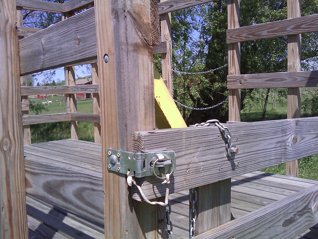

Drop down gate on the front and front braces:
Safety chains go through the tongue, then are independently bolted around the axle (this is the wagon that we use for hayrides):
