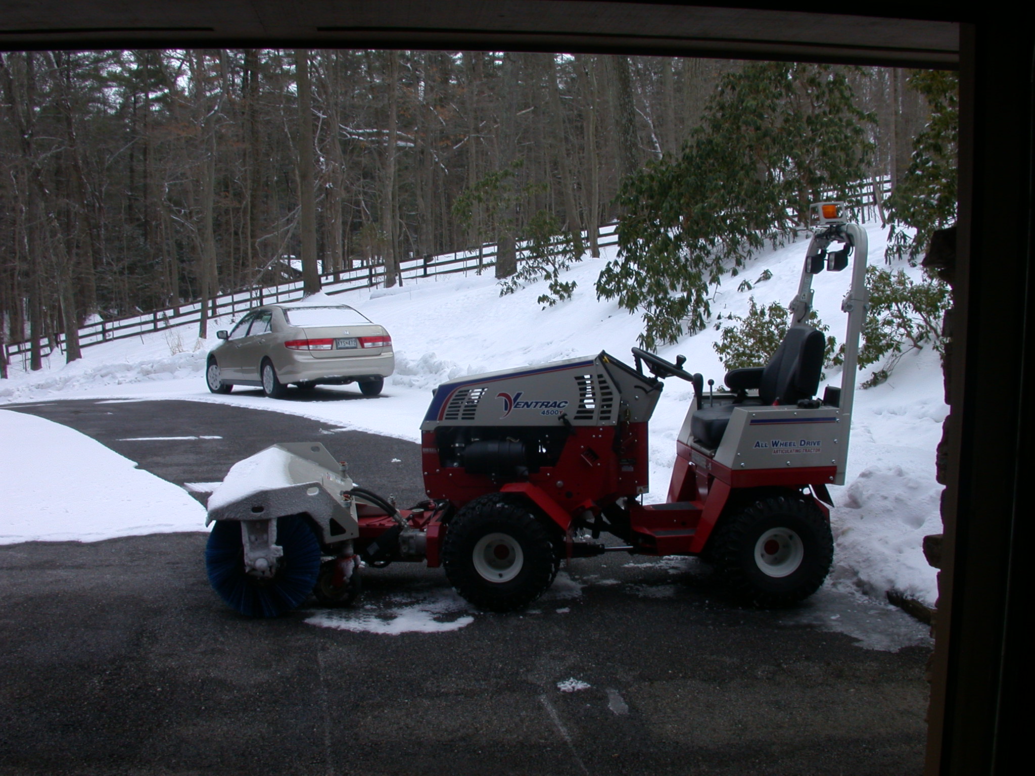

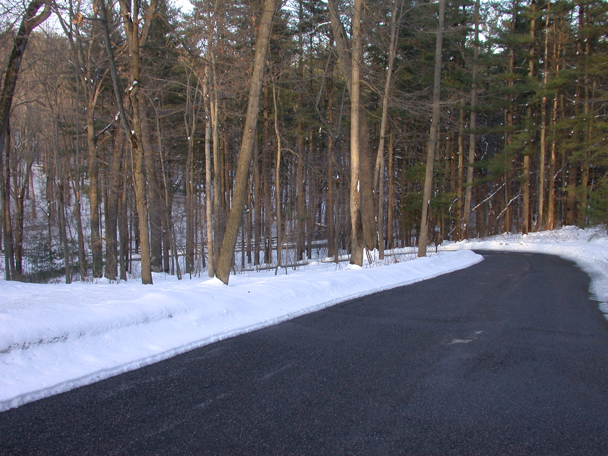

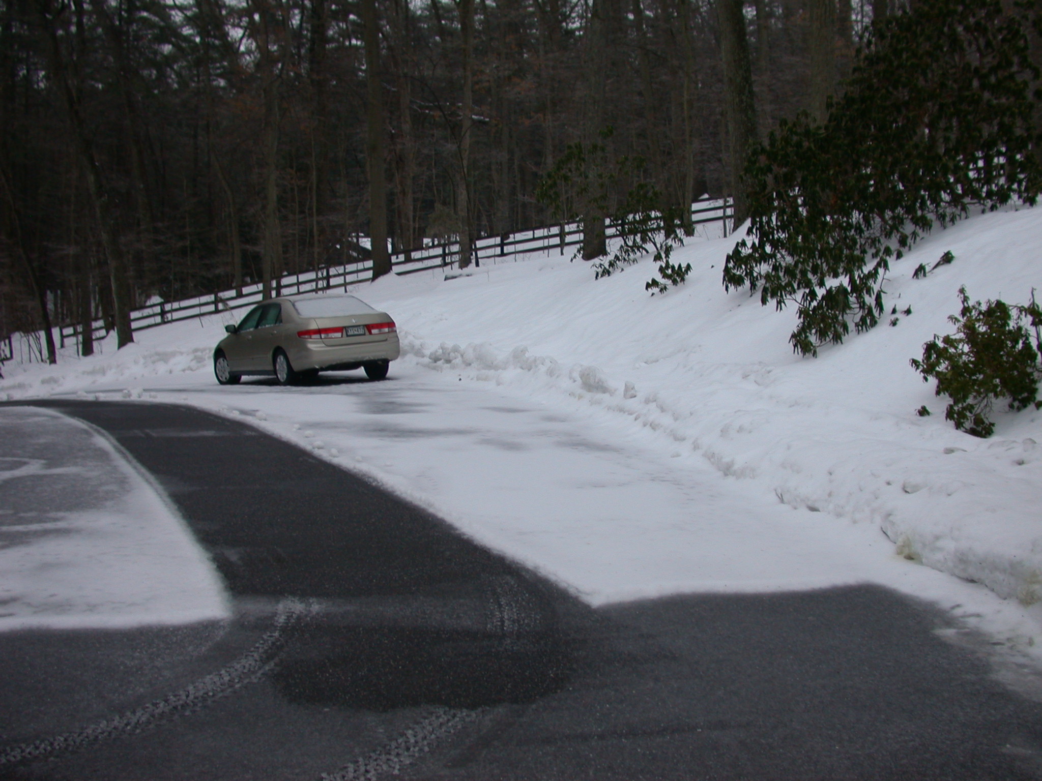

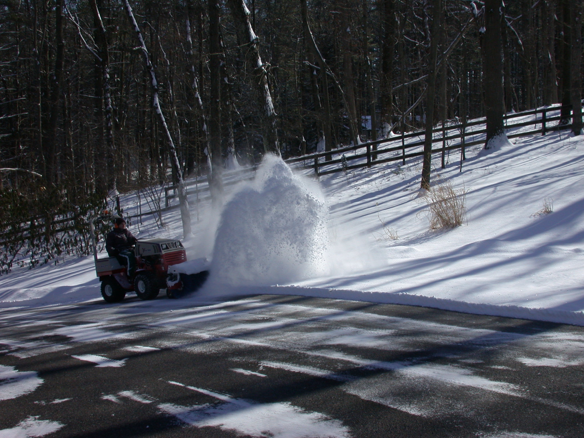

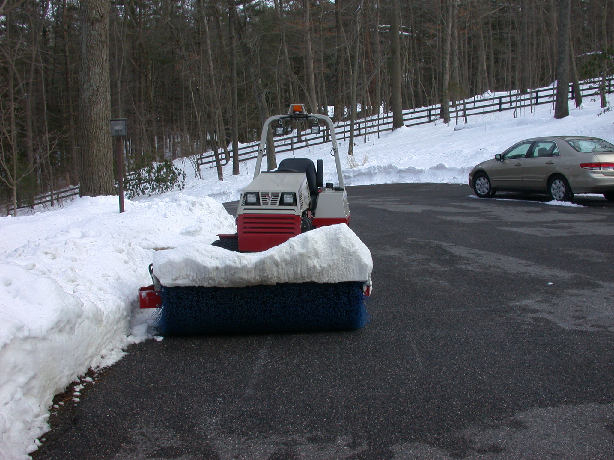

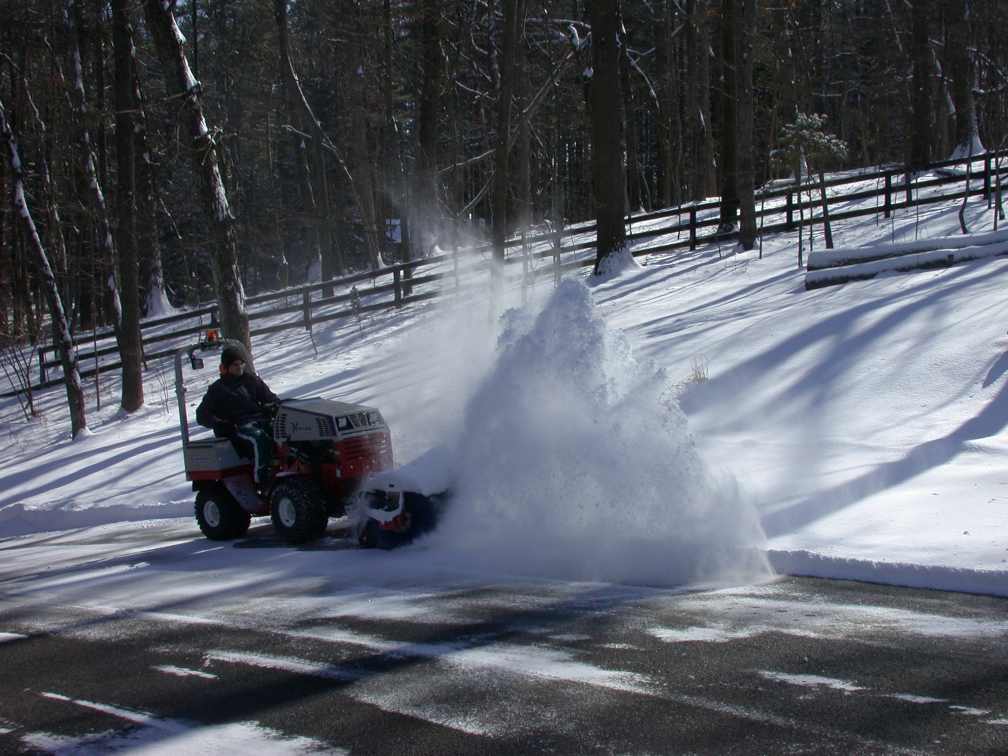

When I purchased my Ventrac 4500Y in December of last year, I also purchased an HB580 Broom and a KX523 Snow Blower. We had a good bit of snow this past Winter, and I ended up using the HB580 Broom substantially more often than I used the KX523. The HB580 Broom is useful for snow depths up to 4 to six inches.
I was very pleased with the performance of the HB580 Broom.
Our resident guru JackIL has explained the workings of the Broom.
I have not yet used the HB580 Broom to deal with leaves, but that time is coming.
Here are some pictures from this past Winter...
The Broom also very effectively deals with slush.
