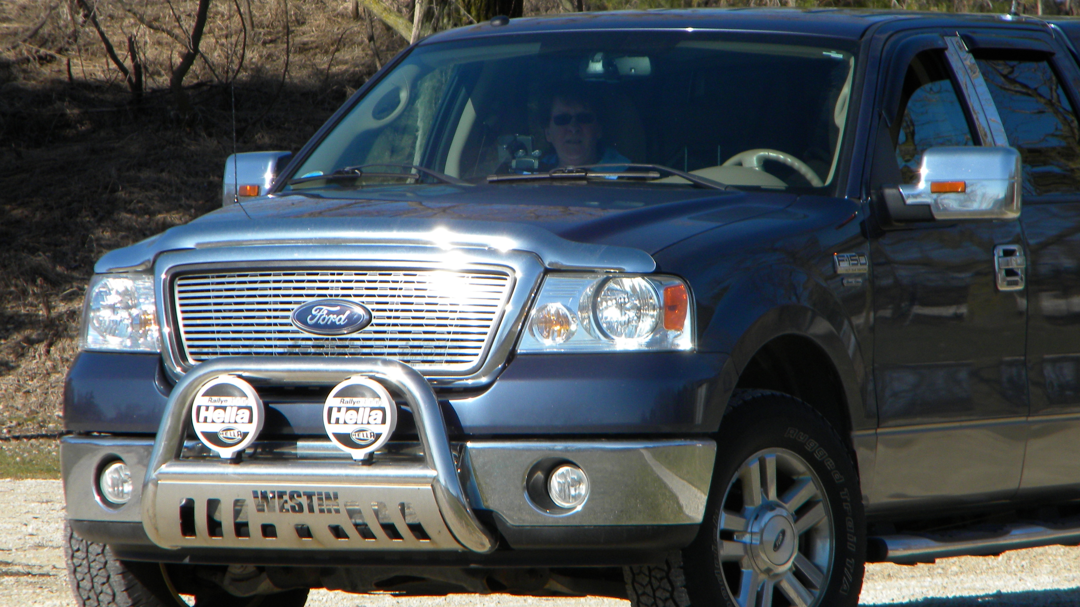

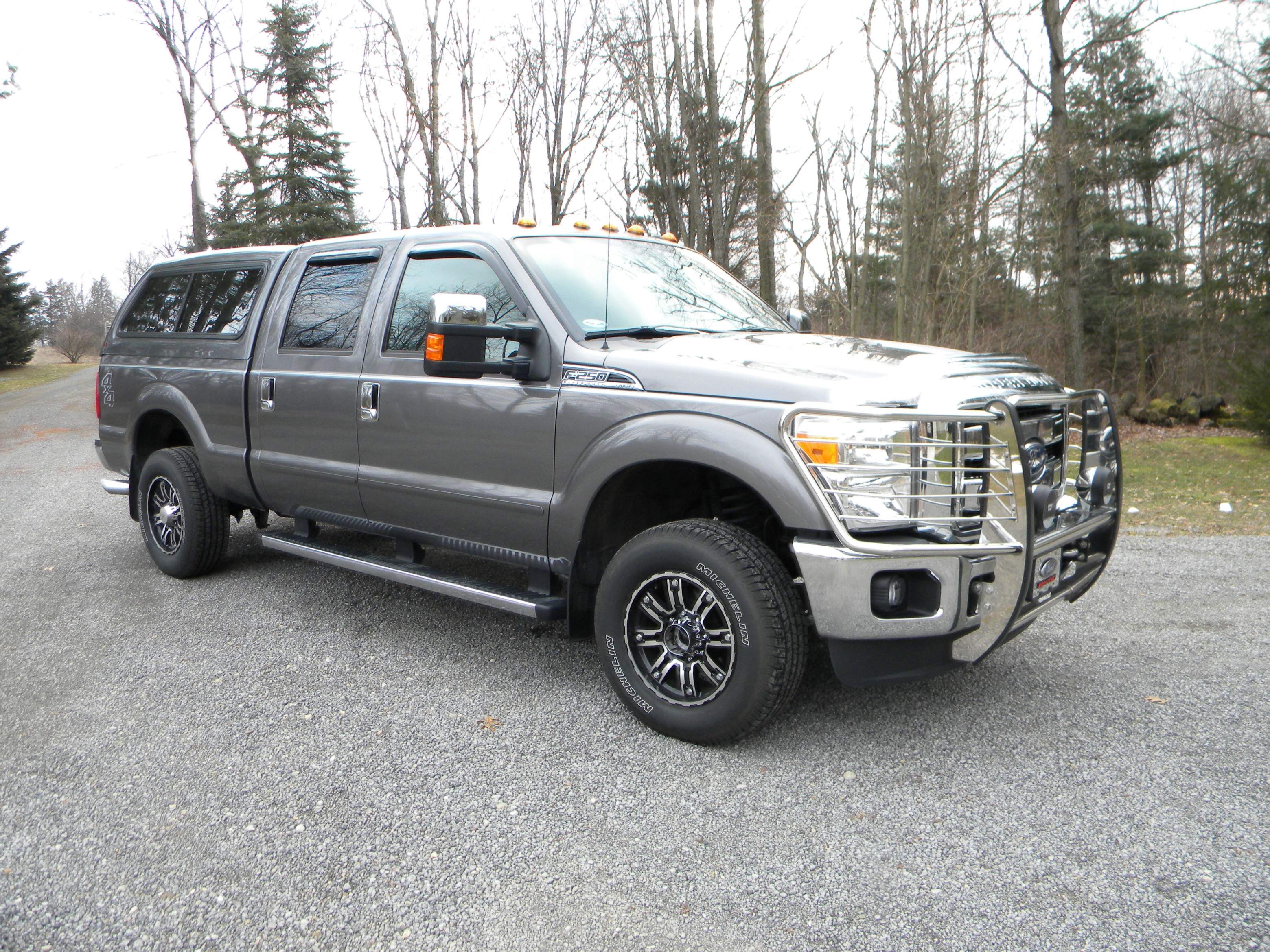

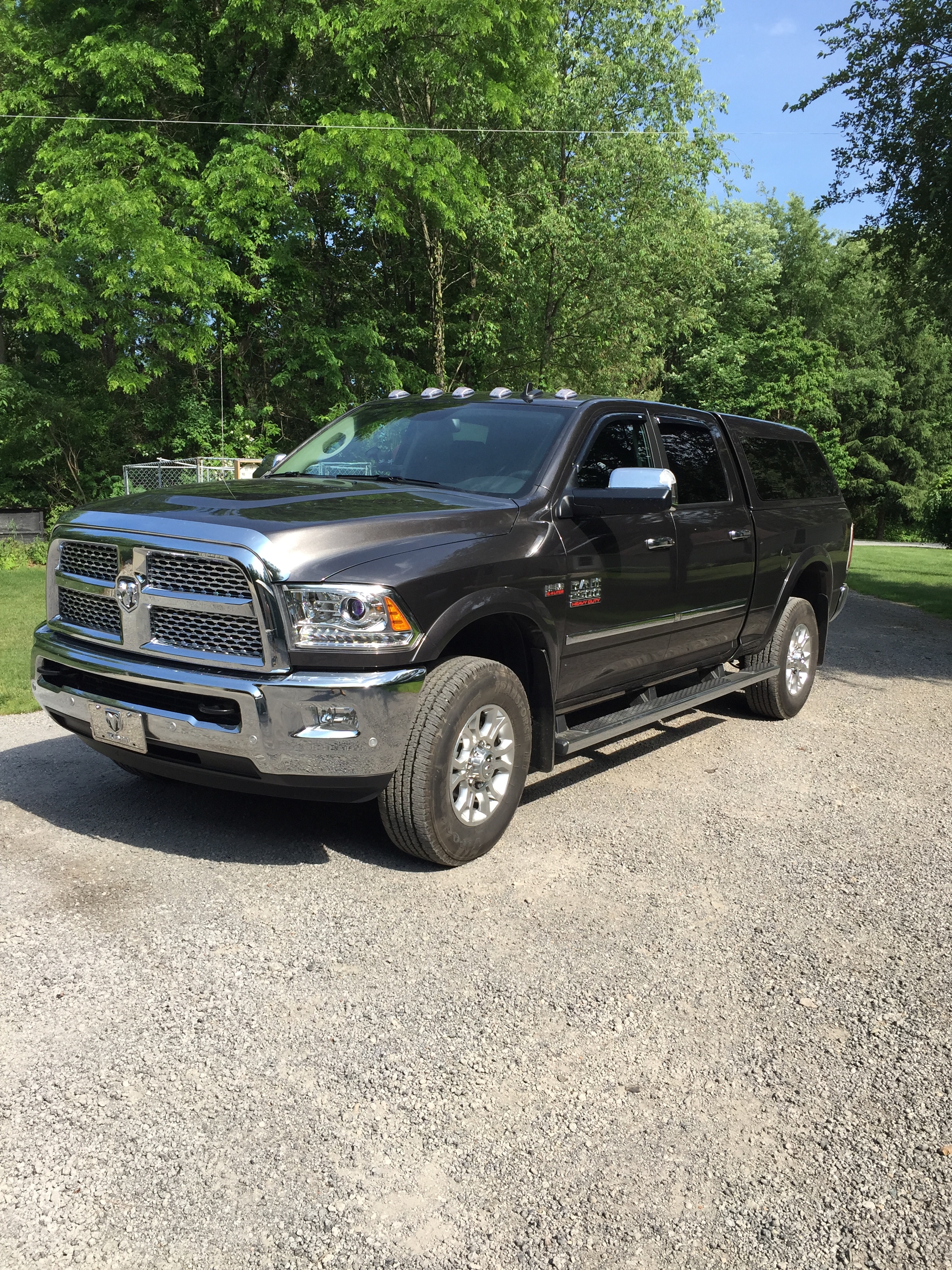

IMHO the Ford EB will NOT pull like a diesel engine "period".Not even in the same league.I have owned a 2004 dodge ram 2500 with 5.9 cummins diesel,2011 ford F250 super crew 6.2 gas engine,2006 ford F150 super crew 5.4 triton engine and now 2016 Ram with 6.4 hemi gas engine.From my experience with pulling with all of these trucks Appx loads of 12,000-13,000 lbs the 2004 dodge 5.9 cummins pulled better hands down winner.
