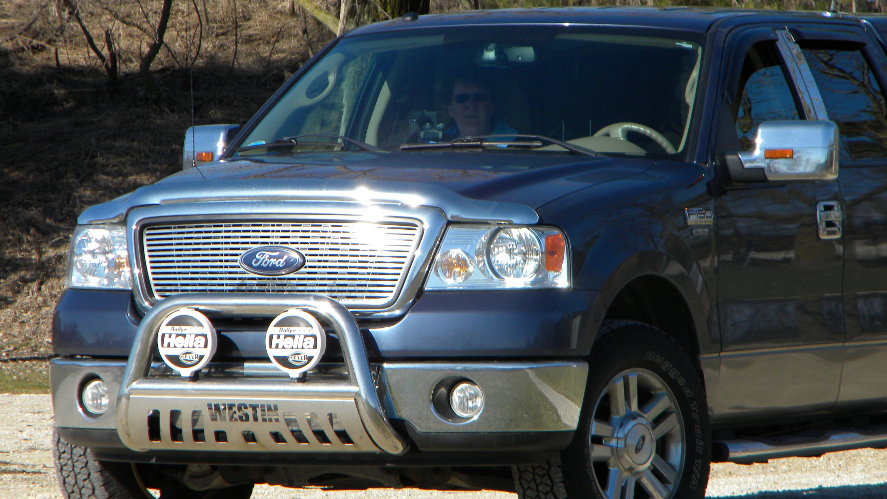

We ordered the the Laramie package.I tow my tractor with brush hog front end loader/loaded tires and 20 ft PJ trailer with my 6.4 hemi.It pulls great on hills and flat roads of Michigan.If I lived out west in the mountains I might opt for a diesel engine.For my needs the gasser fits me well verses the $9,000 diesel option.Just to be clear I am not a ford hater I also own a 2006 ford F-150 super crew with the 5.4 triton motor
