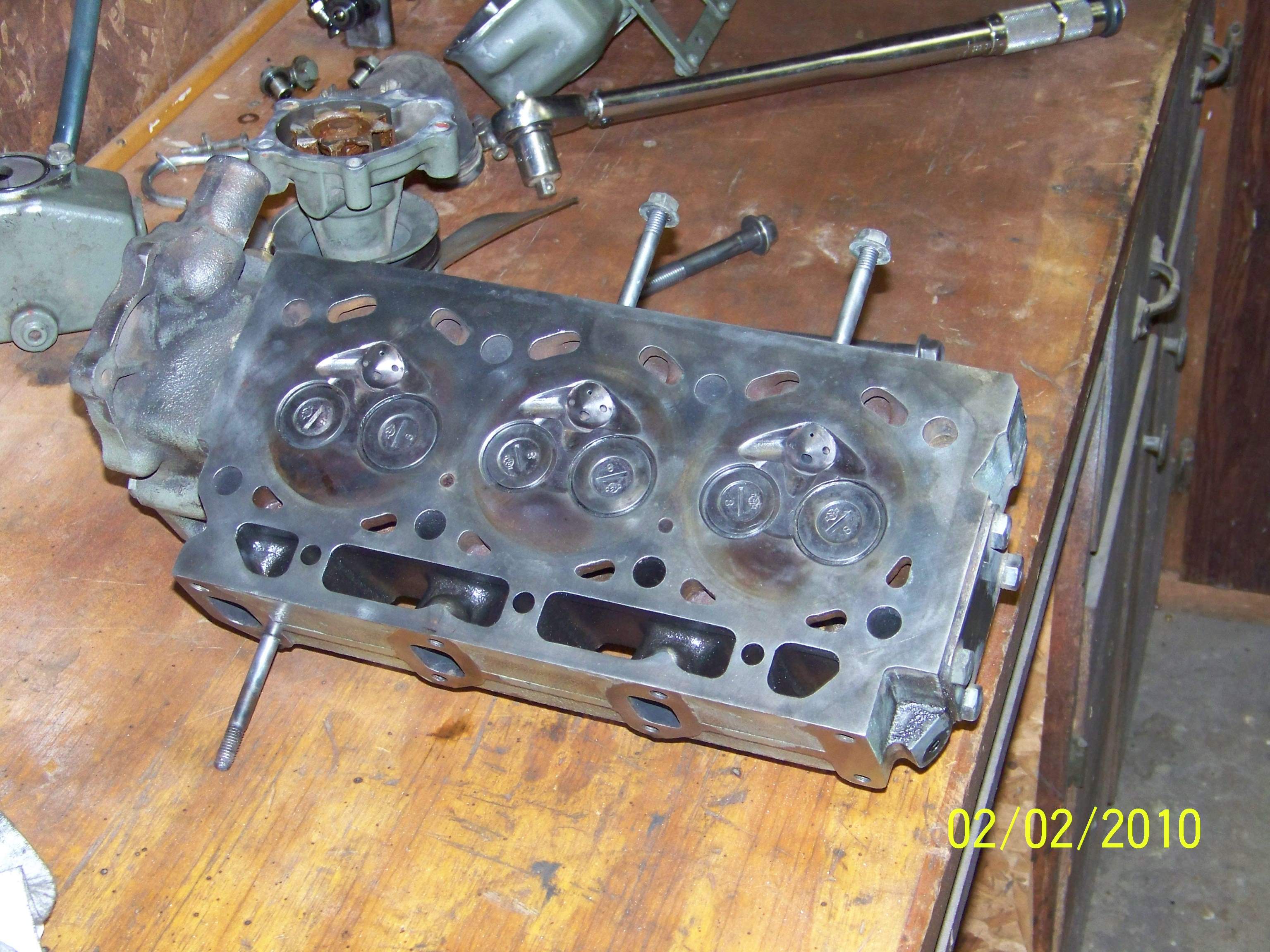

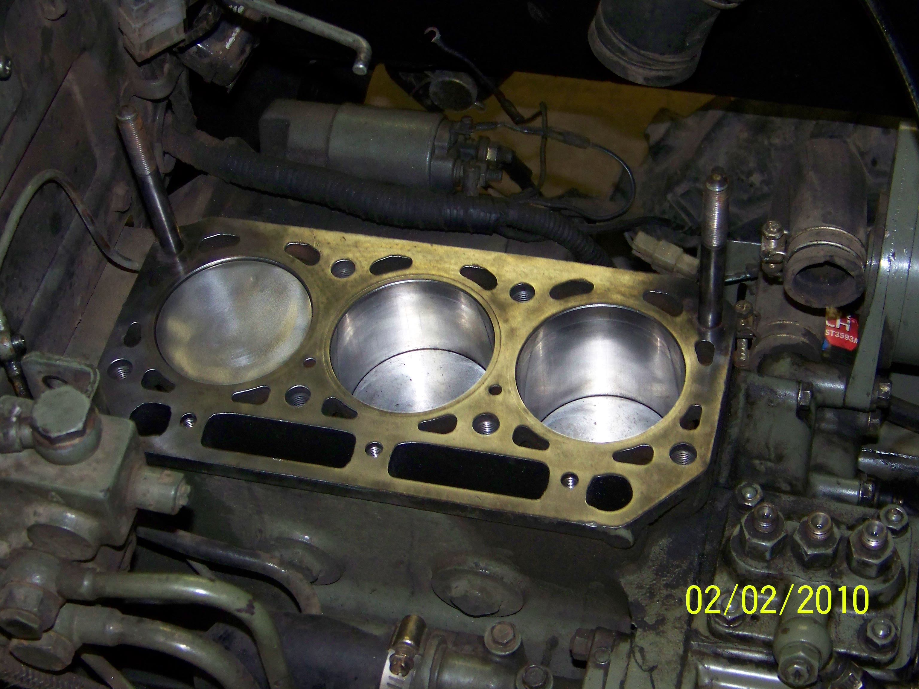

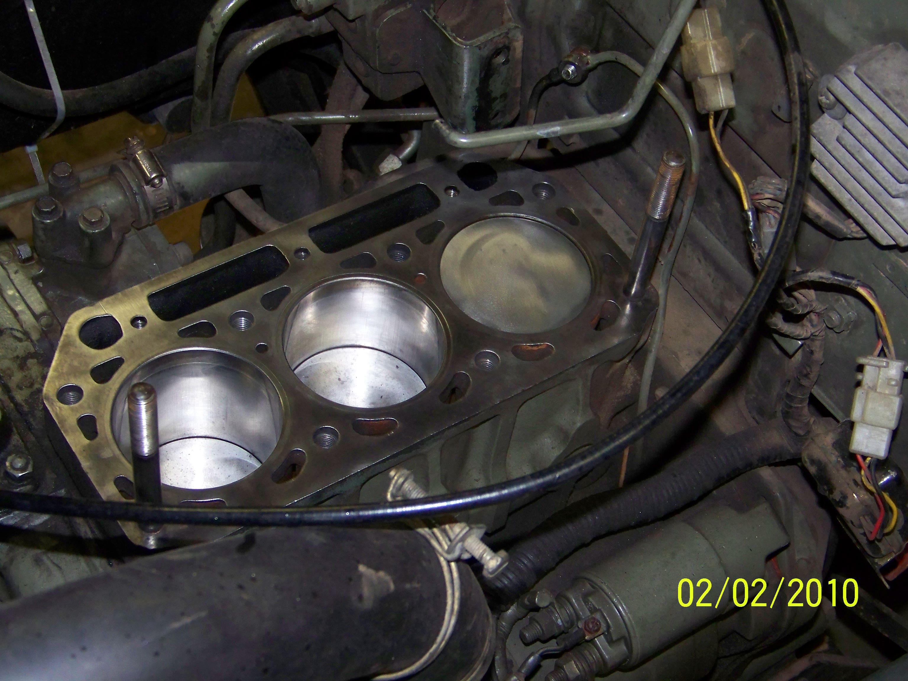

   / head gasket spray???????
OK guys, I'm with you. No copper spray. Hoping parts get here tomorrrow. UPS messed up so didn't get them today. Going to try and post my cleaned up block and head. Thanks for your input.

Got her back together today. Took my time, everything clean, torqued per manual, valves set, etc. No thermostat when I tore it down. There is now and I think it much better that it gets on up to operating temperature. Been running cool cool. Bled injector lines and she fired right up. No more bubbles in overflow bottle. I'm a happy camper right now! Thanks for your input.
