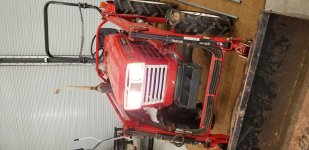

I have a resistance of 2.2 from the neg post of battery to the bolt the is connecting the negative cable to the frame. This is a bad issue?
   / Head Light Issue/Wiring Diagram #15
I would dismount the ground cable, clean all attachment points, and measure again. Might as well clean the positive cable too.
I think that should measure well under one ohm but if you're using the 'free with purchase' Harbor Freight multimeter, you may be within it's range of error. I recently borrowed a $200+ lab multimeter and found all four of my HF freebie meters showed a tenth to a quarter volt low, testing the 12 volt tractor battery. Think of that meter as a tool that can suggest an issue, not as a precision instrument! :)
Hi California, I'm using this multi meter....Klein Tools Auto-Ranging Digital Multi-Meter-MM4 - The Home Depot
I will do exactly by dismounting the cable and cleaning well. Meanwhile, I've checked the starter switch and it turning out fine as well the head light switch. I took that switch apart and was really clean inside so I was happy about that. While I was at it I dismounted the fuse box and cleaned all the contacts behind it where the wires clip on, plus the bus bars for each fuse. Turns out while I was going over things the wires were not on there perspective post, so that's all corrected now.
What I have done today as well was remove the head light fixture and will clean it. I checked the black ground wire noticed the connector a little dirty and have wire brushed that. I'll see what happens after I finish the ground cable from the battery and assemble all.

I finally assembled everything I took apart to check all ground wires. Lights are working now....hurrah !!!! 20180301_085458.jpg
