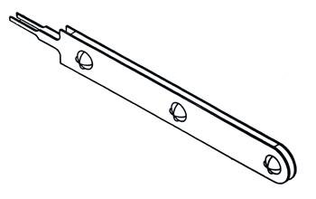

The is usually a prong on side of terminal that locks terminal in plastic shell, inserting a thin straight metal object between terminal and shell should release terminal, and push out from wire side... You may be able to open up crimps to replace wires or if crimps do not hold , solder connection...
   / head lights went out #13
They make molex release tools
