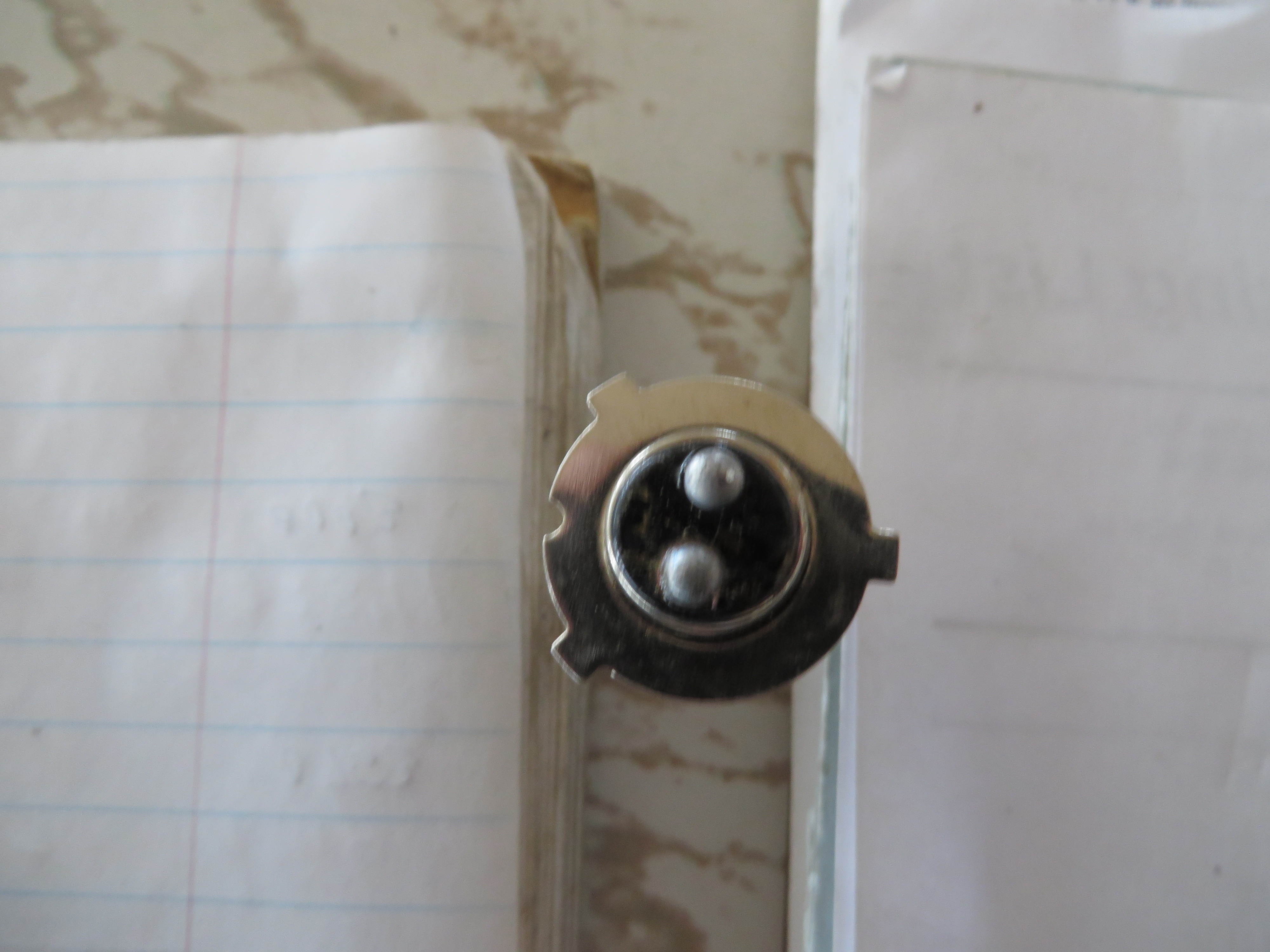

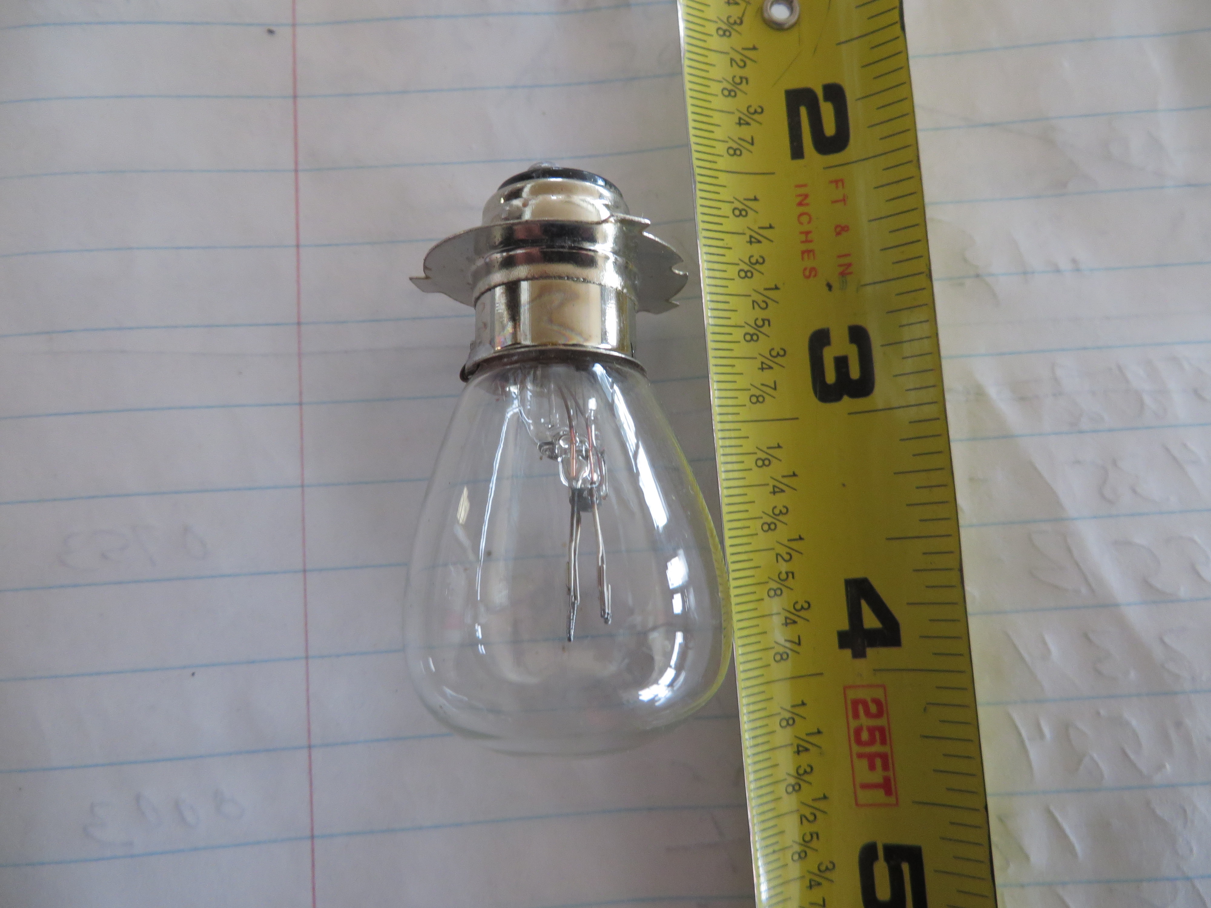

From these pix can you determine what halogen or LED bulb will replace this headlight bulb from my YM226D? It has dual elements for hi/lo.
Yanmar part no. is 194262-53080.
Only writing is 12V 25W.

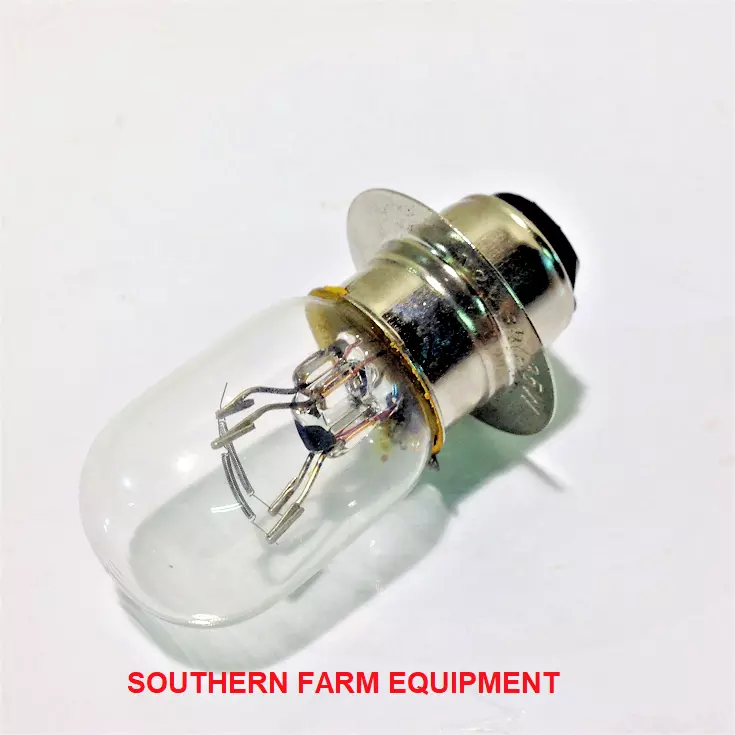

Actually, that is the same stanley headlight assembly that is on my M9000's and I replaced the feeble filament bulbs with LED's. you have to look around to find them but they are on Flea Bay with the odd base. Big difference and much, much less current draw to boot. Plug and play 100%.

Your bulb is a P15D-3 Stanley socket.
or the Deere p/n CH15208
LED
LED
or spend more money for the original bulb type.

I don't use the headlights much if ever mostly just the Rear work light. Org. lights and this is the replacement. With both working I have all the Wattage I need. The LED. are bright I'm sure.
Yanmar Fredricks # LB-4155
