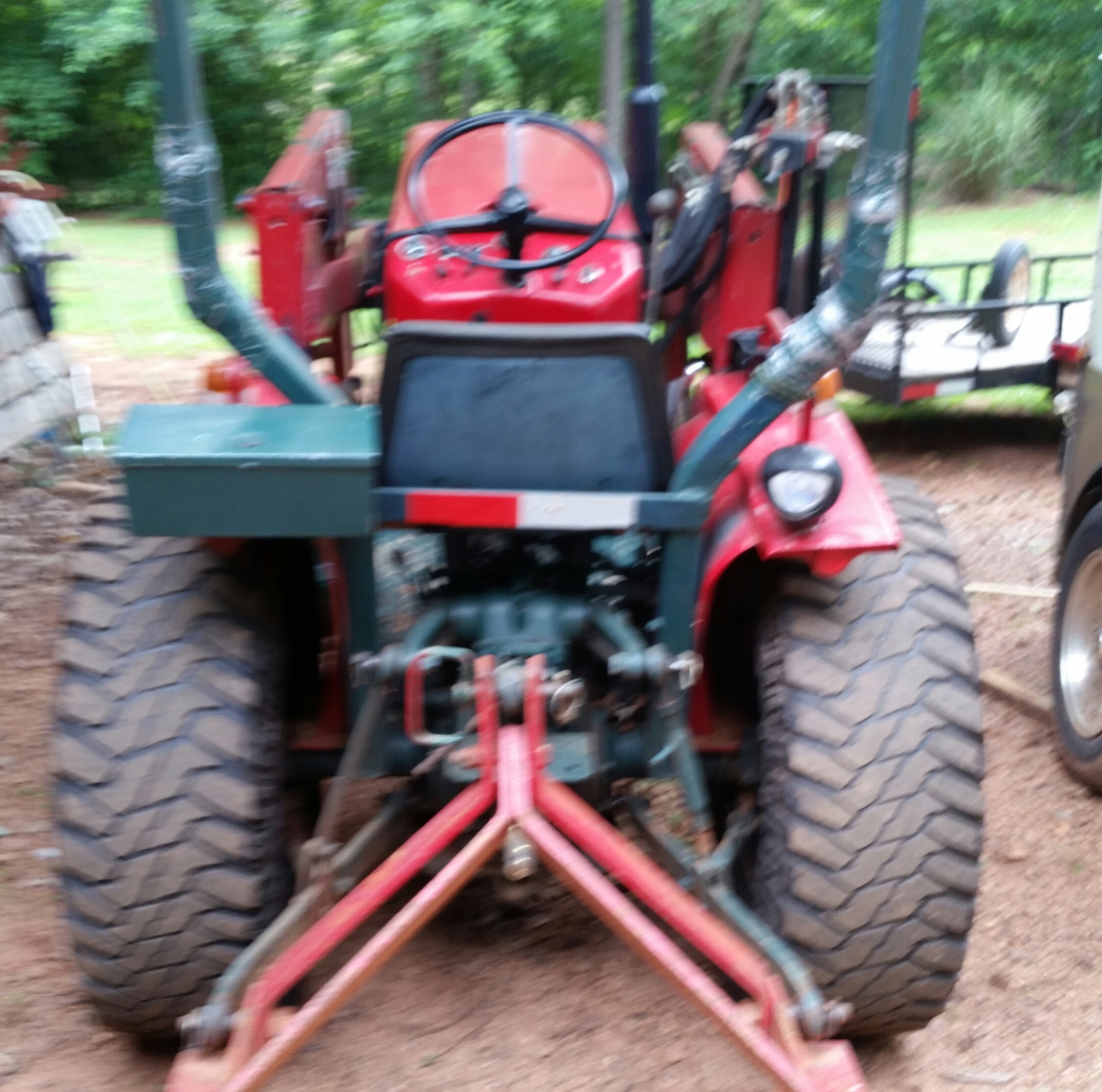

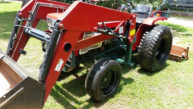

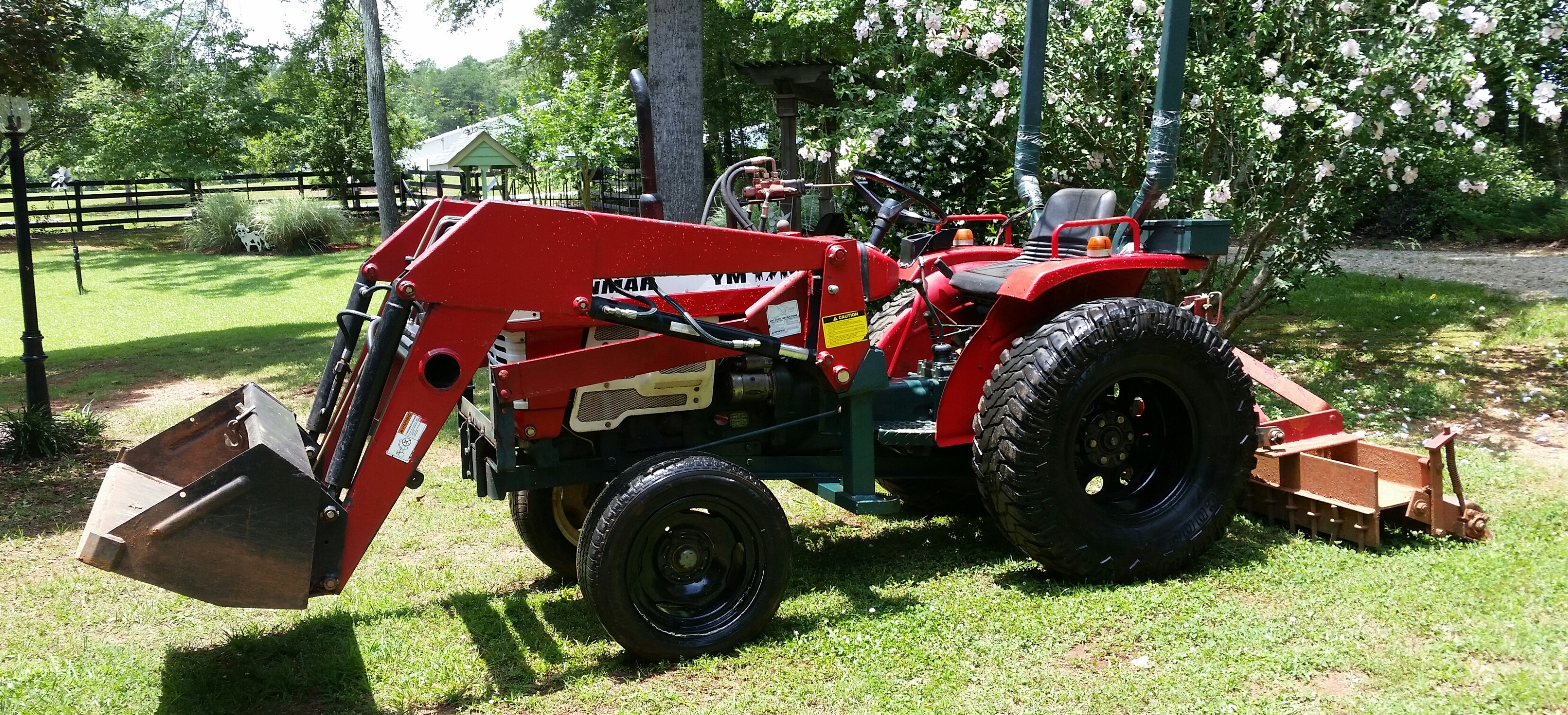

Hi Careyo63, same here about needing rear tires, last year I punctured one of the rear on my tractor, instead of fixing that tire, 3 weeks ago I decide to do the conversion to the truck wheels /tires finally located a pair of 37x12.50 x17 tires
before buying them I had to find some 6 lug chevy truck wheels, wound up having to buy the set of 4 just to get the 2 I needed, the 37" truck tires dropped the tractor about 2" from the 9.5 x24 I had on it, which were 38" tall, although the 37 truck tires after being 2/3rd worn measure 36" tall so it put it back at the original height from the first set of tires that came with the tractor (8.3 x24 which were around 36" tall ) I'm satisfied with how the tractor tracks and handles, I only wish had done this long ago, I hav'nt tried pulling the plows with it yet to find out how much traction I've lost, I think I can correct if any loss by adding liquid to the tires, although the truck tires weigh about two times of what the AG tires weigh, this alone should help with traction, I have pix but havn't move them to my PC.

Yes chevy truck 6 lugs will work but have to get the ones with the larger center hole found on the 4x4's, the factory steal wheels is what I used which were a bit difficult to find in 17" to fit the tires, plenty of 15",16" out there,
6 lug Toyota will work on our Yanmar's as well,
I did flip the wheels to give an added 4 inch more width a total of 52" from 48" originally,
Here are some photo's of the conversion, I also installed the frontend today. sure looks much better with the tires standing upright instead of leaning :thumbsup:
