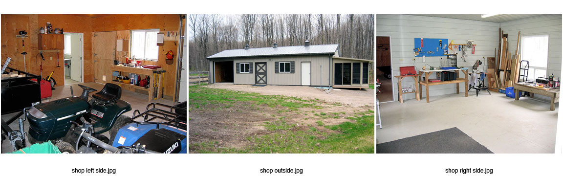

I'm looking to have heat installed in my shop for this winter. From what I've read so far, a vented, propane wall mount unit is probably my best option. My shop is a total of 800 square feet, fully insulated. There is a wall in the middle, with a man door for access to both sides. My questions are:
1. how to heat both sides with just one heater?
2. what size BTU? (remember, I'm in Canada, so it's cold)
3. Are the wall unit heaters quiet?
I've included a picture of my shop (and no, it's not that clean anymore, lol)
thanks for any advice!

If you are looking for one heater to heat both sides, the only one that I could think of that would work well would be a hot air furnace and ductwork. I don't think that a wall heater will do both sides of the building efficiently. Possibly two wall furnaces would still be less expensive than purchasing one hot air furnace and ductwork. They do make some very efficient wall mounted condensing propane furnaces that don't take up much room and are reasonably priced. Wall furnaces seem to have the prices pegged with the efficiency rating, so the more you spend initially, the more you save on fuel.

As you are having the furnace installed check out the local popular brand dealers. The Yellow pages. Chances are they can get you set up with a proper sized unit to handle both sides. Get some quotes. Choose the one you want.
Many garages have overhead heaters to take up less floor space.
I'd also insist on the high efficiency model that uses plastic pipe for the exhaust.

Check Northern Tool for heaters. I assume that they will ship to Canada. I have a 75,000 ceiling heater that works well, and the cost was reasonable. I did the work myself, and the heater and all the plumbing and vent parts cost me under $500. I don't use it that often to worry about efficiency. Also, how well insulated is the building? The better insulated, the less BTU's you will need. Mine was made by Mr. Heater.

Just as a suggestion a through the wall fan unit or ducting should allow you one furnace. That would be a lot cheaper than two units.:D

Since it is too late to install radiant floor heating, a radiant tube ceiling heater would be by far the nicest, but unfortunately also one of the most expensive options. They are nice because they heat the floor and objects on the floor instead of the air, in which case the air at the ceiling can be 90 degrees while it is 60 degrees at the floor. Otherwise a wall heater works well, and they are very quite because they are designed to go in a home's living area such as the living room. A hanging unit heater also works well, and is one of the easiest installations, or like someone else said, a used furnace with a small amount of duct work to blow the air where you want it.
