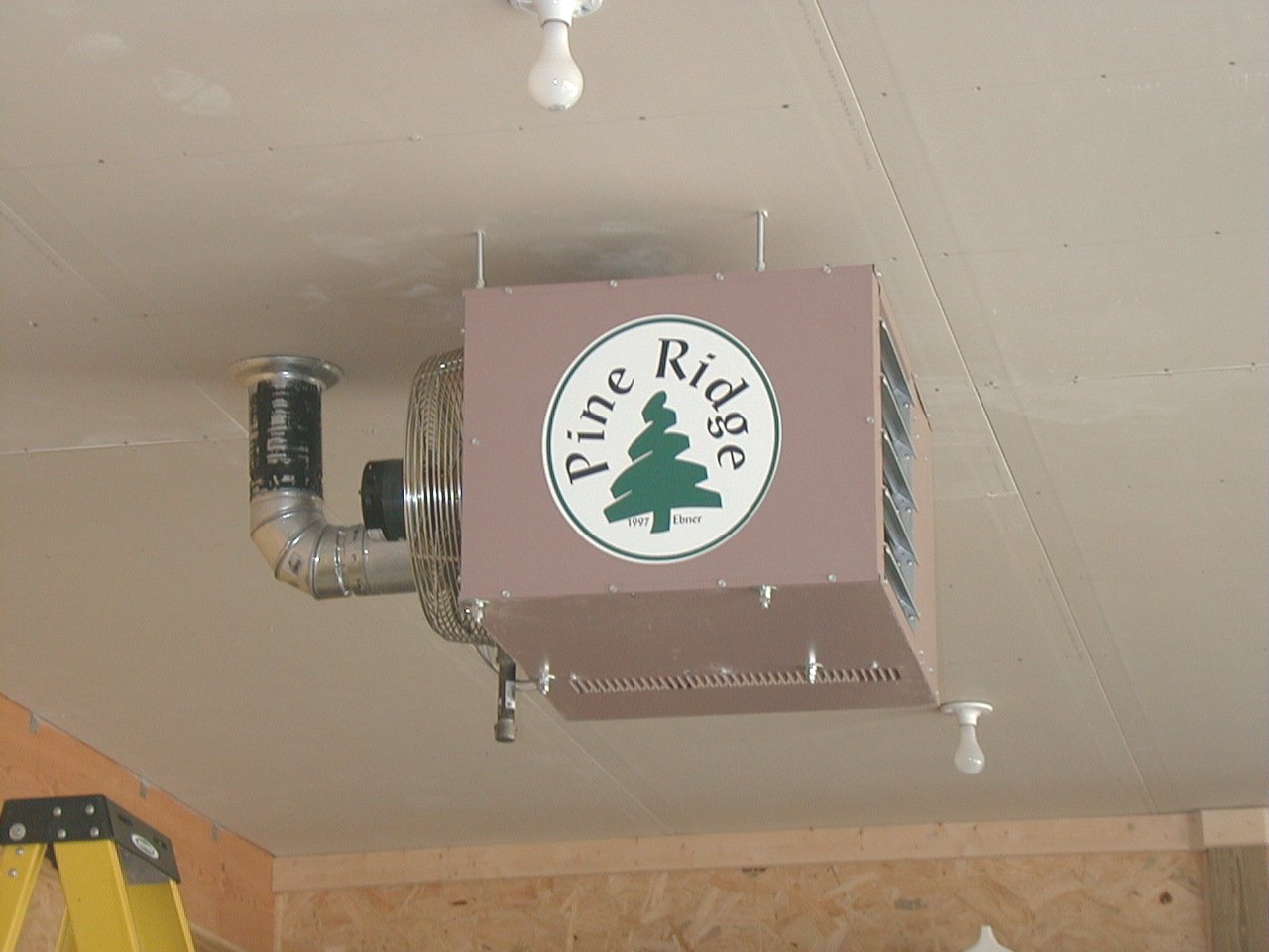

KubotaOne said:
I'm looking to have heat installed in my shop for this winter. From what I've read so far, a vented, propane wall mount unit is probably my best option. My shop is a total of 800 square feet, fully insulated. There is a wall in the middle, with a man door for access to both sides. My questions are:
1. how to heat both sides with just one heater?
2. what size BTU? (remember, I'm in Canada, so it's cold)
3. Are the wall unit heaters quiet?
I've included a picture of my shop (and no, it's not that clean anymore, lol)
thanks for any advice!
1*I plan to use an out door Combination Furnace and AC unit centered along the outside back wall with a tee with one line going to the left and the other line going to the right of the center wall partition.
The beauty of this set up:
1*Does not take up any floor space
2*No venting is required
3*Cheeper to install due to a very mim amount of ductwork.
4*Safer~no flames inside the building to ignite fumes or cause an explosion.
5*Can control the temperature of each side by opening or closing the register in each room.
6*When I was checking this out it cost less completely installed than the cost of installing a regular Furnace or Air Conditioner

I have seen some attic forced air units that go in the attic space, which take up no floor space; they are "out of site" and takes little duct work to install.
