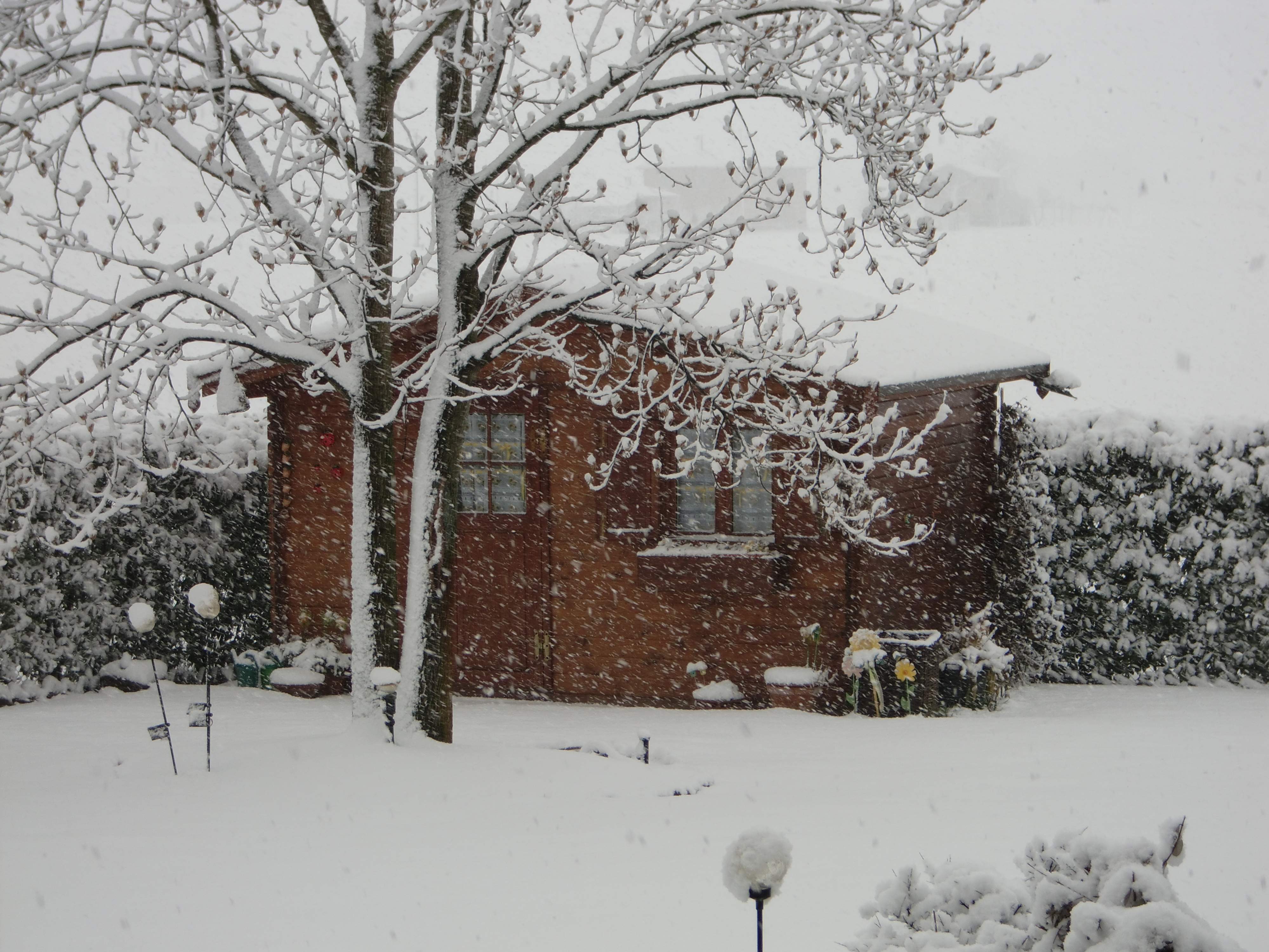

Hi, I have a wooden garden shed 3m x 4m, that is well built, no draughts, but not insulated. In the winter we get well below freezing. I'm thinking of installing electric tubular heating. Just to keep the plants from freezing. How many watts will I need?

Depends on your climate, and how much wind there is, whether your going to open the door in the cold weather, or not.
My guess is 2000 watts could keep it 45 degrees. And it is potentially going to run a lot of the time.
You would be much better off insulating it, if your going to heat it.
The difference in the amount of wattage would be considerable.
In contrast, you can heat a small area with a light bulb, if you insulate it well enough.

The truth is that until last winter we never bothered. Temperature never got worse than a couple of degrees below (Celsius) so there was no need. In the winter we just use it as safe haven for plants. No traffic in and out.
Then the surprise in December, heavy snow followed by deep freezing over the following months. We jumped down to minus 17 (Celsius) . This was partly the effect of the Iceland Volcano so I hope it won't be so bad this year. Just want to be on the safe side.

In that case, I would just insulate the building, and not worry about heating it. It should not freeze in there, in that kind of climate.
   / Heating a shed #37
To be safe with the plants, A thermostat controlled electric 1500 watt heater would do the trick. Ken Sweet
