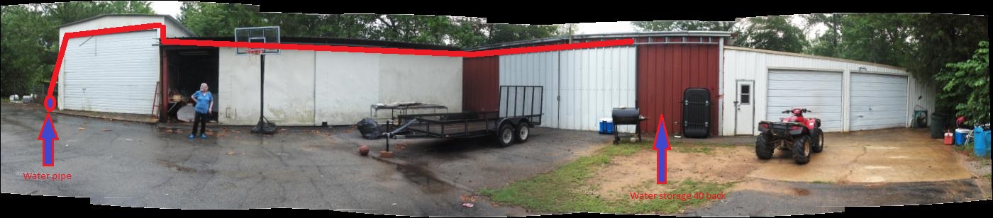

One of my 4 shops in Mississippi
which I do most of my work in has a 40x40x12 section, it came with a Gas Garage/Workshop Unit Heater hanging from the ceiling, probably about 150K BTU, fueled by LPG. Other shops have smaller hanging heaters. Someone stole our two 250 gallon propane tanks (with about 400 gallons total of fuel) back in 2013. Since it's rarely below freezing there I bought a portable kerosene/diesel heater (salamander) about 80K BTU for the "interim". On sale for like $100 or $150. I put it on a $7 HF furniture dolly with the plan to roll it around to wherever it was needed.
I tend to work in a "small" area and found this sufficient for getting a work area warm QUICKLY and keeping it warm. It's a little noisy but I have easily rolled it to other shops and suppose I could use it outside. I'm seriously thinking of getting a slightly larger (in BTU) LP that I can run off a 20lb propane tank and still maintain the mobility. In my present method of operation I rarely need a "big " area heated. But I think IF I did the two heaters could warm the entire shop.
The "interim" continues.
