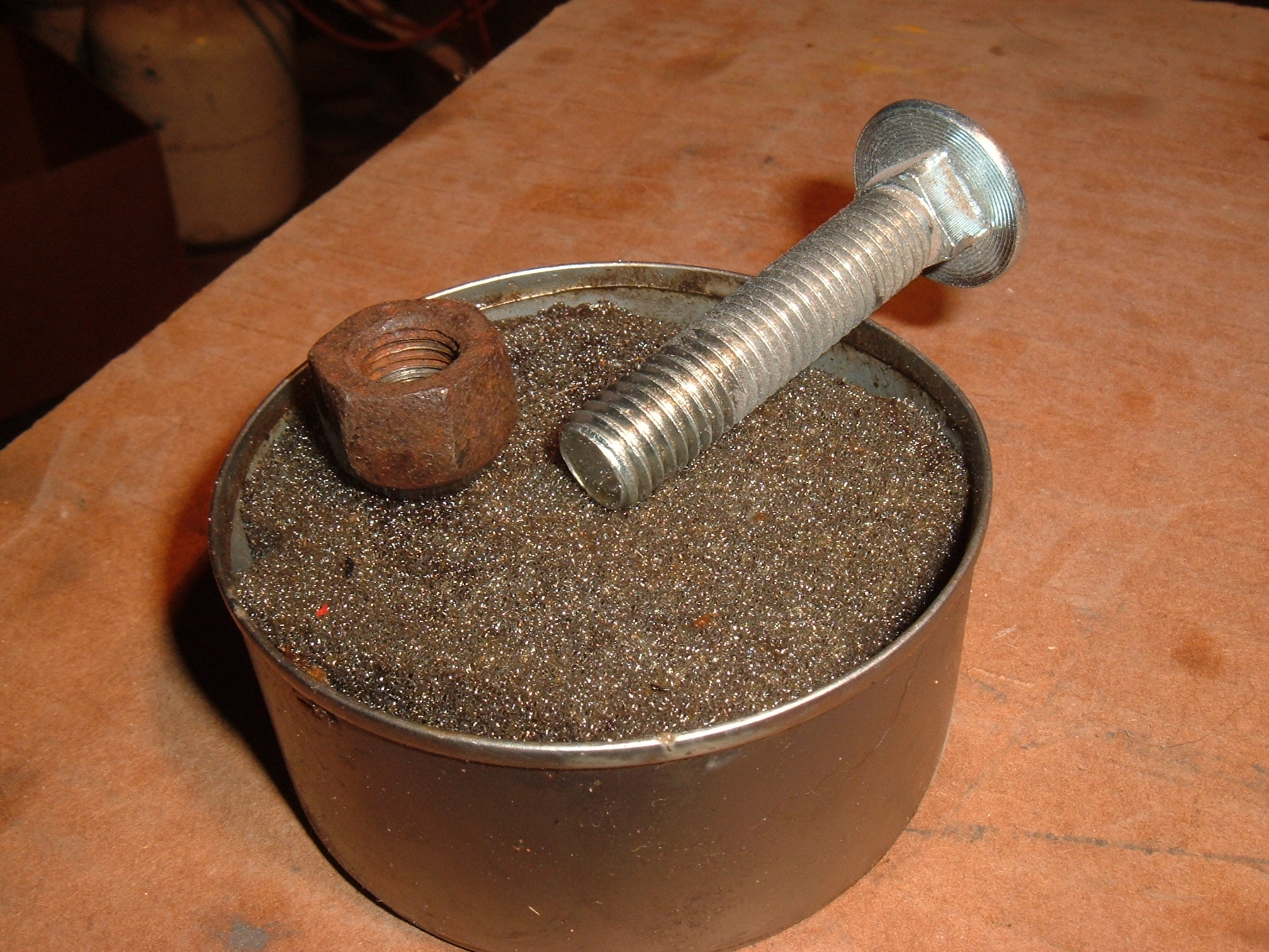

I know never seize is babbled about continuously but really a pinch of spray or light oil works. A can of never seize last me a long time, I really rarely use it. We use common penetrating spray, the Kroil types but not so expensive. The education of mechanics is very poor in this area,,, almost pitiful so many dont know how a bolt or nut work.

Put a nut and bolt together that are different materials using a 'pinch of spray' and leave it outside for 15-20 years then try to take them apart. Lemme know how it works...
   / Heating Aluminum Case to Remove Oil Plug #28
I have done this and can tell which ones were sprayed. Even nuts submerged for a decade. We own and service the same equipment for decades. Have pulled a lot of stuff apart had that snot on it and didnt help all that much especially corrosion.
In fact done it not only once but 1000's of times. Never a problem if they been sprayed, some even have exposed threads rusted off, look almost new internally.
