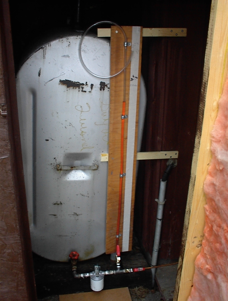

If you can get the tank under shelter, away from the elements, I think you will be just fine with it. Make sure that you have drain valve to drain water off if needed. I would store it with a small slope longitudinally away from the tank outlet; to allow water to drain in one place where the drain is. I would also add a fuel filter on the tank outlet to trap water/dirt etc.
Have attached a photo of my setup for you. The diesel in my tank is probably 14 years old and it is just fine - it is the supply for my back up generator. I run the generator every couple of months and have had no problems to date in the ten years I have owned this property.

I liked Doxford Jim's tank and gauge- and I noted the valve on the tubing. Treat the fuel, keep the tank full, and install a decent fuel filter/water separator, and you will be fine, even for long term.
