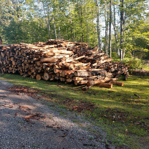

I am 69 so not very speedy any longer...LOL.
The game changers for me were an MTL grapple ($1000), IBC totes ($800 - enough for 2-3 years of wood) and a cutting table. I rarely if ever need to pick up anything, or do constant bending, and I only stack once. Using totes provides protected storage without a building or using tarps. See below.
I buy logs. See below. That means wood that is easy to split and no large rounds. Any logs less than 5" in diameter are not split. The grapple takes the logs off the pile and puts them on the cutting table. From the cutting table (that is slightly higher than the splitter), the rounds are directed to the splitter. The splits are taken off the table of the splitter and stacked into totes. Each tote holds just under 1/2 cord of wood. Loaded totes are moved to an area for seasoning. Totes are moved into the attached garage before winter and as needed as I run low. I use a pallet jack to station totes in the garage as my tractor will not fit under the doors. This was the fist year using totes, and I was able to put four cords in the garage. I will be able to store about 6 cords next year.
I am not saving a lot currently by using wood because LP is at $1.40. But four years ago my contract price was $2.30.
When that happens, wood nets a significant savings. If I get to the point I cannot process wood, I have two local suppliers that will fill my totes for $75 ea. ($150/cord). Totes make wood handling almost a non-issue in my situation. Totes require a lot of FEL or 3PH capacity as mine weigh about 2000 lbs, so not a good option for those with smaller tractors.
