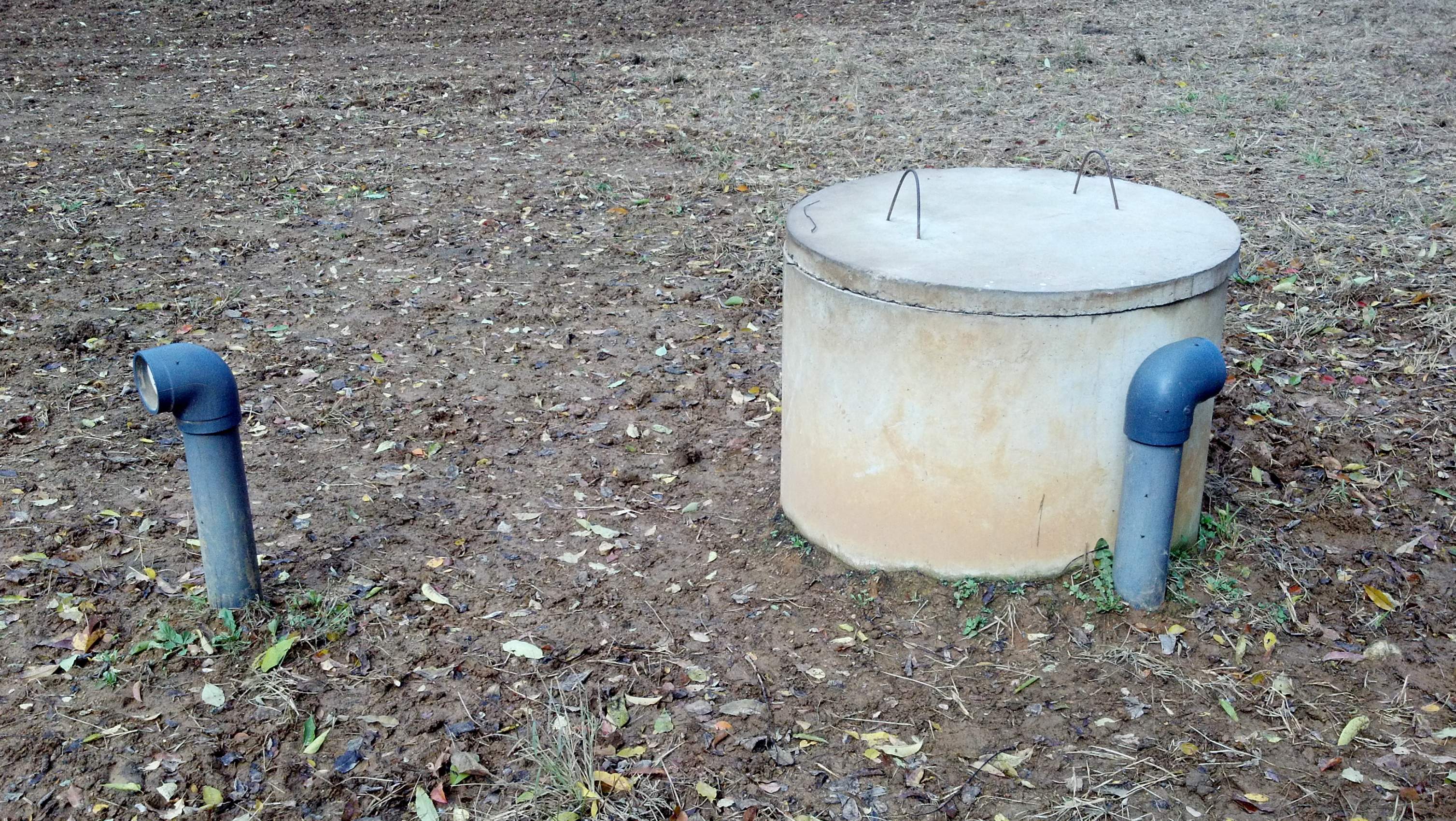

How do you guys keep your well pit from freezing? This is the first house I have owned that has a pit. My other houses I had, the pressure tank was in the house.
I plan on getting some straw to put over the top of the pit. I did see the previous owner had an extension cord running to the pit, not sure if he had a heater down there for when it got real cold or not.
BIL and his friend are up deer hunting this weekend, both electricians, one a master, one journeyman. To show their appreciation for letting them hunt on my property they wired in a outlet down in the pit to plug a heater into.
Howdy,
What type of well pit do you have? Do you have a large sewer drain lid and climb down the ladder into?
8'x8' and about 75" tall inside, all inside coated with UGL waterproofing, and about 5 inches of dirt over the top.
