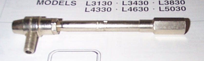

Here is a pic of the deflator. The air source connects to the threaded peice. The suction is createc on the long end.

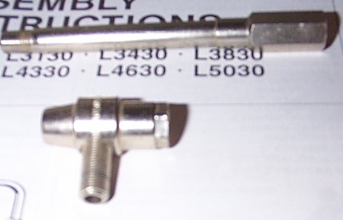

Another pic without the extention, it works without it.

Nick, very impressive burner. I suggest you shorten the extra threads you have sticking up from the top bolts. When you need to take it apart to clean those threads will be covered with residue making it difficult to remove the nuts. I would cut them to the top of the nuts.
I have found it helpful to have some oil kept in a warm place for your first burn of the day, it flows better.
What do you plan on using for the cover funnel, make that adjustable up and down if you can, once you start to burn you will find it helpful in getting the best burn.
Keep on inventing, just be careful.
