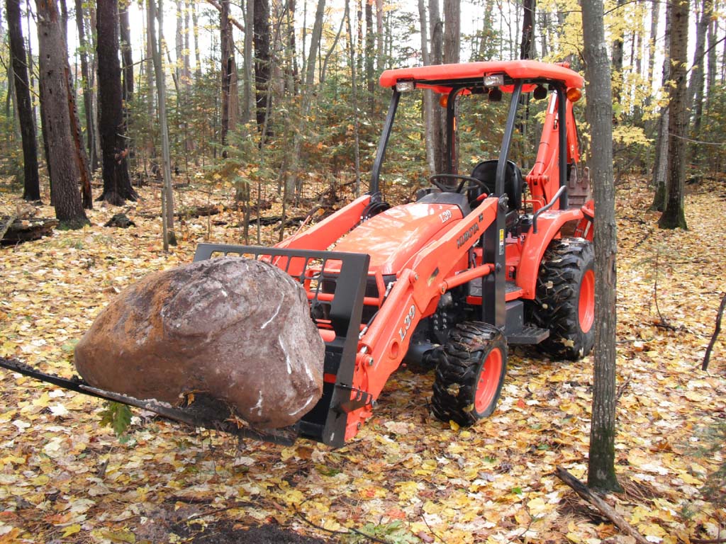

I have some 4500 lb rated forks that I use on my L39 and DX45. Besides the typical lifting chores, I have used them for digging up rocks, old concrete and stumps and have not bent them at least not yet. If you use them for digging, be sure to get something that can handle the break out force of your loader. Both my tractors have break out force just under 3600 lb. That is at the pins so it will be less near the end of the forks, but you can be pushing with the tractor as well which can add significantly to the force.

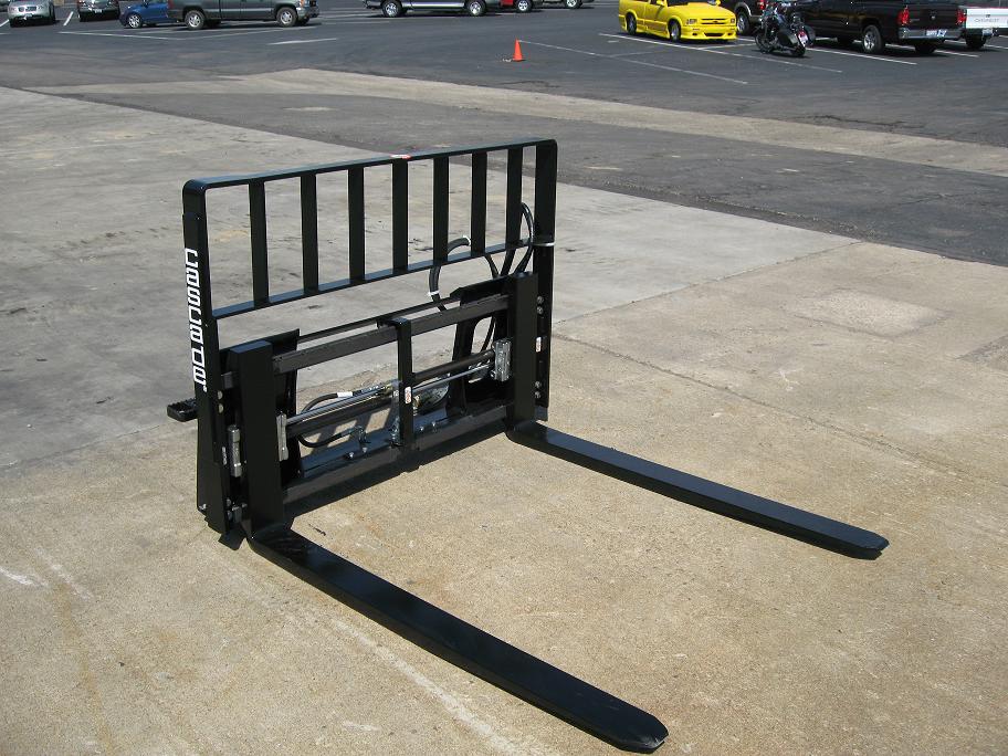

If you send me a pm, I can get you info for a 5500lbs capacity set that out tested the HD version of a major skid steer manufacturer and can be configured in many different ways, including hyd fork positioning that can be added at any time.

I have a set of 5500lb forks from Construction Attachments. Standard frame, heavy fork. Not much weight difference between the 3000lb forks and the 5500lb forks given the same frame and fork length.
Haven't hurt them at all, and yes, I have used them for odd jobs on the farm - as in "There's that rock I keep tripping over.. wonder if I can just pop it out of the ground real quick".
They're very handy! Beats a shovel when digging out smilax root balls also.
