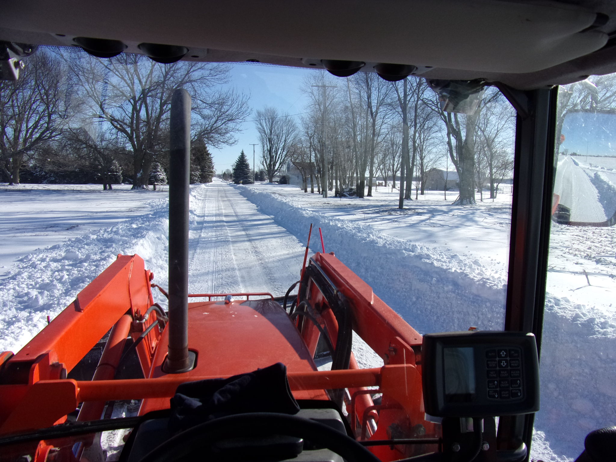

On the larger end of what you might be looking at, Rustyiron has a very nice Kubota M9540 setup for plowing:
635375d1578107775-pictures-your-snow-weapons-20191231_090151-jpeg

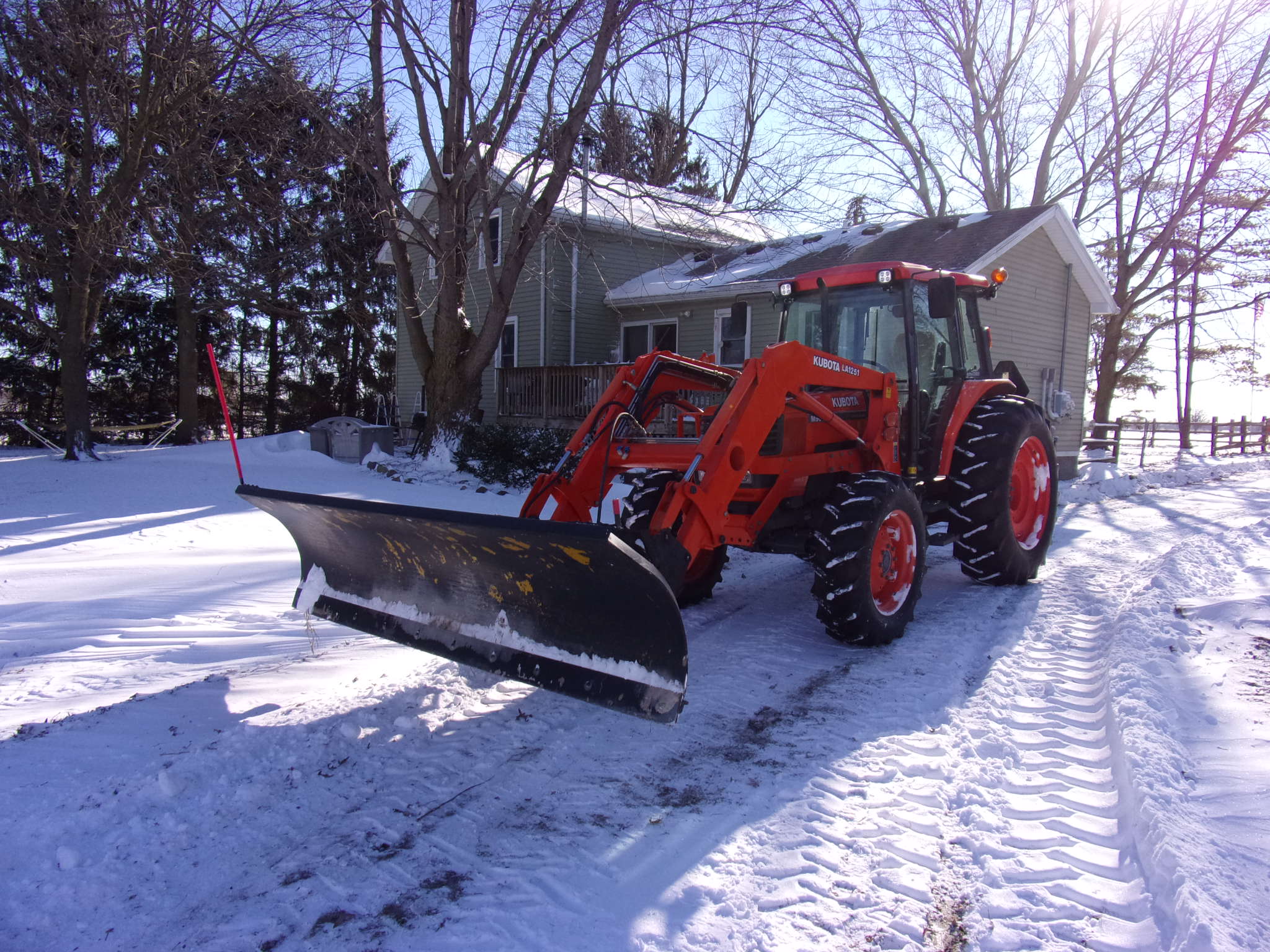

This is me with a 10 foot power angle retired county plow. Usually have chains on the front tires (none needed on the back) and in FWA always when plowing and a snowblower for the back as well, just not on in the picture.
Bought the plow and subframe for a grand from the road commish a couple years ago and refitted it for a SSQA mount. Put on a new wear edge and keep it greased and it's good to go. You will need a tractor with 3rd function or hydraulic QD fittings in the front if you want power angle.

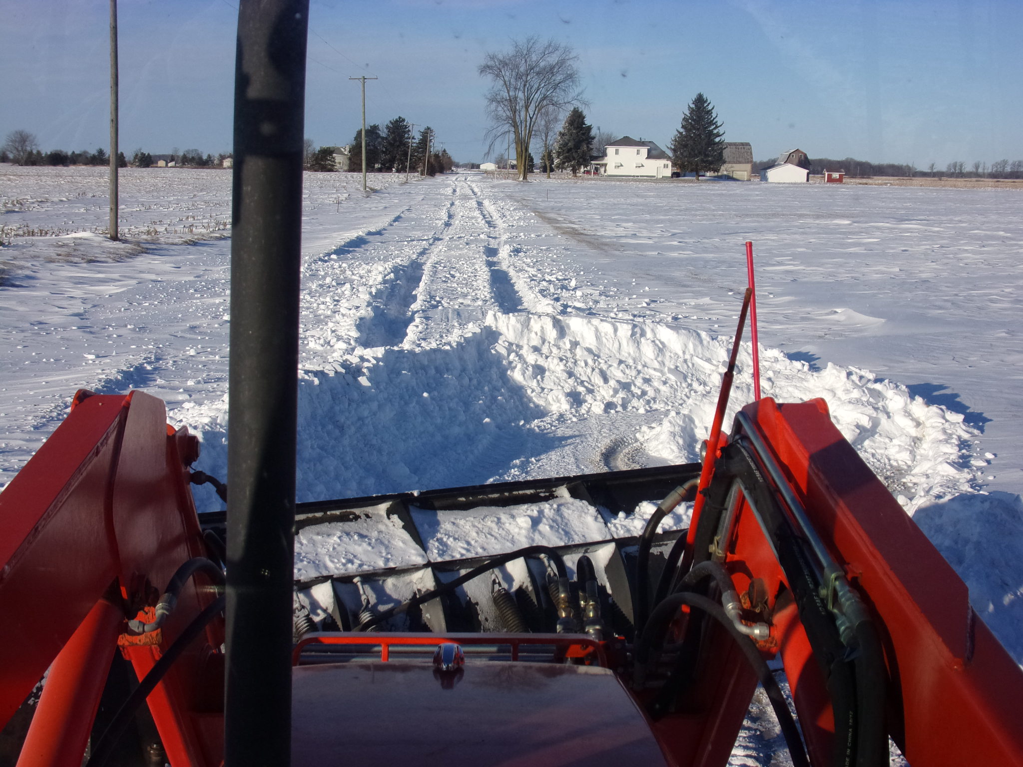

I would spend the extra money for the factory cab as you will get something back for resale.
The best made homemade cab is worth zero. It will probably detract from making a sale unless it is removed and the machine shows no signs of the retrofit.
That isn't my experience. The homemade cab is what sold my L3200 package deal yesterday for $18,500 with the implements in the ad. Not my opinion, but three buyers. One said he'd take it if the other buyer didn't show yesterday. I had a little over $20K in it NOT counting my labor spent on fabbing the stuff. Bought the tractor new in 2012.
212 Kubota L32 Sold Jan 17th - farm & garden - by owner - sale
I have used tractors that had home made cabs or vintage cheap cabs. They can be extremely loud like you are sitting in a echo chamber. Just something to think about....:2cents:
True. I always used ear plugs or wore shooter's muffs in my homemade cab in the L3200. The L4240 factory cab is a totally different experience. The L3200 was replaced to get more HP for a front-mounted snowplow, wider RFM and A/C for the hot weather.
