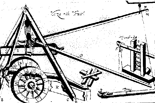

Don't worry, LD1 and Arrow, I'm not going to try to pick up a ton with my front-end loader. Even if it had the capacity, even Wile E. Coyote could figure out what would happen if he tried that. But a couple of hundred years ago, a 1,200-pound horse could mount a 3,000-pound cannon on its carriage. Can a Kubota do any less?
