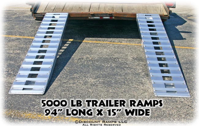

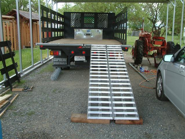

I went through this hassle deciding which ramps to get for my 2004 Isuzu NPR stakebed (8 x 14 ft Supreme bed). The bed is about 38" high and I need 10 ft ramps with 5000 lb capacity to load my parade tractors (~4000 lb). After considering fabricating them myself out of steel using my stick welder, I decided to go with aluminum ramps from Discount Ramps.
Loading Ramps, Hauling, Transport, & Skateboard Ramp Superstore - Discount Ramps.com
Thanks for the link, that might come in handy :)
These ramps weigh 49 lb each and cost $550 plus shipping. Considering the cost of steel and my time, I figure I'm ahead by buying instead of building.
I have a set of these and they are suppose to be 5000lbs per axle.. They did load the weighted 3400 w/loader without even a squeak.
