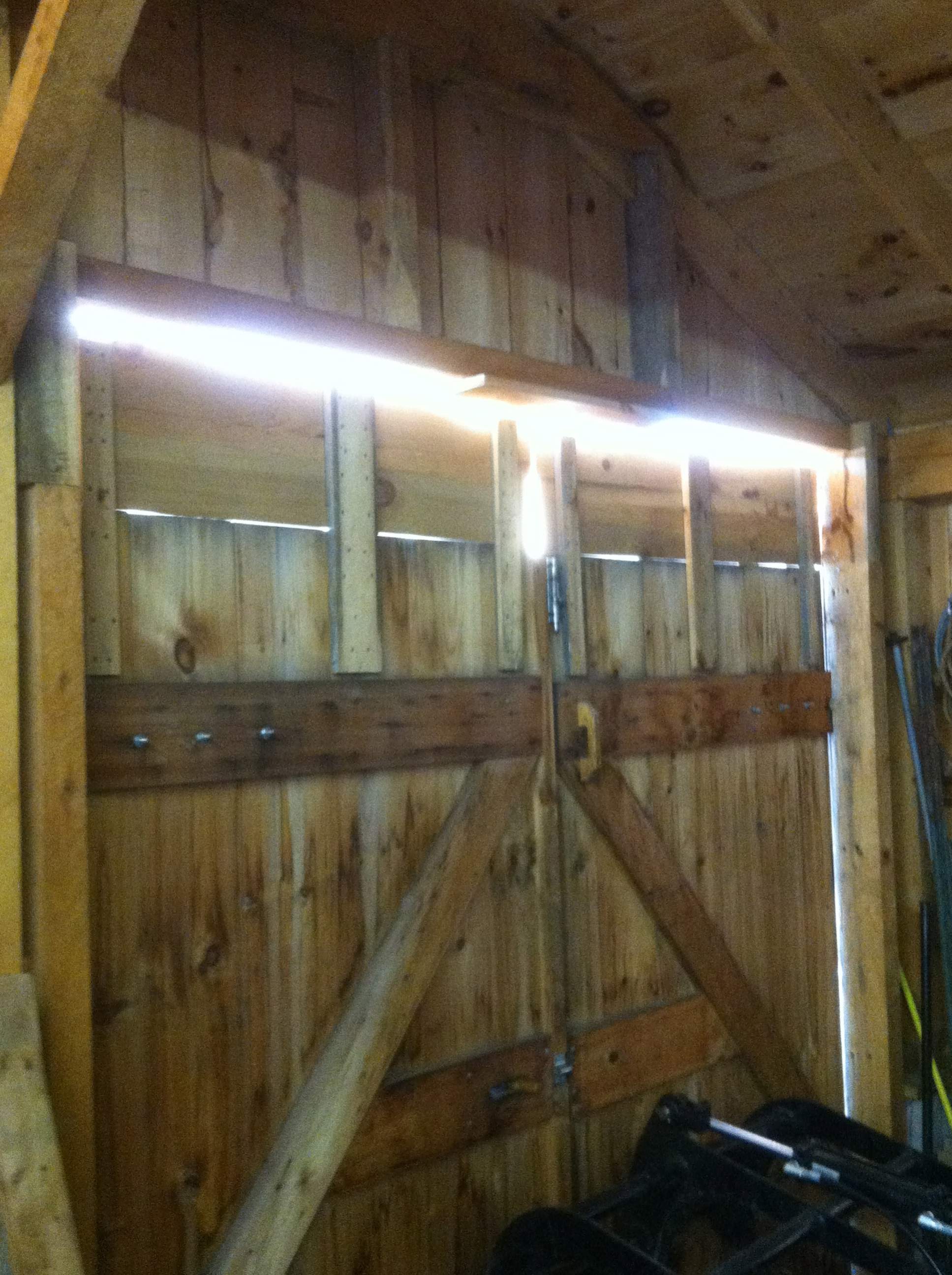

And that is what the next step is! Actually to give me the 1/2" I have now I have a block of wood jammed between the door jam and the bottom of the door-that pushes the door to past the point where the cable/roller would normally hold it.
Just so you all know, I didn't have much choice here. this door is on a shed side of my barn and an 8' height was the max I could do-I guess without spending a lot more on a custom door. the attached shots shows the new header I cut in-as well as the temp extensions I added to the old barn doors while waiting for thje new door.
Thx guys for all your opinions- I think the consensus is I will be no worse with the tires in ballast.

Anyone have an idea on effect ballasting tires has on total height? I have 17.5L-24's on my JD 4720 and just replaced my barn doors with an OH- (didn't want to spend a half hour shoveling snow before I could get the Deere out-wasn't a problem this winter:laughing:).
In any case with the new door open, I have 1/2" clearance under door. My guess is when I load the tires, I should get a bit of sidewall defelection and if anything should pick up a bit of clearance.
Any opinions?
I have the same tires size tires on my L5740. I had mine loaded with RimGuard. 55 gal per tire with a total weight of 1298 lbs. I only run about 10 psi in my rears otherwise it's a little rough without an implement on the 3 point. I the tractor definitely didn't grow any. If anything, like you said, I think it squats a little.
