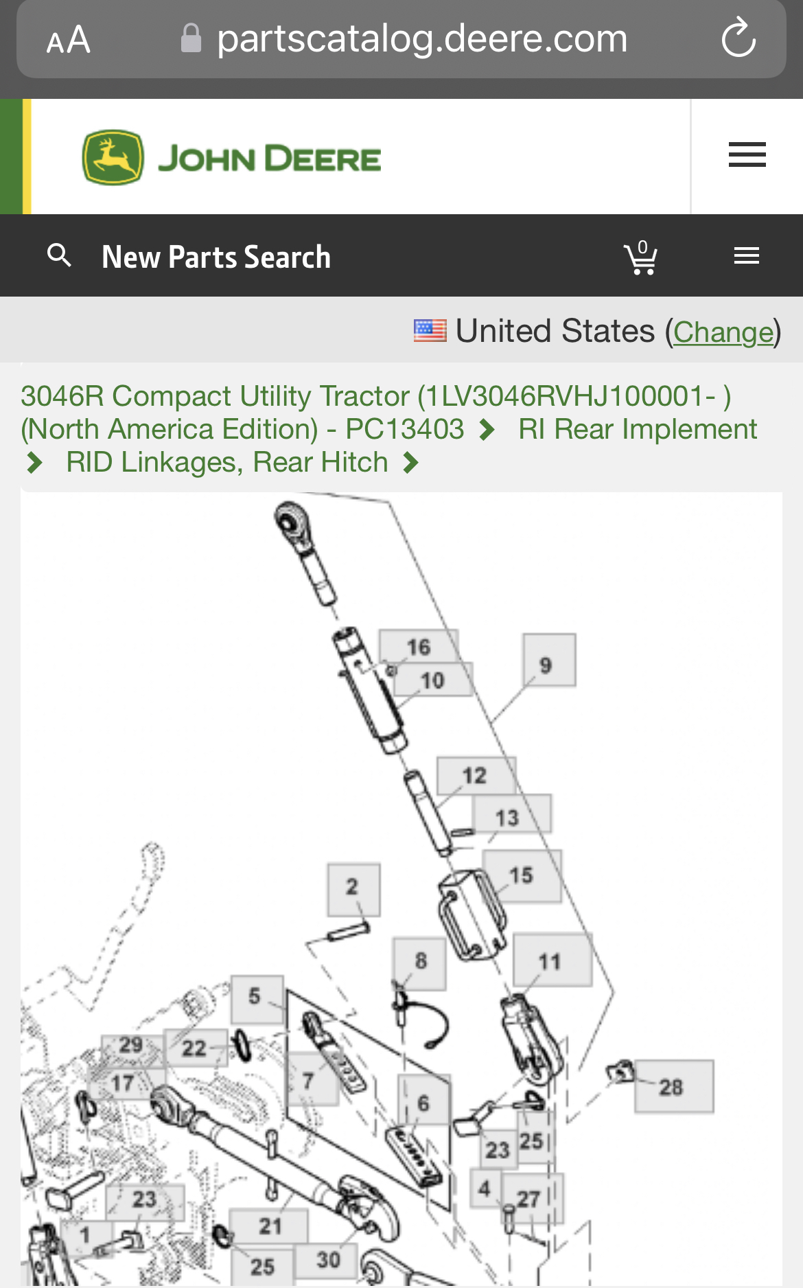

I’m pretty sure you’re thinking about the Lift Link (leveling assembly) style like those found on several of Deeres CUT’s (compact utility tractors). Those have the Turnbuckle and Yoke portion Lift Link fitting inside each other, which is then covered by the handle (square tube with solid round stock welded on each side to make the handles - it’s supposed to help things turn easier when making leveling adjustments, while keeping some of the threads clean from dust and dirt when the handle is returned to its “storage position” resting on top of the pin).

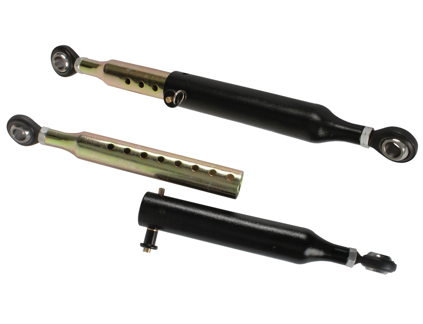

I was thinking more like this, but in rectangular box section shape. This looks like a top link or side link but if you picture this as a lower arm, this is what i'm remembering..
   / Height of 3 point hitch #30

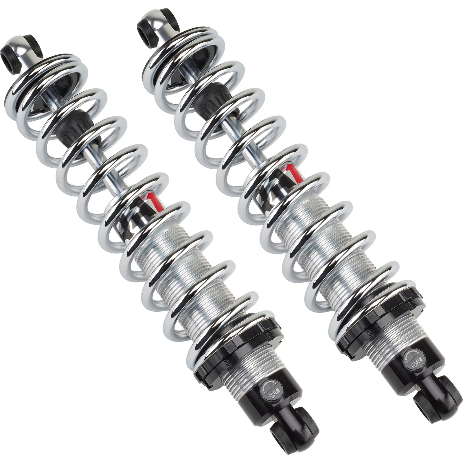

I know what you're thinking, but it's probably not as good as you're thinking. :confused:
They are 'coilover ride height adjusters' meant for mocking up suspension on cars made or modified to use coilover shocks like these:
They ARE about the same size as a Cat0 top link, or some side links. I'm using one as a top link on my Case garden tractor. They have 5/8" ball ends. But i wouldn't use one as a side link unless you drilled out all the holes for a cross-pin bigger than 1/4".. i dont think it would hold up as a side link unless you did that. And too small to be a cat 1 top link. I AM planning to use these as the 3pt stabilizers on my little b6100 and get rid of the annoying stock ones.
They are $70/pair.
