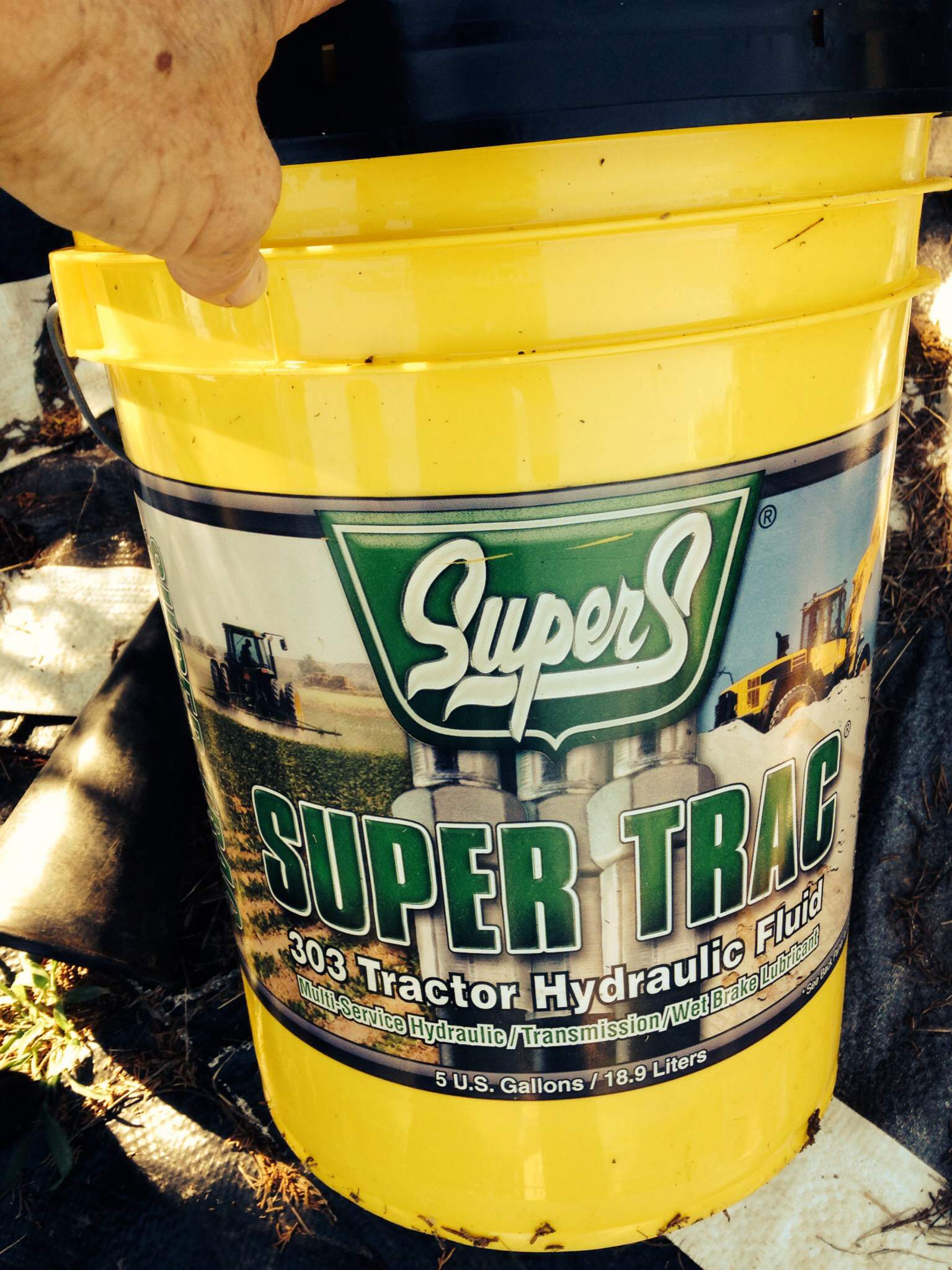

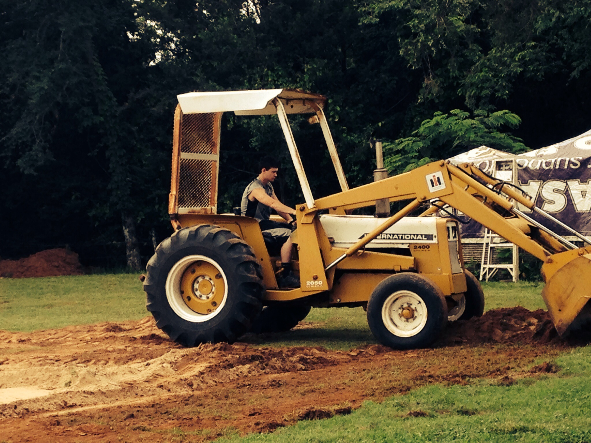

I think you will find it calls for Trans-Hydraulic Fluid for Case/International Harvester.being overfull and wrong fluid might be cause of noise.I would drain it and start over.
   / Hello from Arkansas
#15
Okay I can do that. Where do I drain it from? Underneath there are 3 big screws I know the front end is oil. Is the back 2 where I drain it from?
   / Hello from Arkansas #16
hydraulic oil runs transmission and for Brakes and your loader.I have never drained mine so I am not sure.I would say you are right.I have my tractor about 5 years and it was changed when i bought it.
   / Hello from Arkansas #17
just guessing ist plug would be transmission and second would be Brake system,
#18
I've been searching several sites and the one about 454 says they have 2 transmissions one for high low gears and 1-4. So I will locate the transmission oil and then drain it. Thank you I'll let you know what happens
