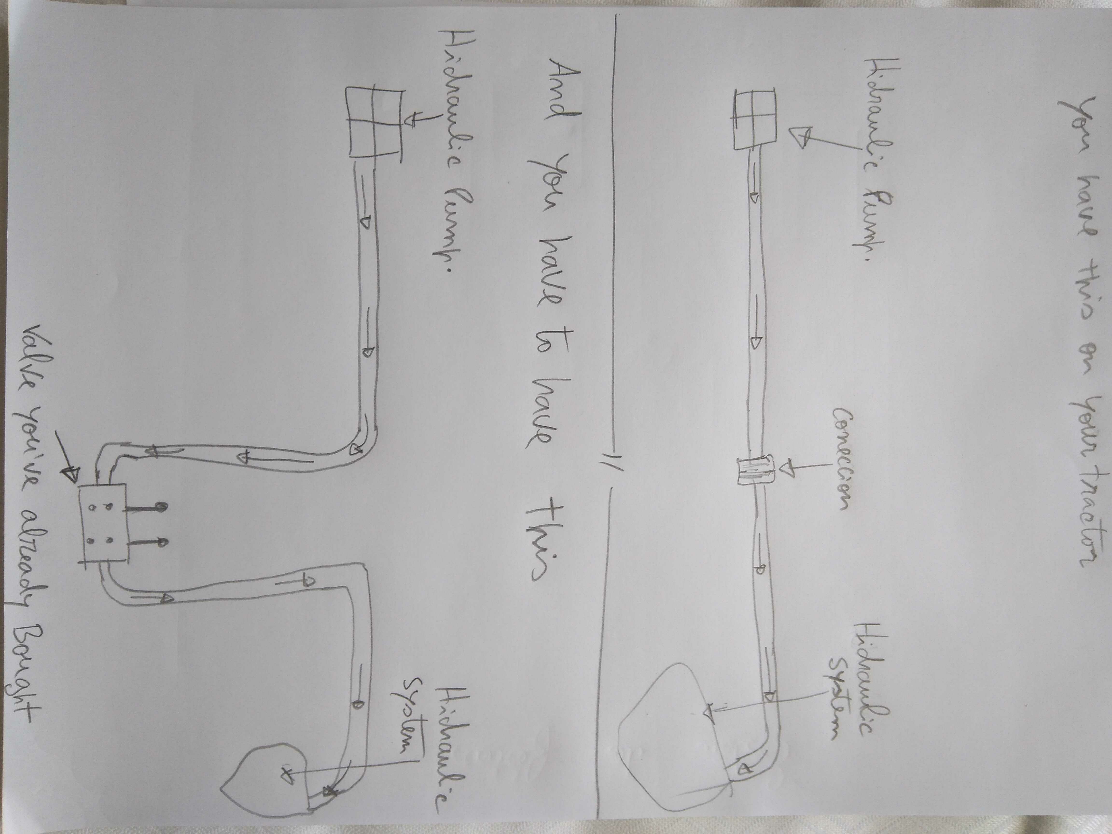

   / Hello from Belgium, Bastogne Nuts City ;-) #26
You have to do exactly this
#27

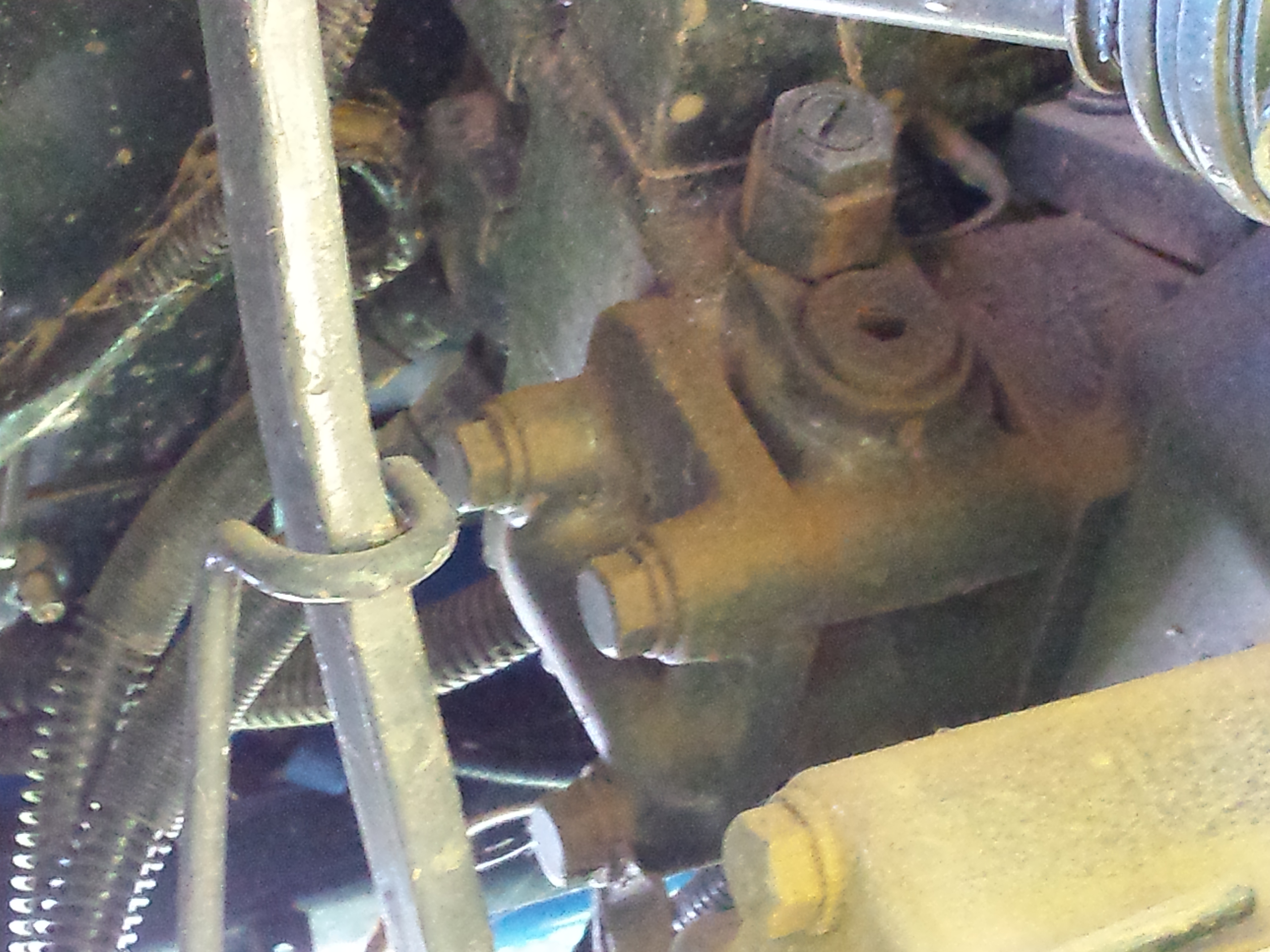

Ok Ok thanks to all :)
I just have to find this intermediate piece to replace it and go out to the loader valve ?
   / Hello from Belgium, Bastogne Nuts City ;-) #28
That's not the case, it's a connection with two nuts a little before
