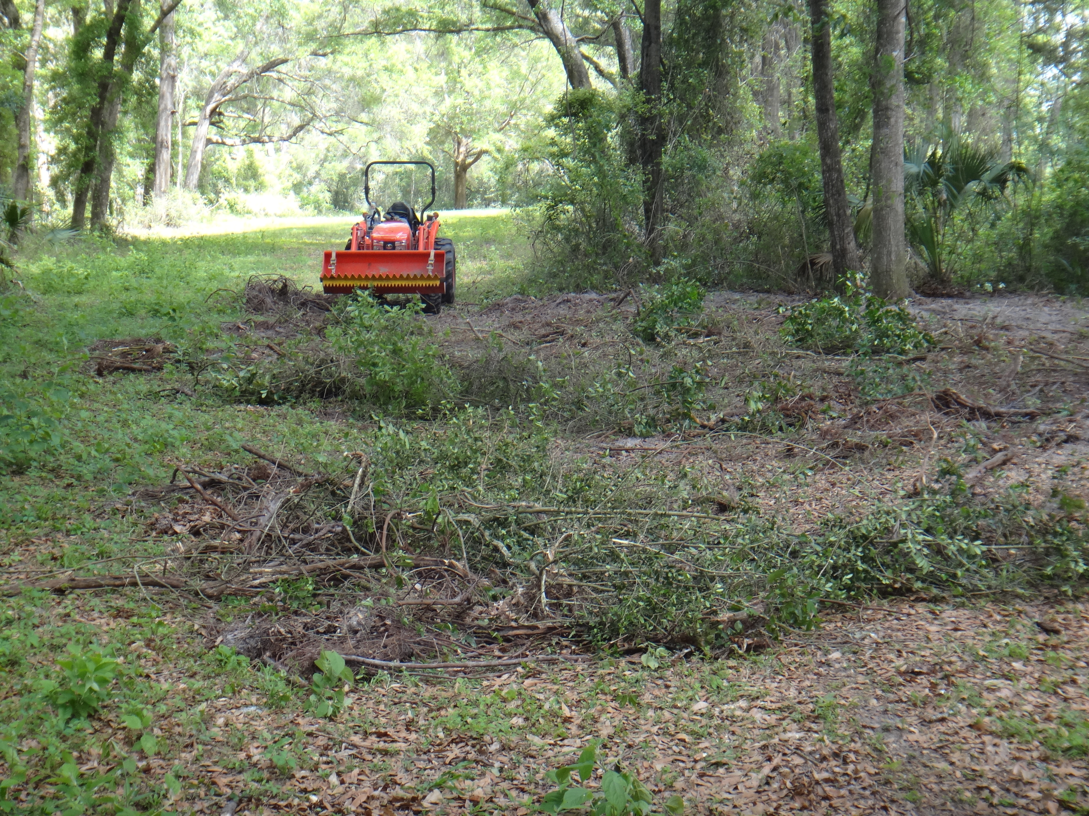

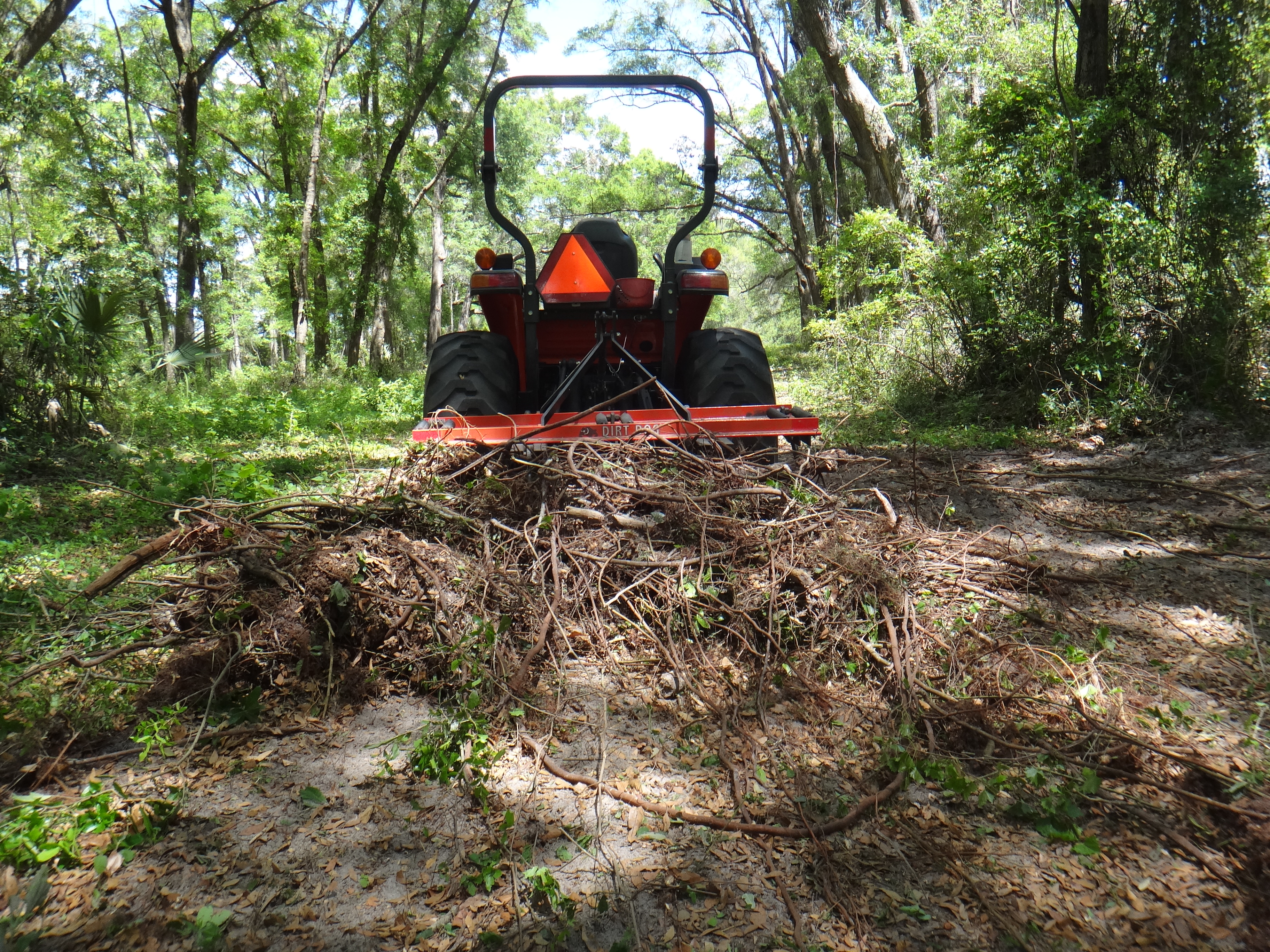

Loader capacity, the need to cut the thick, heavy grass and the need to clean the underbrush as pictured above is what has me looking at the larger tractor - even if I only use a five foot bush hog. If my thoughts are not accurate as to my needs I'd be obliged to listen to reason. I'd rather pay just a little bit more now for more power than I need than to get started and realize I don't have enough without abusing equipment.
Other than the initial purchase of a bush hog and blade I don't know what other implements I'd desire in the future. A grapple is definitely at the top of my list (my plan is to cut, sort and stack the hardwood for firewood). Also a post hole digger (this I can probably borrow from my step-dad, only requires a 500 mile round-trip to pick it up and return it). A spreader and a rotary tiller would be desirable if I get in a local hunting club and want to make food plots.
But I do keep coming back to how much is too much, or how little is too little.
