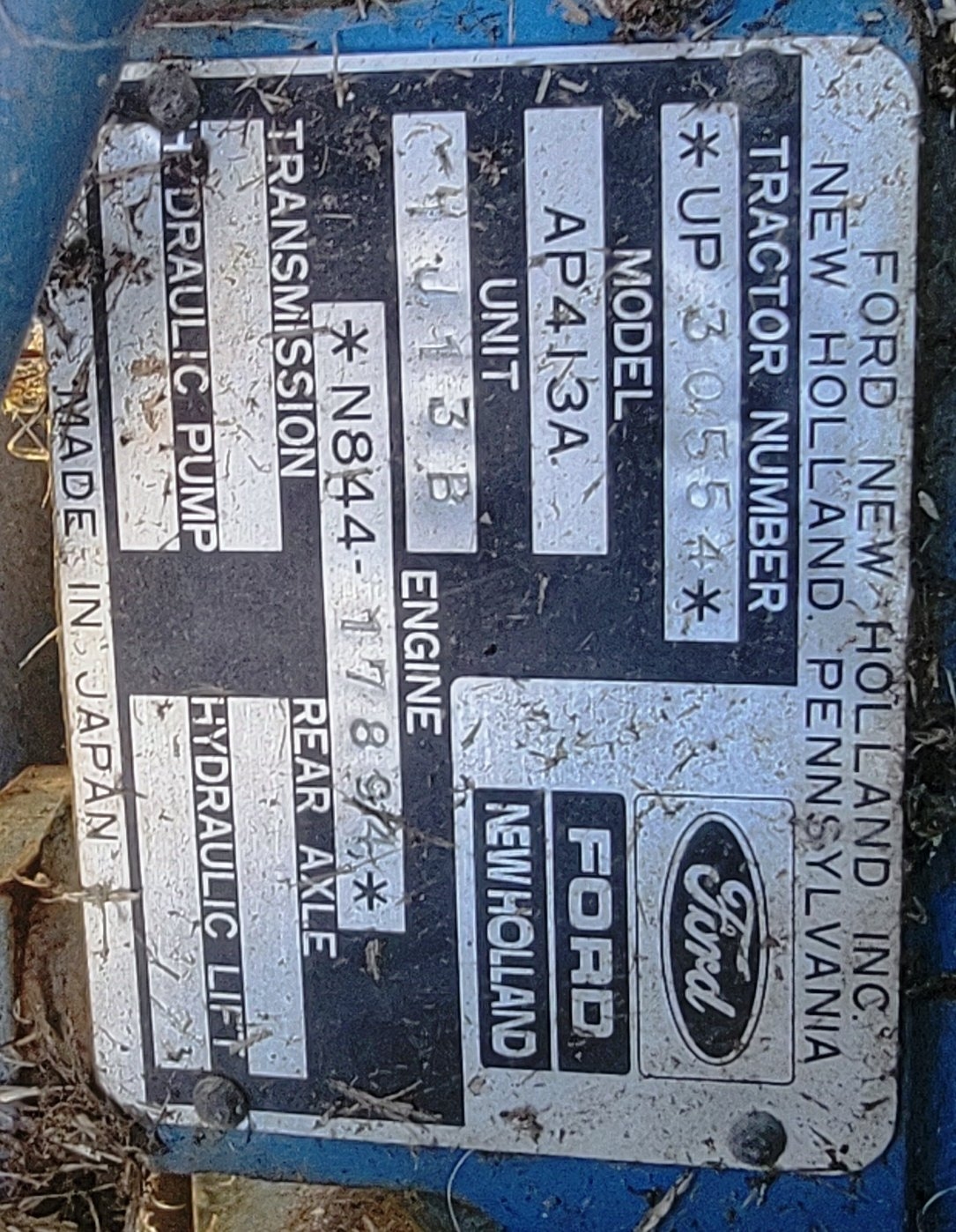

@kirkawilson
Here is a picture of the name plate, just to make sure we have the correct manual!!!
   / Hello, looking for Service & Shop Repair Manual's for a Ford New Holland: 1991 TRACTOR - UP30554, MODEL - AP413A #6
The serial number matches up with a 1991-92 number from TractorData.com Ford 1920 tractor information
If it has a loader, the clutch housing access hole is located underneath one of the loader mounting plates..can't remember which side..and you need to remove the loader to see it. You might be able to adjust the clutch through the access hole. Otherwise, the tractor must be split to replace the 2-stage clutch (1st stage for drive train, 2nd stage for PTO).
