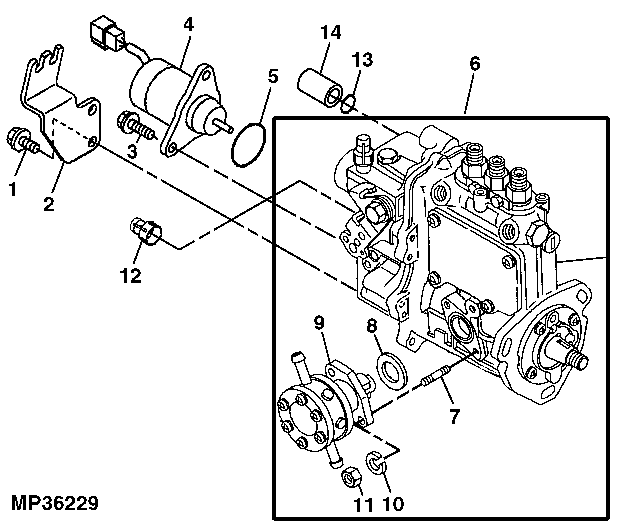

UPDATE 9-9 Checked the engine oil again today after letting it sit since Saturday and its over full again - by about 1/4" (which is ~6oz or so i think)..
I am guessing its diesel fuel - where would that come from? is that a DIY job or need to go to the dealer?
I am going to order a Blackstone Labs test kit to send a sample it..
Any thoughts?
brian
If it's diesel fuel, and it probably is based on what YelBike wrote (that the hydro pump is not attached to the engine), then the most likely source is the injection pump. Not really a DIY repair IMHO.
FUEL INJECTION PUMP
Cart key PART NO. PART NAME QTY SERIAL NO. REMARKS
1 M87825 Bolt 2 NLA; ORDER 19M7300
19M7300 Cap Screw 2 M6 X 10
2 MIU800362 Support 1
3 CH19140 Bolt 2
4 M806808 Solenoid 1
5 RG60092 O-Ring 1
6 MIA880051 Fuel Injection Pump 1 W/GOVERNOR
7 CH15396 Stud 2
8 M811963 Gasket 1
9 AM882588 Pump 1
10 12M7006 Lock Washer 2
11 14M7272 Nut 2 M6
12 MIU800110 Cap 1 SUB FOR M810479
13 CH17159 Packing 1
14 M810067 Cover 1 NLA

See if my thoughts are reasonable..
changed the oil - ran hard for 3 hrs - let the tractor set for a couple hrs checked the oil it was OK..
Let the tractor set for 48 hrs and then oil level has risen..
To me it would be reasonable that some diaphragm/seal in the fuel pump went bad and is allowing the diesel to go into the engine oil..
   / HELP - 2320 - Can hydraulics get into the engine oil? #14
That sounds reasonable to me, its a whole lot better than the IP I mentioned above!
#9 in the diagram I posted above is the pump.
#15
so would #8 be the possible leaking culprit? the part to the left of #9 is where the fuel lines come from the fuel filter i believe..

   / HELP - 2320 - Can hydraulics get into the engine oil? #18
No, #8 is only an oring that seals the transfer pump to the injection pump. If it were bad, it would only leak engine oil to the outside. #9 is the tranfer pump and the diaphragm that could leak fuel into the engine is inside of it and it is not offered as a replacement part through deere. #9 would have to be replaced as a unit. It is possible you could find a diaphragm for it, but not sure where that would be.
