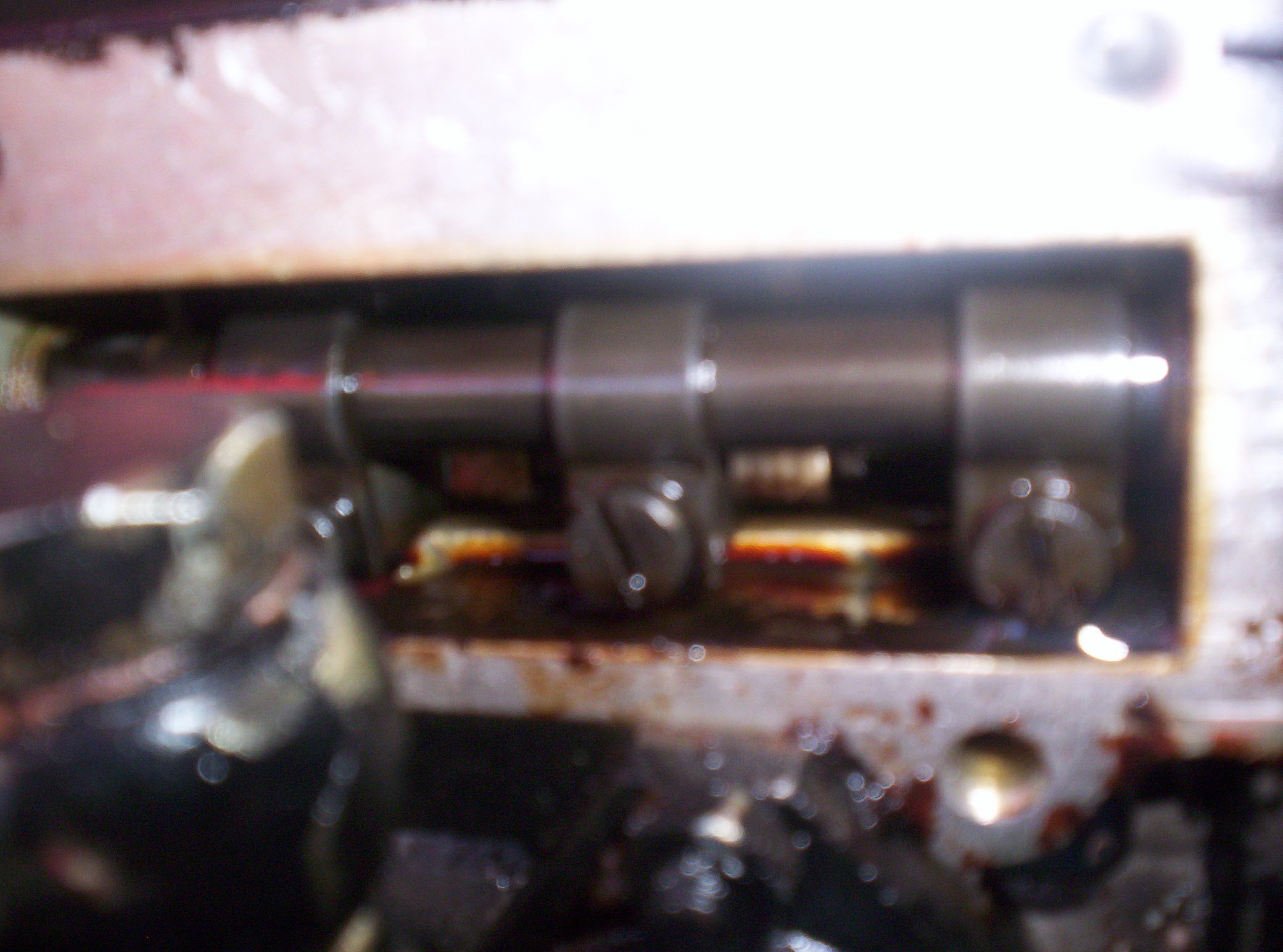

Hi,
I'm posting a pic of the rack. There is quite a bit of varnish in the housing. The rack was all the way to the rear of the tractor, I was poking and prodding and it sort of jumped forward to the position it is in now when I gave it a little pressure. It does not however, move at all when the fuel cutoff or speed control is moved.
Any ideas? I'm going to spray it down with solvent to clean it. SHould it move freely back and forth?
If the governor changes the fuel to "full on" when the engine is off, then moving my throttle lever isn't going to do anything unless the engine is running, correct?
Thanks,
Darwin

OK, I think I'm talking to myself here but here goes:
I was able to free up the rack, I cleaned the gunk off the shaft with some PB blaster and it now moves back and forth easily, either with my fingers or the cutoff lever. I'm operating with the idea that the throttle is inoperable until the engine runs and the governor "tells" the shaft to close it down to the stop point that the lever is set to. Soo, everything seems to be working right. I am going to button it back up, fill the pump with diesel, bleed the lines and see if it will start. If it does I'll bleed out the diesel and re-fill it with oil.

Well, thanks to all the help I rec'd I am back in business. Here is what happened:
Accumulated gunk in the IP caused the rack to stick. When I started it, the governor couldn't overcome the resistance and the throttle was stuck open. My panic shutdown merely caused the rack to jam at the opposite end, thereby depriving the engine of fuel.
Freeing the rack and cleaning it allowed it move freely, in fact more freely than it ever has if the lowered resistance to throttle movement is any indication.
I have a combination of diesel and motor oil in it now. I ran it for about 45 minutes and will now change to regular motor oil. That will be changed again shortly.
