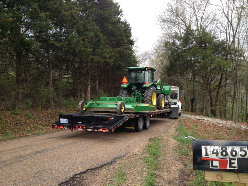

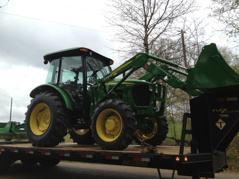

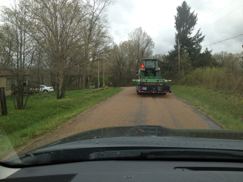

The dealer may be resisting the wider wheel width because his trailer is not wide enough to transport. I ran into this exact situation a few years ago when buying a new tractor. The dealer set the wheels in the widest position and when the service/delivery guy couldn't get it on the trailer because the trailer wasn't wide enough they called me. It would've been a problem any time the tractor had to be transported for repair/service so I gave in and said just go to the next setting which resolved the issue.
That's a possibility... although, a 5083e is a big enough load that trailers with sufficient capacity are usually deck-over trailers without fender wells to deal with. And, the decks are usually 102" at least.
AKfish
Yep. 😉

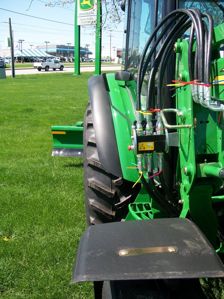

If you want to run the edge of the rear wheels outside of the fender - your dealer should just go with it - not his call! Heck, if he was thinkin' ahead a bit - he might be able to interest you in those fancy, black fender extensions! :thumbsup:
AKfish
I think he was just trying to be helpful. You never know what you'll like till you try it. Are the fender extensions pretty easy break. Seems like they'd be just hanging out there but I guess no more so than the fenders themselves are now.
   / Help! 3 problems and just 11 hours in. Warranty? Insurance? Me? #24
Well... you can break anything if you really work at it!! I was worried that with cold temps and tree branches whackin' 'em they'd crack, etc. but they've been holding up for 2 winters just fine. I've got my 16.9-30's set as far out as they'll go without wheel spacers.
Those extensions have taken some pretty good smacks and no problems. Mud is all on them, too - not on my cab!

Mine are in their second year also, they're pretty resilient. Poor fit at the bottom, leaving an annoying gap between the extension and the fender that would regularly catch grass and brush. I resolved that by employing a pair of sturdy hitch pin clips (as clamps) to close the gap.
