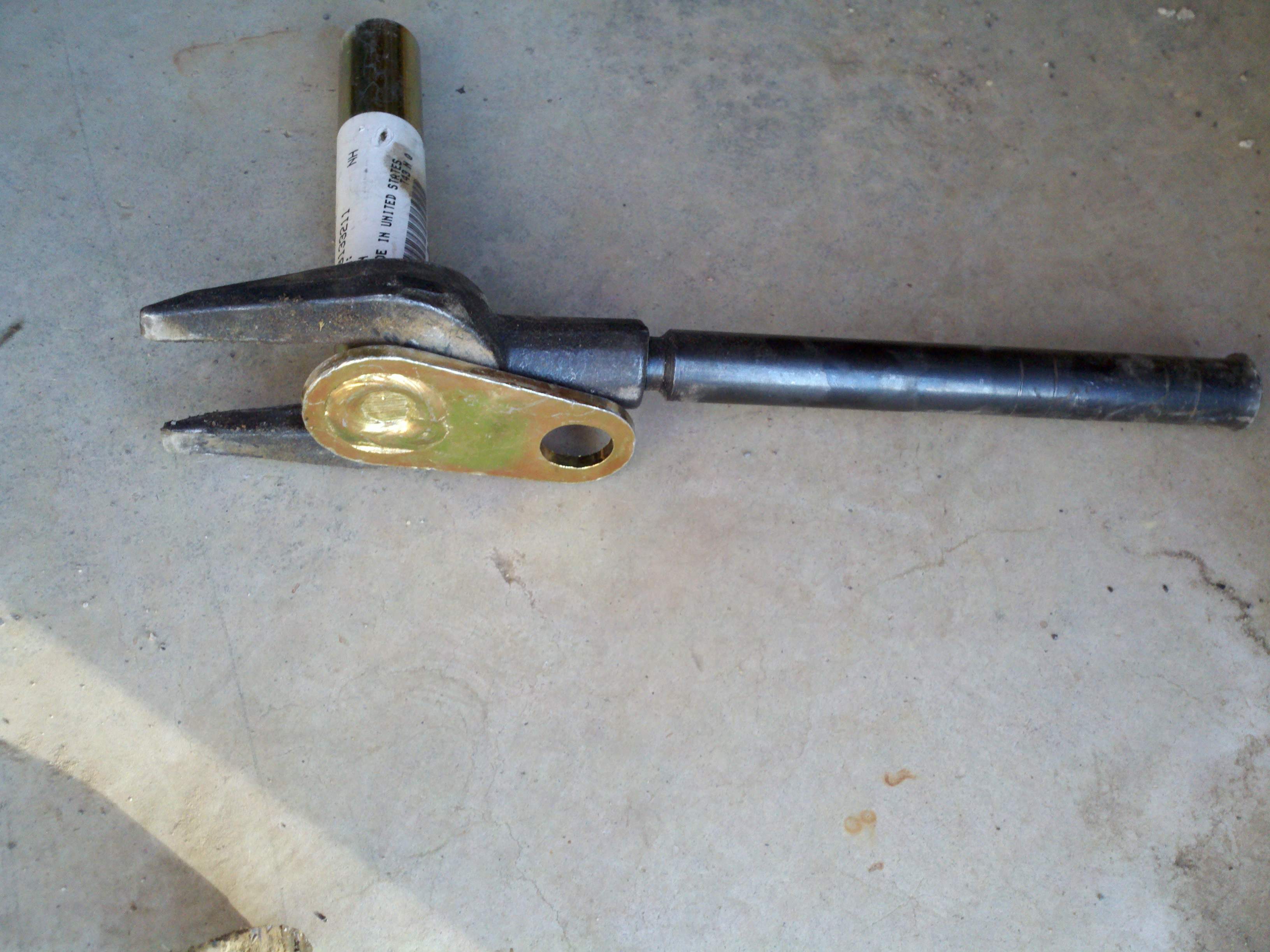

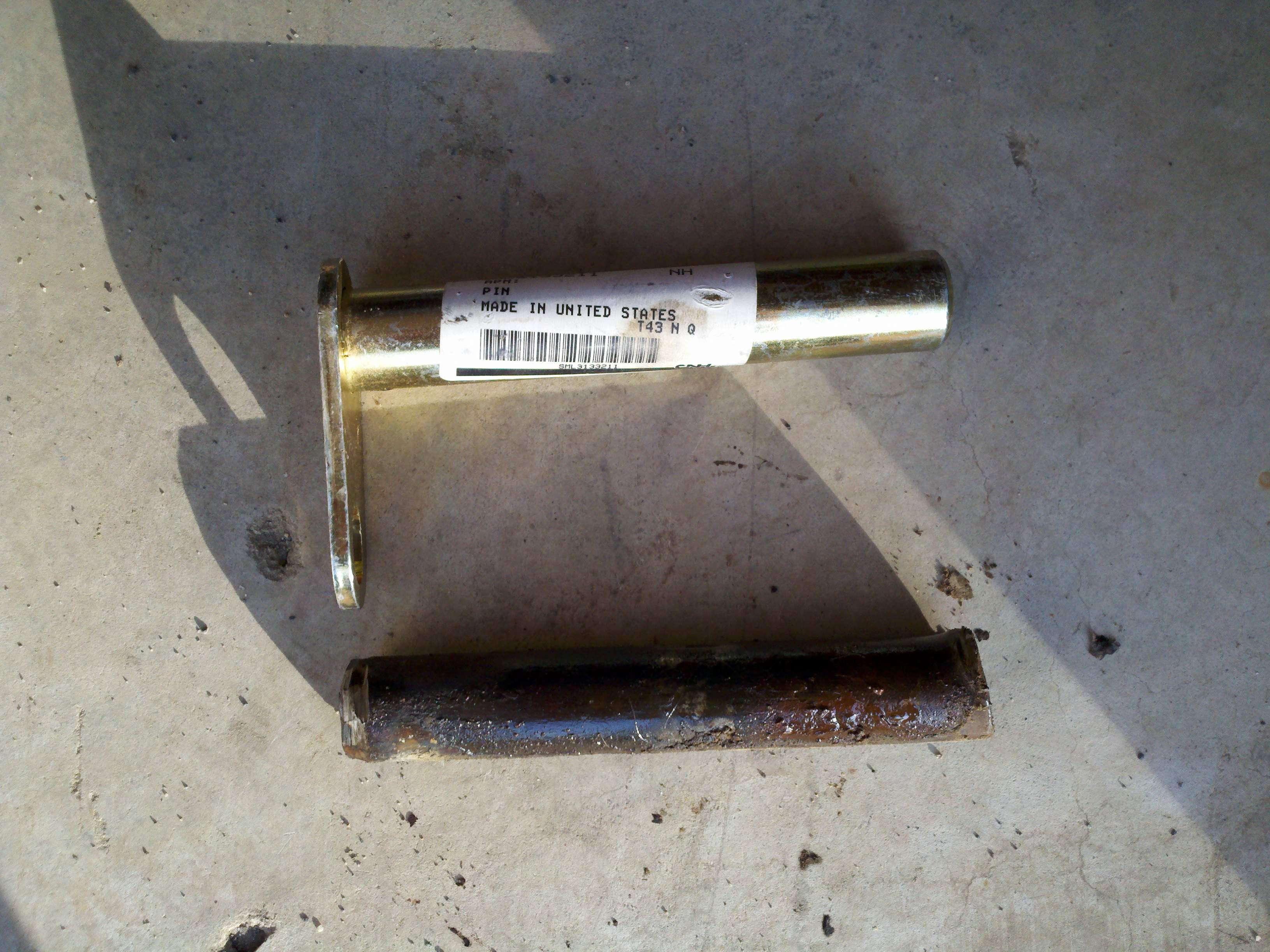

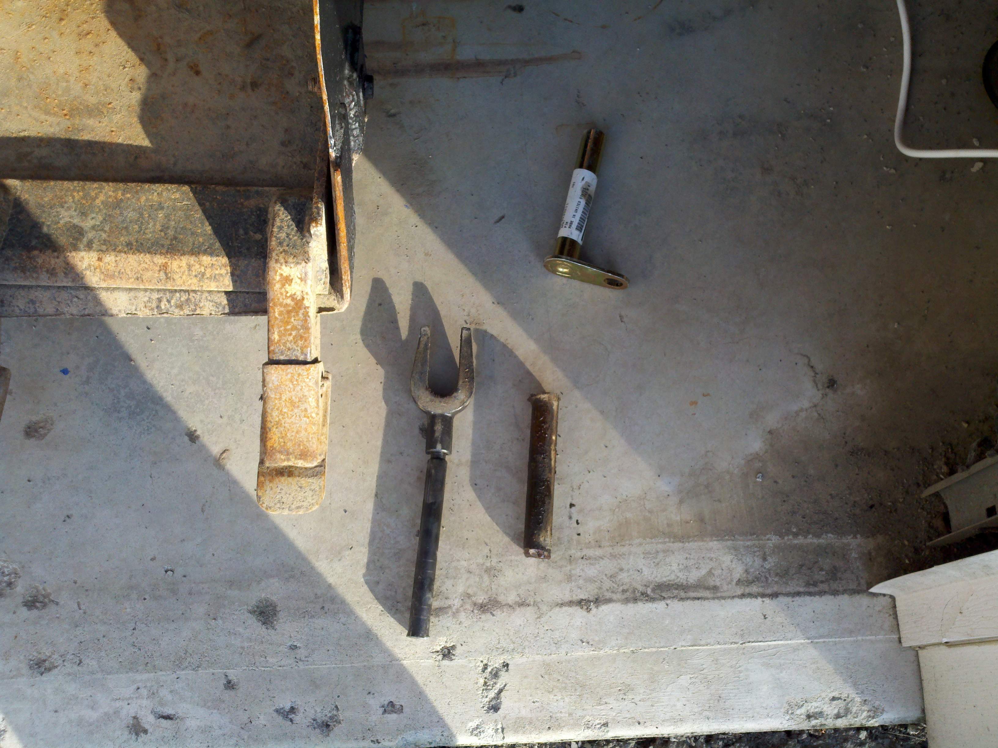

Jason,
One out!!
After reading your suggestion about getting a good swing at it --I starting thinking that wasn稚
possible so I went and bought a fork(pic) started whacking that and the tab started to break off with the tab off I used the grinder to get that round appearance.
With the vise grip holding the punch in one hand and the other with my smaller heavy hammer in the other I started whaling on it stopping to spray with penetrating fluid then whacking it back and forth When it got past the frame it was all over.
I guess the fork really loosen it up so breaking the tab I was able to work at ease from the front of the BH.
First picture old pin with new
Second Picture--fork I pick up for $20.00 well worth it
One more to go.
Thanks for your help.
John

   / Help 757C anti rotation bolt stuck #13
John, Glad your getting it:thumbsup: Pretty satisfying feeling isnt it?:D
Now imagine doing that a few times a week on 2"+ pins ;)
Keep at it. Lube your new pin before putting it in, and watch that your bores are lined up. Dont want any burrs on the pin or the bore.
   / Help 757C anti rotation bolt stuck #14
Ahh, yes, the old ball joint (pickle fork) removal tool strikes again!
Good idea to try that, they can put a lot of wedge pressure on a joint like that..:thumbsup:
