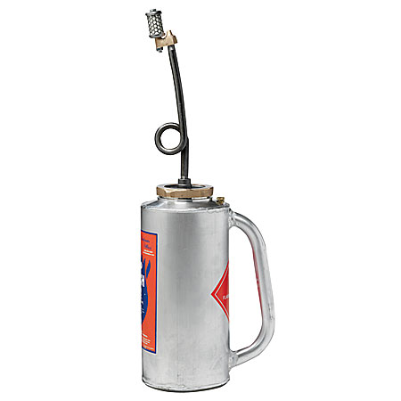

The only logical solution for the mad brush burners is the "DRIP TORCH" and it has been used for years by the United Sates Forest Service with great success and control for back fires.
The drip torch uses diesel fuel or K-1 kerosene, the drip torch has a flame stop loop which prevents fire from entering the drip torch when in use as it uses a fibreglass wick.
A drip torch is very safe way to light a brush pile as the amount of fuel available is limited by the wick and the flame proof loop which prevents fire getting into the reservoir of the drip torch making it very safe to use.
