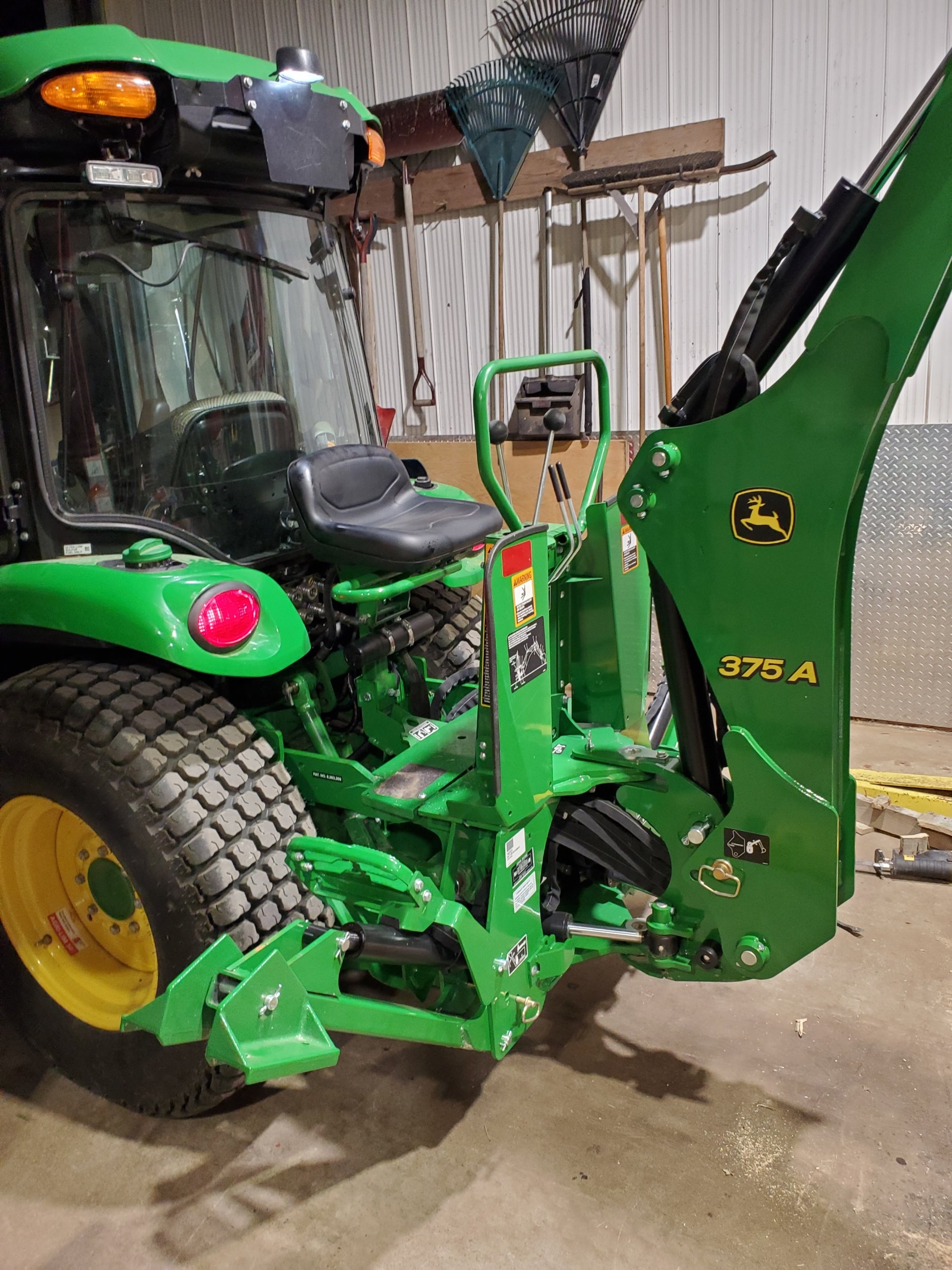

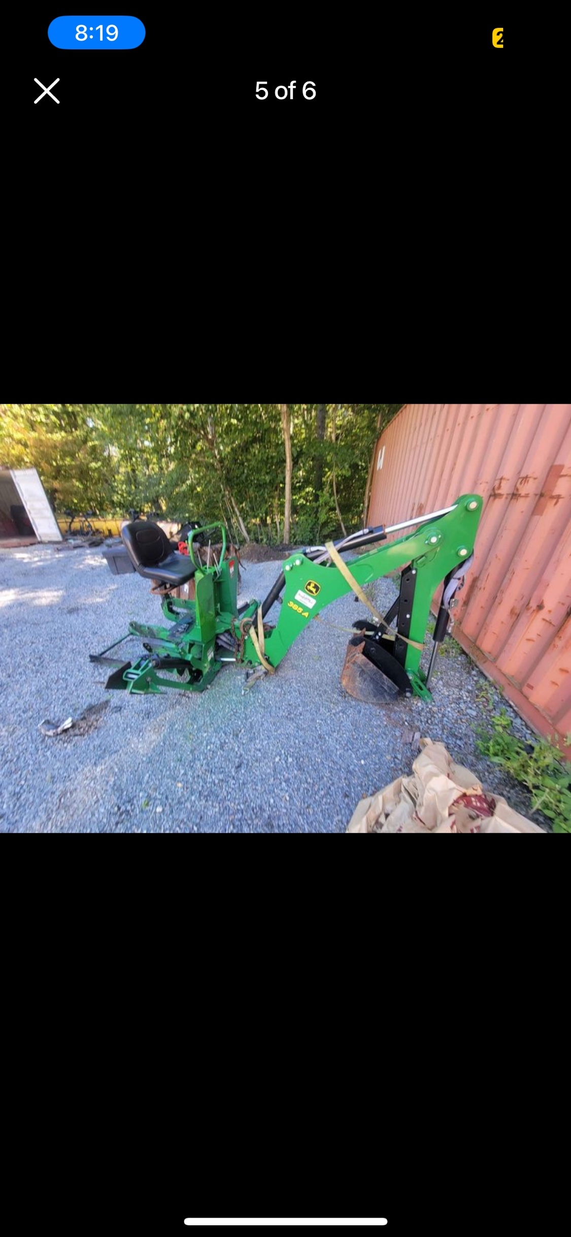

So I was reading online and I just saw after ordering all my brackets that a 385A does not work on a cab tractor can anyone confirm this the brackets said cab tractor.
   / HELP AGAIN !!! John Deere 3033r cab with 385A backhoe #2
When I was trying to get a backhoe for my 3 series cab I wanted the 385a but I was told its not for cab tractors. Well through my research I could only find out the difference from a 375a was how far back it is from the rear of the tractor. I really wanted to try a 385a but that's almost impossible unless you know someone with one to try. After self installing my 375a I would think the 2 side plates would be the same but I also needed a separate parts box to move and relocate (barke linkage, range selector and parking brake pieces) I ended up using 1 little part from that box as it is for a few tractors models and years. You will need the crossbar that goes between the 3 point arms which is used to lift the hoe into position to install the 2 pins. The 385a hangs further back away from the tires then the 375a but I would love to know if it works on a cab tractor? Look for side pics of the the 2 and you can see the setback from the rear tires.

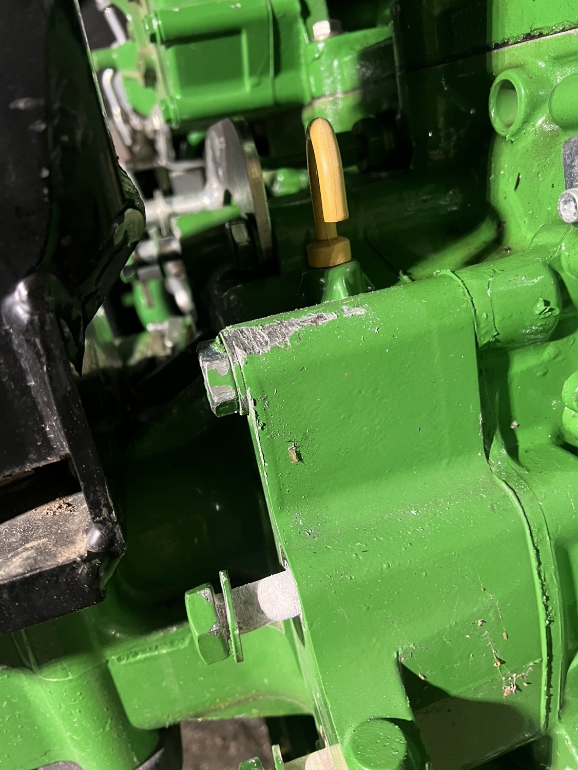

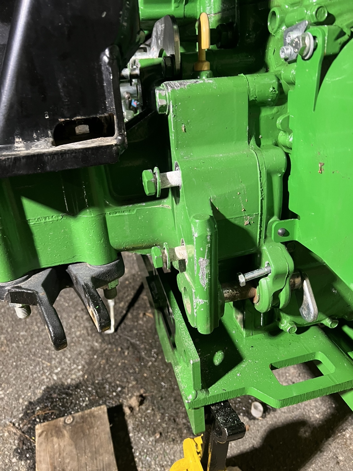

We’ll see how it goes hopefully it works. The brackets came in yesterday so I will try to install them this week. Do you have any pointers on putting the brackets on?
   / HELP AGAIN !!! John Deere 3033r cab with 385A backhoe #4
From the driver's seat, with both rear wheels removed right side was very easy. The left side was more involved and hard to get into position. Leave yourself some time and don't rush. I was trying to use all of the parts from the small parts box which was confusing untill I realised I did not need most of them for my 2021 year tractor. I was making mine fit with 6 rear remotes installed and it all work out great. What actual year is your tractor?

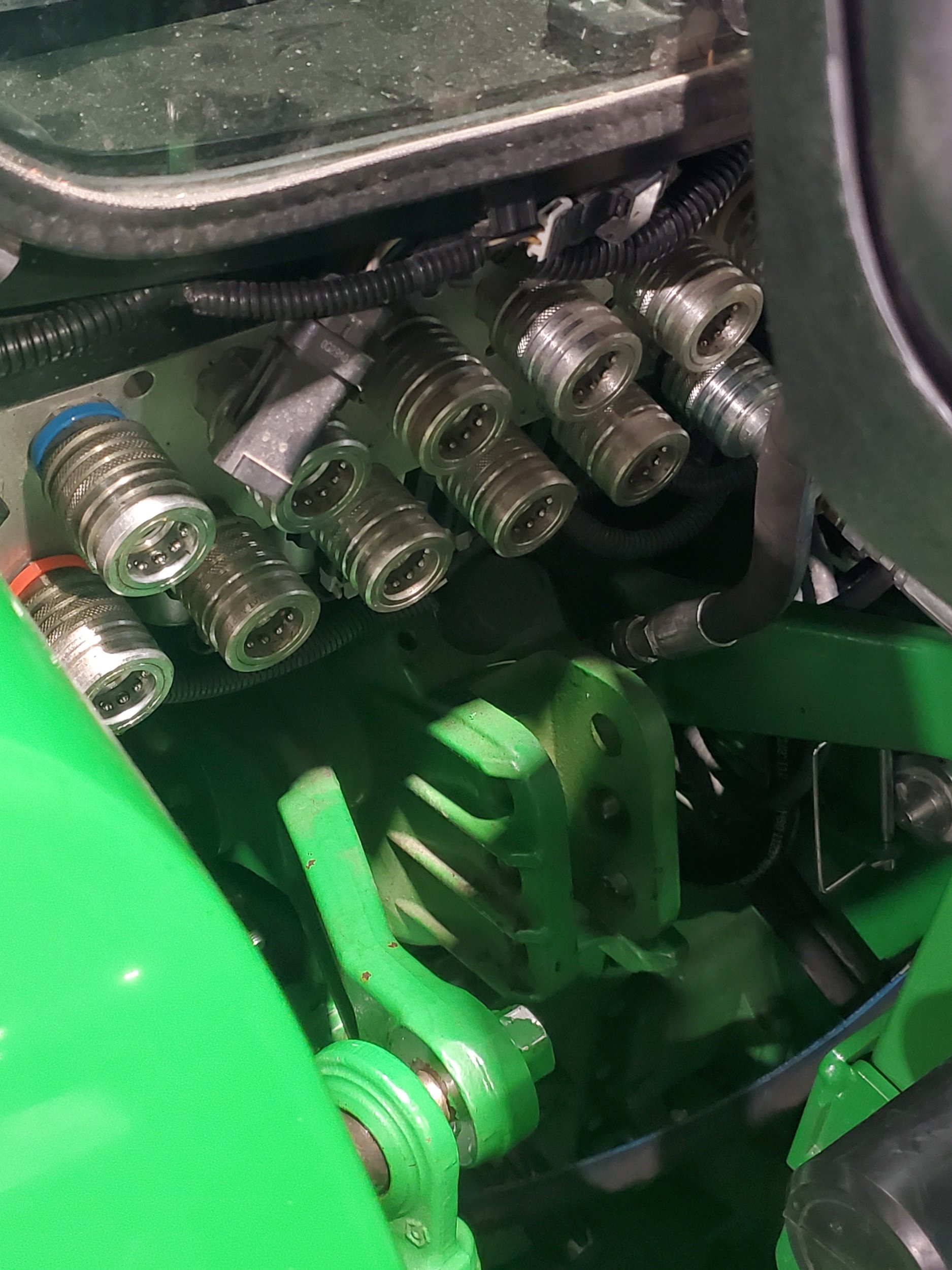

6 sets of remotes? Ever have them all plugged in?
   / HELP AGAIN !!! John Deere 3033r cab with 385A backhoe #7
Just needed 5 but figured I should have 1 extra. 1 for loader 3rd. Fuction, 2 for top and tilt, 2 for snow blower shoot rotation and deflector.

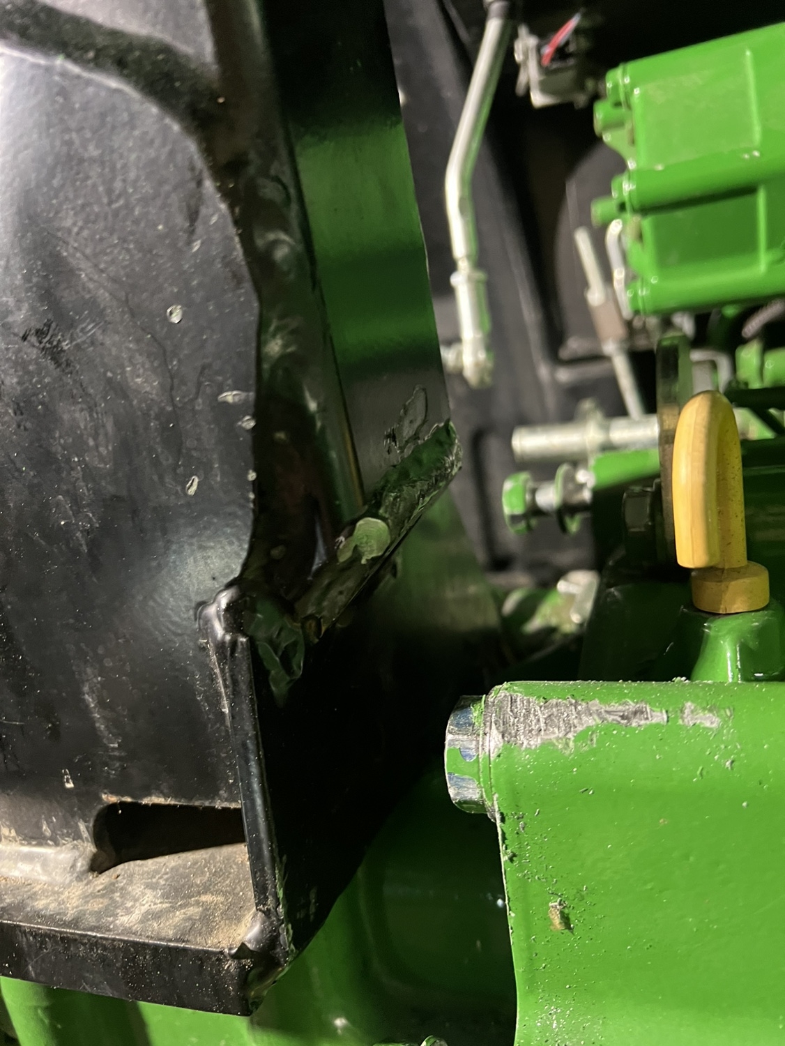

Maybe you can help me I can’t get the left side bracket on I struggled so much I was slamming it with a hammer and can’t get it wrapped around to bolt on any tips I’m so lost
