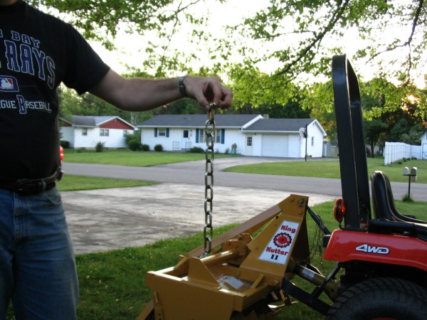

Andybody know where this chain is supposed to go? The manual says nothing. It was wrapped around the PTO when I bought it, so I figure it is just to hold the PTO on the unit when in storage, but not sure. The one on the back drop gate is in place so it's not that one.
I don't want to miss something before running it. And I am ready to run it now /forums/images/graemlins/grin.gif

The chains are to keep the pto safety shield from spinning with
the shaft. You just hook them on wherever it's convenient to
something that does not spin. /forums/images/graemlins/grin.gif Make sure you pump some
grease into the safety shield nipples first so it's not running dry.
There should be a small chain on each half of the safety shield.

oops, I didn't notice the attachment. No, if it's not the one on
the rear flap, I'd say you got some extra parts.

Thanks Mike, I wasn't sure about it, but I just tilled the garden and lost one of the clevis pins for the one on the back flap so I guess the extra chain and clevis will come in handy.
I'm glad you mentioned the grease on the shields as I didn't do that. Nothing that I saw in the manual about that either. I saw the plastic fitting that looked like zerks, but just thought humm wonder why they did that and moved on /forums/images/graemlins/blush.gif
Guess I'll grease them now.
