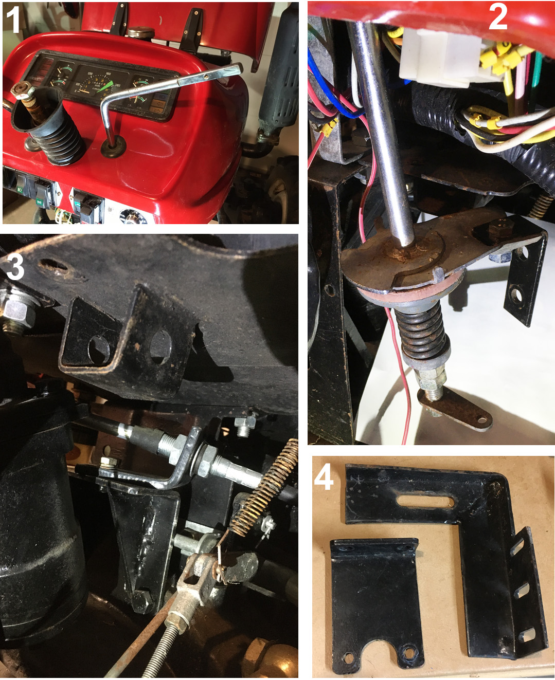

Andy, the linkage that goes from the throttle shaft goes straight forward and angles slightly left. There is a slotted bracket with about a 1-1/2" slot that it attaches to (just above where the foot throttle attaches) The other end (by the steering column) attaches to a hole in a flat bracket that moves when you move the hand throttle. Let me know if this isn't what you're looking for and I'll go look again. Been playing with mine and I really like it. The shuttle shift has limbered up with use.

Hi Bill, and thanks. I've printed out your post, I'll take it with me to the workshop tomorrow, but I'm sure the slotted bracket is missing from my tractor. Please have a look at the excellent photos RickO attached to his posts. Your set up is not like this is it? I'm really looking forward to using my tractor, but I'm going to do all the modifications I've learned about on this site before I start. With any luck that will be next week, if Hubei export send my missing hoe pump. All the best, Andy

Andy, our slotted bracket looks just like Rick's but I think the linkage might be a little different. Very close though.

Hello all. I'm having the same problem trying to install the hand throttle on my 2006 Jinma 284 (yeah, I never finished putting it together; its a long story). I can't figure how to anchor the hand throttle to the tractor. My photo #1 shows the hand throttle. Photo #2 shows a black 90 degree angle bracket that perfectly fits onto the hand throttle (it even has an offset hole that perfectly matches), so I assume that part is needed. Photo #3 shows a bracket that hangs down under the dash that I think the hand throttle should bolt to somehow. Photo #4 shows a couple of brackets that I haven't used yet. The bracket on the right may be the connecting part I need but I can't see how it could fit between the hand throttle and the bracket that hangs down under the dash. Does anyone have this same hand throttle that can show me how yours was connected? Thanks much! Dick Wood, Juneau, Alaska Jinma284HandThrottle.jpg
