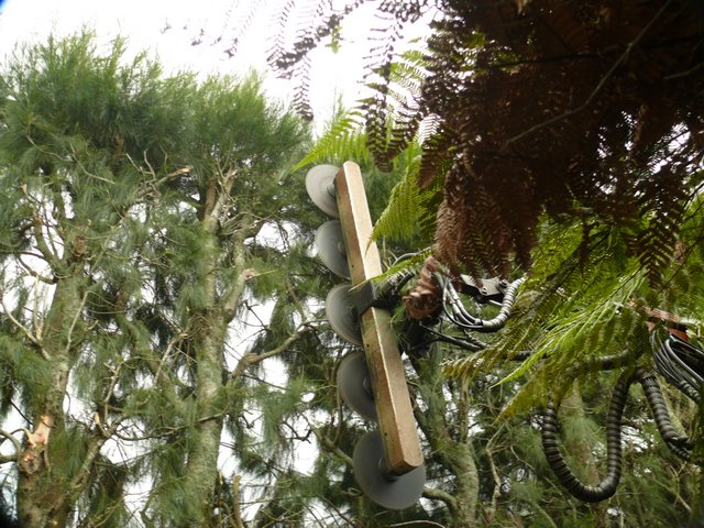

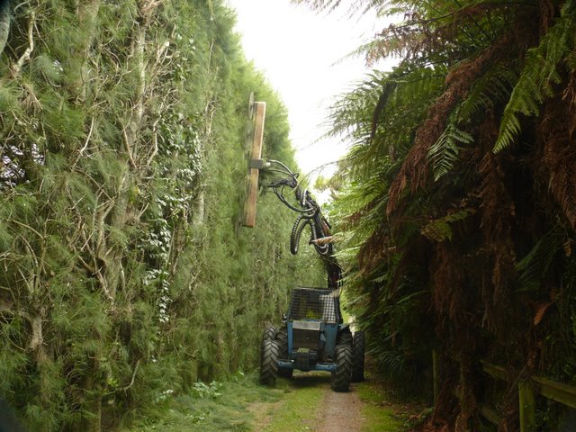

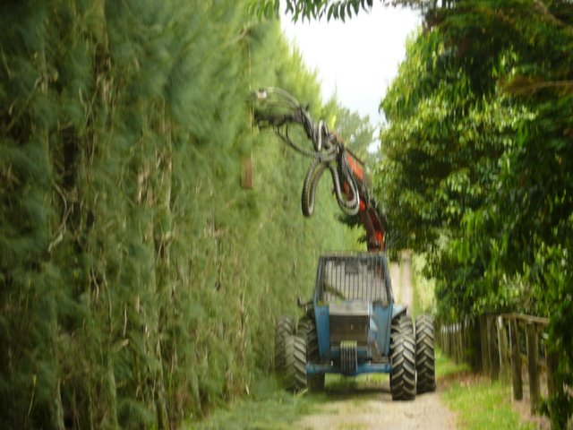

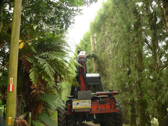

We have a miles and miles of shelterbelts, mostly Cryptimeria (sp) around the Kiwifruit and they need trimming every year. The blades total about 12' and they take a second sweep to 24' then turn the cutting head horizontal and top them. I've no idea of the mechanicals.

That thing looks like a scorpion with a huge stinger.

No. There are a couple of them in the district built and operated by local contractors. Friday was the day they did my neighbours place which happens to be my front drive. That one is built on an old Fordson very heavily reinforced. Armoured glass all round. It has done some very long, hard hours.
