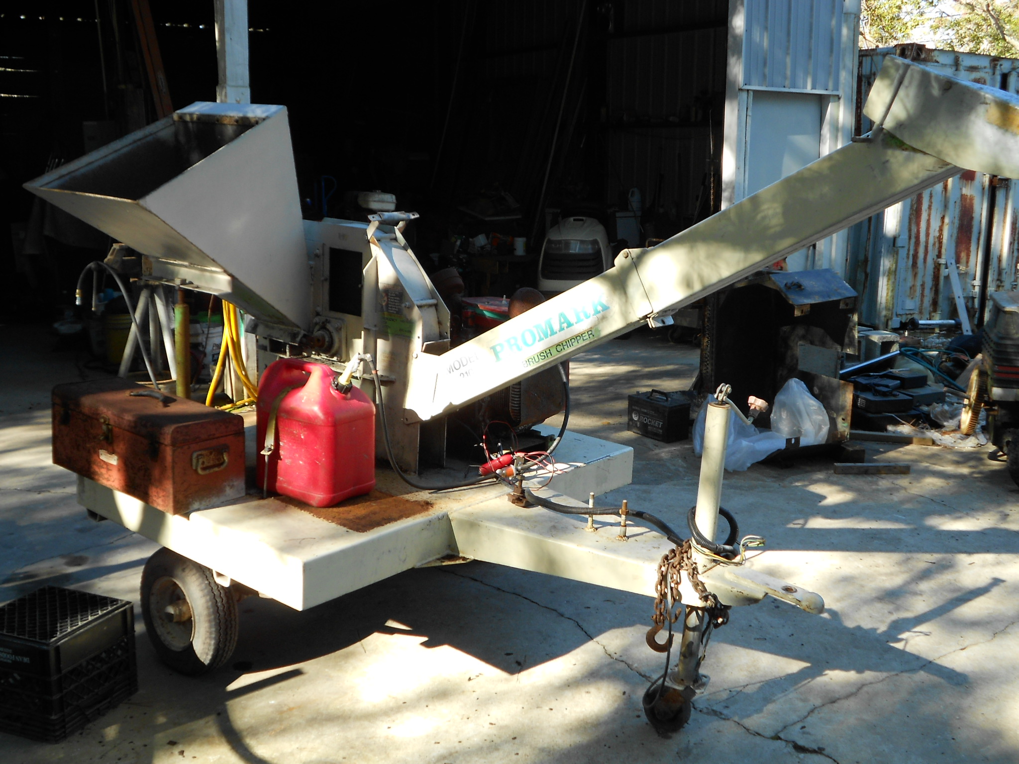

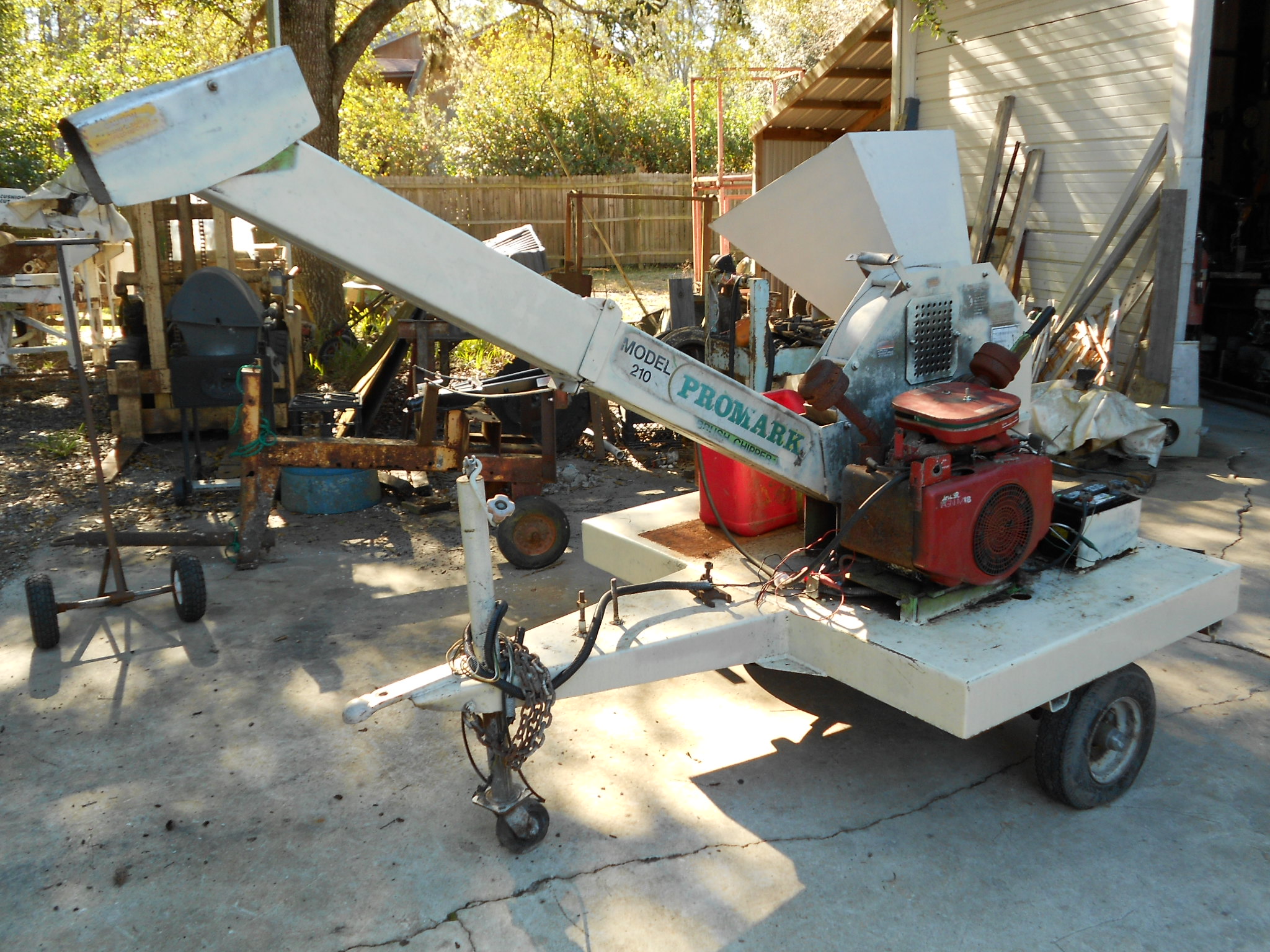

I bought the ProMark pictured about a year ago and had to rehab things but now it works great!!
I looked at a Vermeer 6" today that is for sale locally but it is in poor condition and needs a LOT of work.
