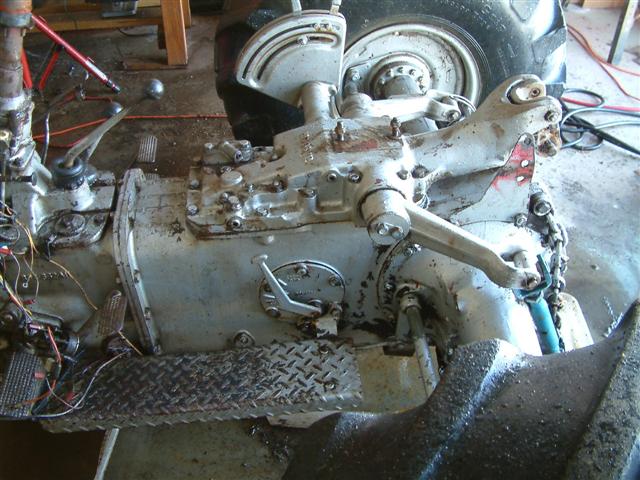

My 1964 MF135 diesel has the 2-stage clutch (live pto) and multipower.
This photo shows the pto selector on the side of the tranny case (OFF, ENGINE SPEED PTO, GROUND SPEED PTO). You operate it with your left hand.

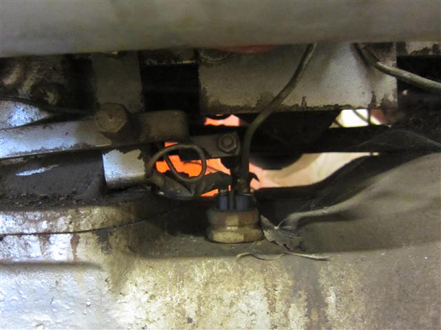

If that 135 you're eyeballing has MP, there will be a switch on top of the tranny case under the battery tray. Look between the top of the air filter housing and the bottom of the battery tray--that's what this photo shows.
The large thing closest to the camera with the hex nut shape is the tranny neutral interlock switch. Behind it in the top of the tranny case is the control switch for the MP. It's connected to the lever on the dashboard via the linkage shown in the photo. Look for this MP control switch.
