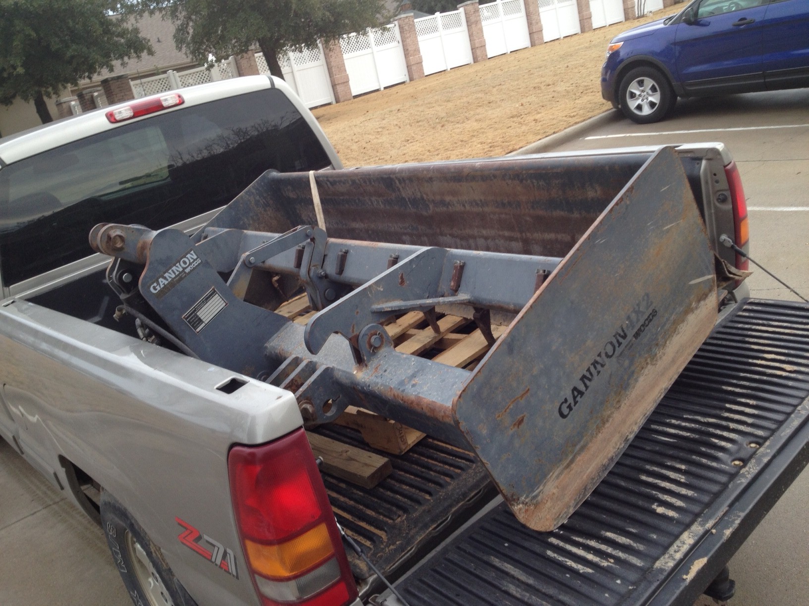

Picked up a used Gannon 78HB with hydraulic scarfers. :thumbsup:
Need to find a replacement Cat 2 Lower link pin and can't seem to find any. Need Cat 2 without threads, just a pin.
Anyone seen them around?

Tisco P7236 through some dealers or online at Glemco online or A&I Products A-LP21, same as P7236 or A-LP20 9" useable length. All Cat 2 pins for this purpose.

The simple way to do it is just buy a straight 1 1/8" hitch pin such as any tractor supply or dealer will carry. just pin the two outside clevis plates together which requires just over 4" length plus room for a clip. Tractor Supply stocks them in a longer length which will work fine too.
