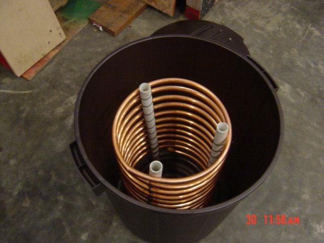

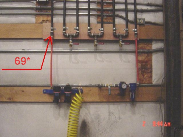

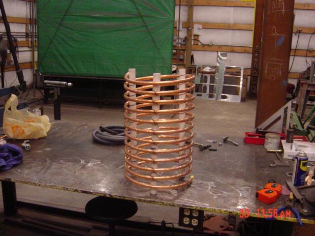

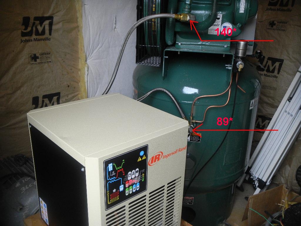

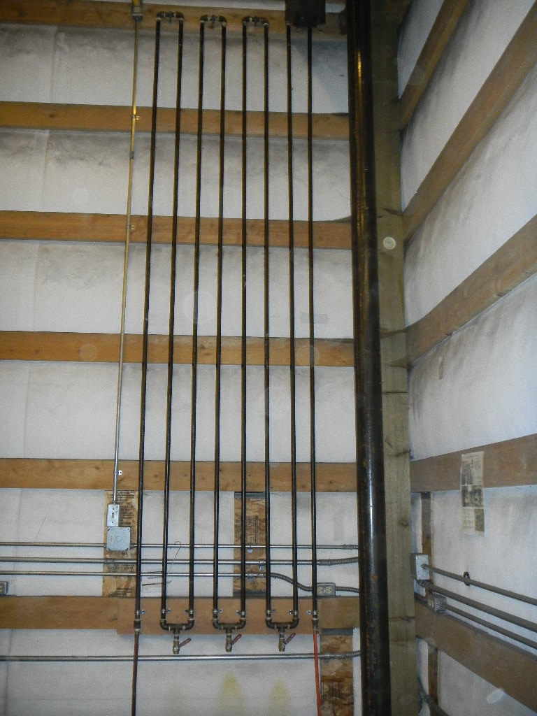

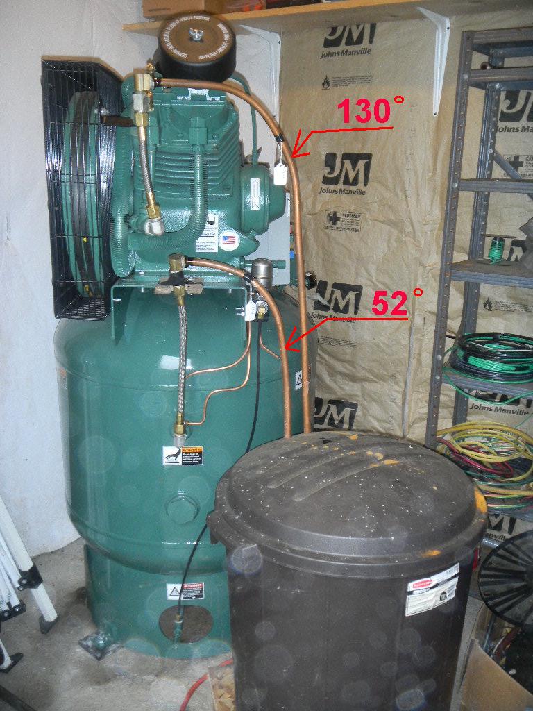

You can always build an intercooler, and after cooler. I built one, after years of use it developed a leak. So I bought a refrigerator cooler. Believe it or not the garbage can of water cooled the air more than the refrigerator.:rolleyes:
