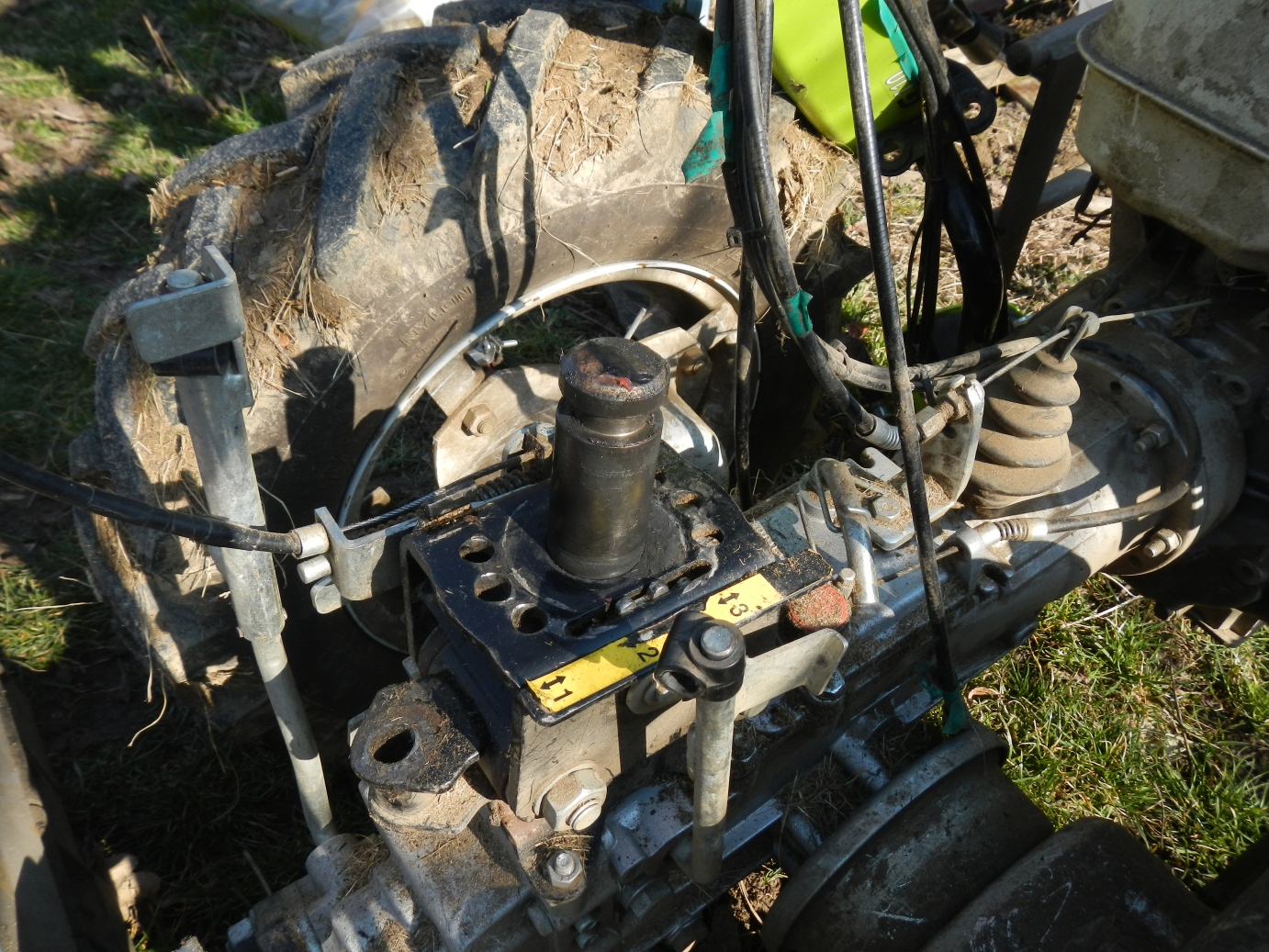

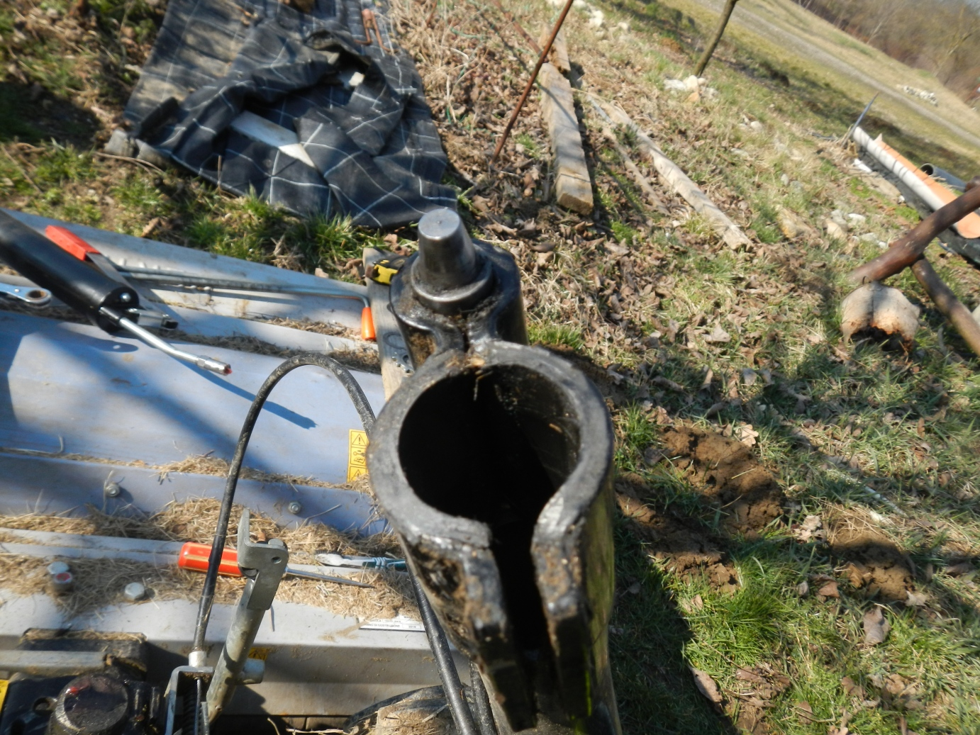

Hello everybody!
I want to ask a piece of advice regarding an issue i have with the handlebar i have on my Grillo G110... As you can see in the photos + video below, it has a lot of slack where the handlebar connects with the bracket that holds it... I'm afraid it might break...
What would you suggest? (Except changing the whole thing :D )
Thank you very much!
Anastasie
PS: my machine is out of warranty and i bought it online... so i don't have a repair shop nearby that is specialised in these machines..........

   / [Help] Grillo G110 handlebar problem #4
You are most welcome Anastasie,
Judging by the You Tube Video you have uploaded here your beautiful Grillo 2 wheel tractor has seen many row miles of tilling and mowing.
You need a bushing/sleeve whether it is made from steel or bronze to take up the space between the outside diameter of the mounting stub and the collar portion of the handle bars and that would help you.
If you own a micrometer you can obtain the Inside Diameter of the tiller handles tube and the outside diameter of the tiller handle mounting stub base record the measurements and take the handle bar to a machine shop in your area to have them make a bushing
for it.
To be prepared for this you need to have the height measurements of the mounting stub below the machined groove and as well as the
correct assembly height of the spline/star washer and flat washer in relation to the mounting stub and the Grillo 2 wheel tractor handlebar.
If you have a machine shop nearby you should take the tiller handle bar to it to have them double check your measurements make sure you have the right size sleeve machined for it If employing a sleeve top take up the worn space is possible and in so doing you will have the tolerances closed and have a much stronger handlebar mounting on your Beautiful Grillo 2 wheel tractor.
I am sure that Joel will be happy to help you with your beautiful 2 wheel Grillo Tractor and its repair and send you a copy of the Owners manual and a repair manual for your Beautiful Grillo 2 wheel tractor as well.
Greetings!
A short update on my issue with the tractor (maybe this info will help someone in the future):
A friend of mine, an locomotive mecanic looked at the machine and discovered that the thick metal pin that holds the handle bar had the welding broken. It was detached from the housing... so he welded it back and its ok now.
