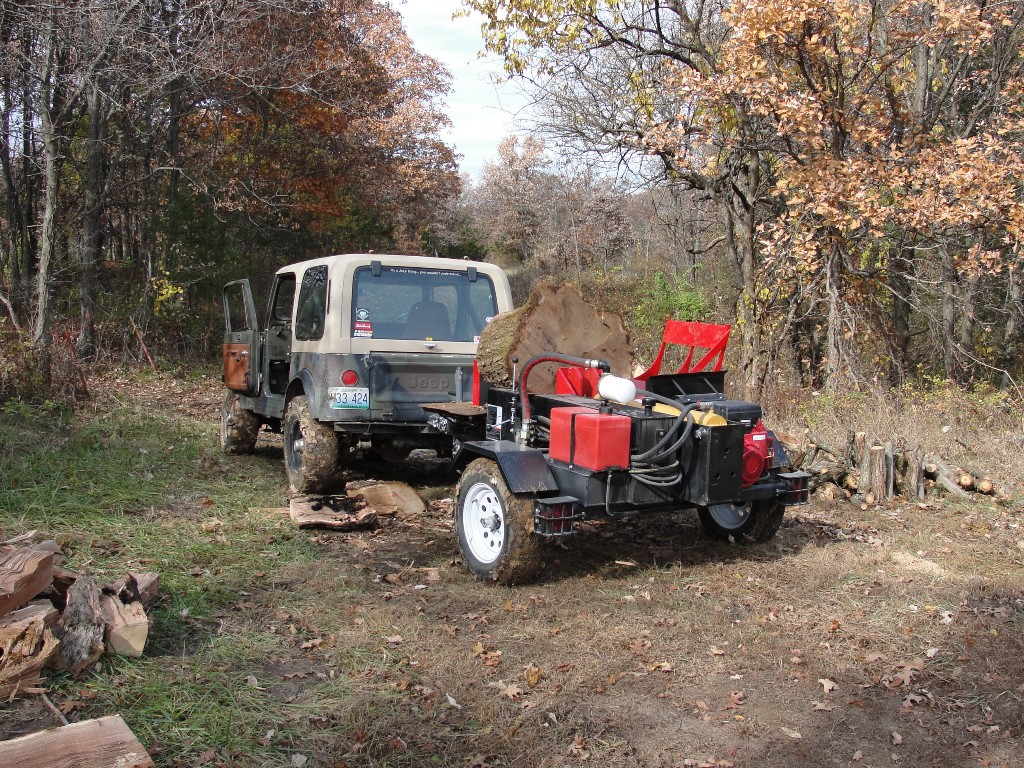

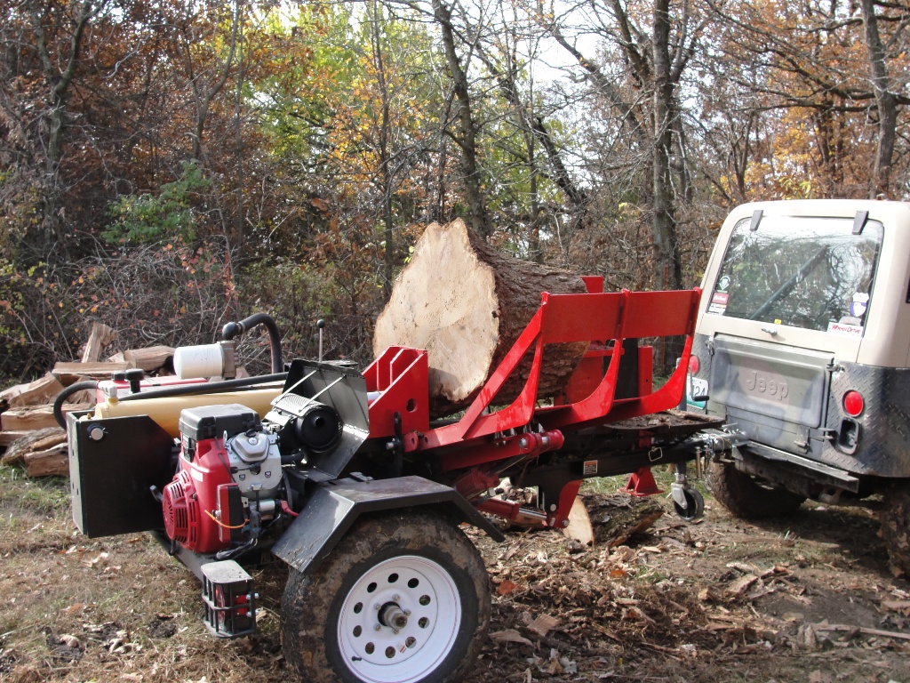

After seeing all these fine looking machines I probably should not show mine it is about 25 years old and been through alot. oh well here it is any way.

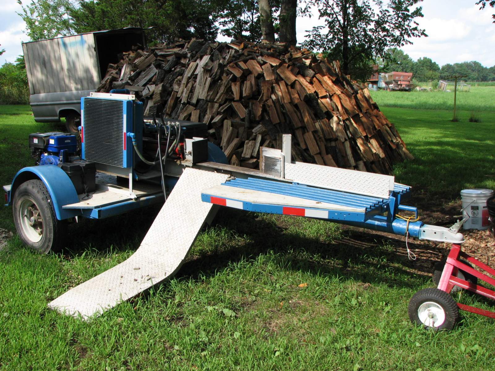

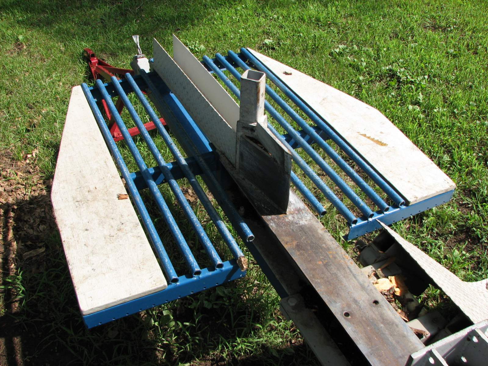

kind of off track, but... for any of us without a log lift on our splitter, we do need a way to get the heavy rounds to the wedge. since i use a 3 point splitter, i opted to make my beam fixed, and i just lower the three point to ground level and roll on the real heavy rounds to break them into manageable pieces, then pull the hitch back to height.. i decided that would be easier than a vertical option. the construction isn't much different, but fixed wedge is a little simpler to build.
Yep, that's how I used my horizontal 3pt splitter as well. :thumbsup:

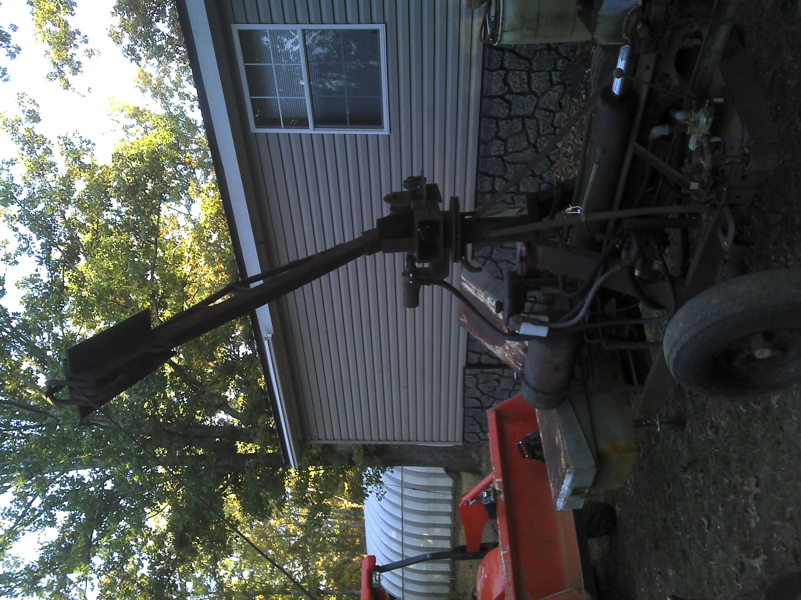

My neighbor had a knotty 54 inch spruce tree taken down that was threatening his house. I bucked it for him and we moved the rounds into his yard (one at a time in the bucket). I doubt I would have liked lifting those rounds up over my body to get them onto a horizontal splitter. We laid them out like so many tiddlywinks, put my splitter into the upright position, and I would drive the splitter foot (a railroad tie iron) under the rounds in place and we busted all those rounds on the ground. I built my splitter to mount on the end of the box blade. So, even if I can't move the round, I can move the splitter instead. The round in the picture is only about 28 inches. But many of the bigger rounds I deal with here are not round like wheels and can be pretty lumpy as well. They would be difficult to get in place with a lift. My splitter is balanced such that even with my light wimpy old body I can tip it either way. Anyway, this setup has worked out very well for me.
Once that round was quartered, the pieces were easy to lift for horizontal operation.
Yep, I totally understand and like your setup. But a properly built lift and catch table works very well too.
Looks like a great splitter to me!!!! Best part is the hammock is nearby for a much needed break!!!! :thumbsup:
/ Help! homebuilt log splitter #25
I will add this, your wedge needs to have a MUCH sharper angle on the cutting edge.
